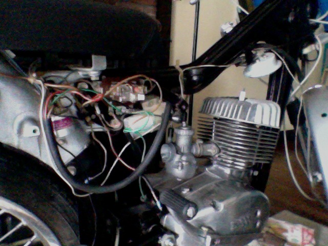

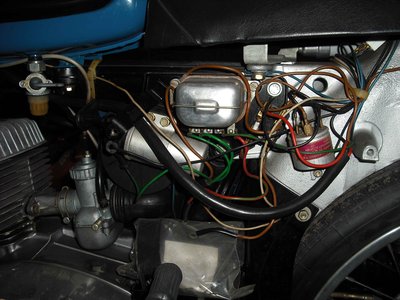

hey metric did you ever get a chance to take those pics??

Postby metric » Sun Apr 01, 2012 7:27 pm
No, ghost, sorry. But I need to go to my storage garage tomorrow and I'll make a point of taking some pictures then. I hope to post them tomorrow evening.

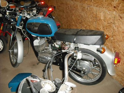

I hope this helps, Ghost. I didn't want to remove the seat if it wasn't necessary as I don't like the risk of damaging paint or fasteners. As I'm sure you know, it's impossible to remove and reinstall the side cover and "leave no trace". What I can see up under the seat is a multi-pin plug, presumably feeding the rear lights. I tried to take a picture up in there but it's so fuzzy as to be useless.

Postby ghostinthemist » Sat Apr 07, 2012 5:42 pm
Sorry metric my last problem is my brake lighting. I need a good shot of the wiring harness under seat plus having the brake relay in picture as well. You would thing it would just be color to color but i dont believe it is and there are alot of black wires gets confusing . It would be of great help thanks ghost

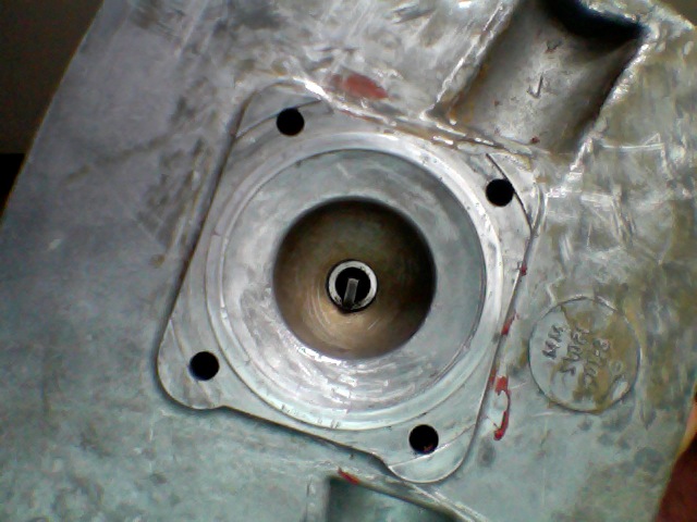

Postby adysor » Mon Apr 30, 2012 4:55 pm
I have two mz ts 150, I know it's out of topic but I want to ask if there is any gasket for the head, When I purchased mine it didn't have one and now I don't know what to do.

Postby metric » Mon Apr 30, 2012 7:38 pm
The parts catalogue does not show a head gasket.

Postby DAVID THOMPSON » Mon Apr 30, 2012 8:18 pm
i have seen several motors that had no head gasket..
but forget what the were its been years ago
but think it was some with very low compression ratios
one old 2 smoker i had we made the gasket from a piece of number 12 copper wire
and soldered the ends together ....

Postby radiograf » Tue May 01, 2012 1:23 am
According to an MZ dealer I asked some years ago, they don't have a cylinder head gasket. Just ensure that the mating surfacesare unmarked and level, and use a non hardening gasket cement.
