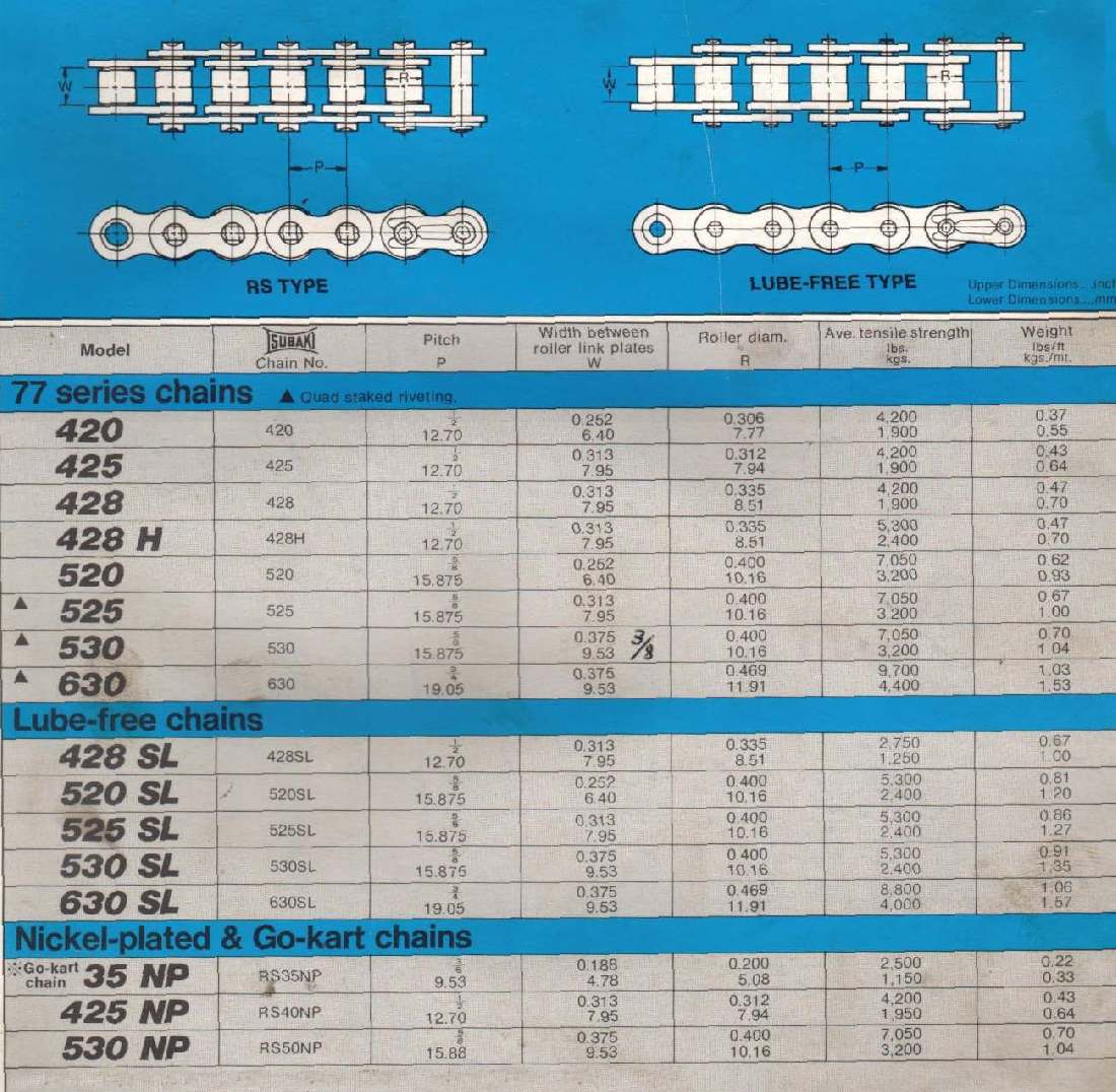

I don´t known the o-ring chain outer diameter can be different than a standart or reinforced chain :oops: .
I suposse SilverStar rubber chain guard have enought room to :?: : +1 or +2 milimeters width more if it is
necessary, we don´t talk about woman stockings :D .
I remember now the MZ ETZ models chain size is 428.
A manufacturer with good reputation in my zone: http://www.iris-chains.com/Ing/Sport.htm
The Truth with a capital T :D : http://www.quality-cycle.com/truth_abou ... chains.htm
Saludos/Regards

I've been researching a bit too. The Regina chain site here: http://www.reginachain.it/eng/products/index.shtml gives the best chain dimensions of any I've seen. The reinforced and o-ring chains are both wider than the standard chain due to the thickness of the link side plates. I imagine it's the same with all brands of chains. So I've decided to wait until I receive the chain rubbers to see exactly what width chain I can fit inside it. My SilverStar uses the 520 chain, and if I can fit the slightly wider (and stronger) reinforced chain inside the rubbers w/o friction I'll probably go with it and load it up with a quality chain grease like the manual recommends. This plan sort of goes along with the TRUTH article you posted. Interesting reading. :D
-Don
