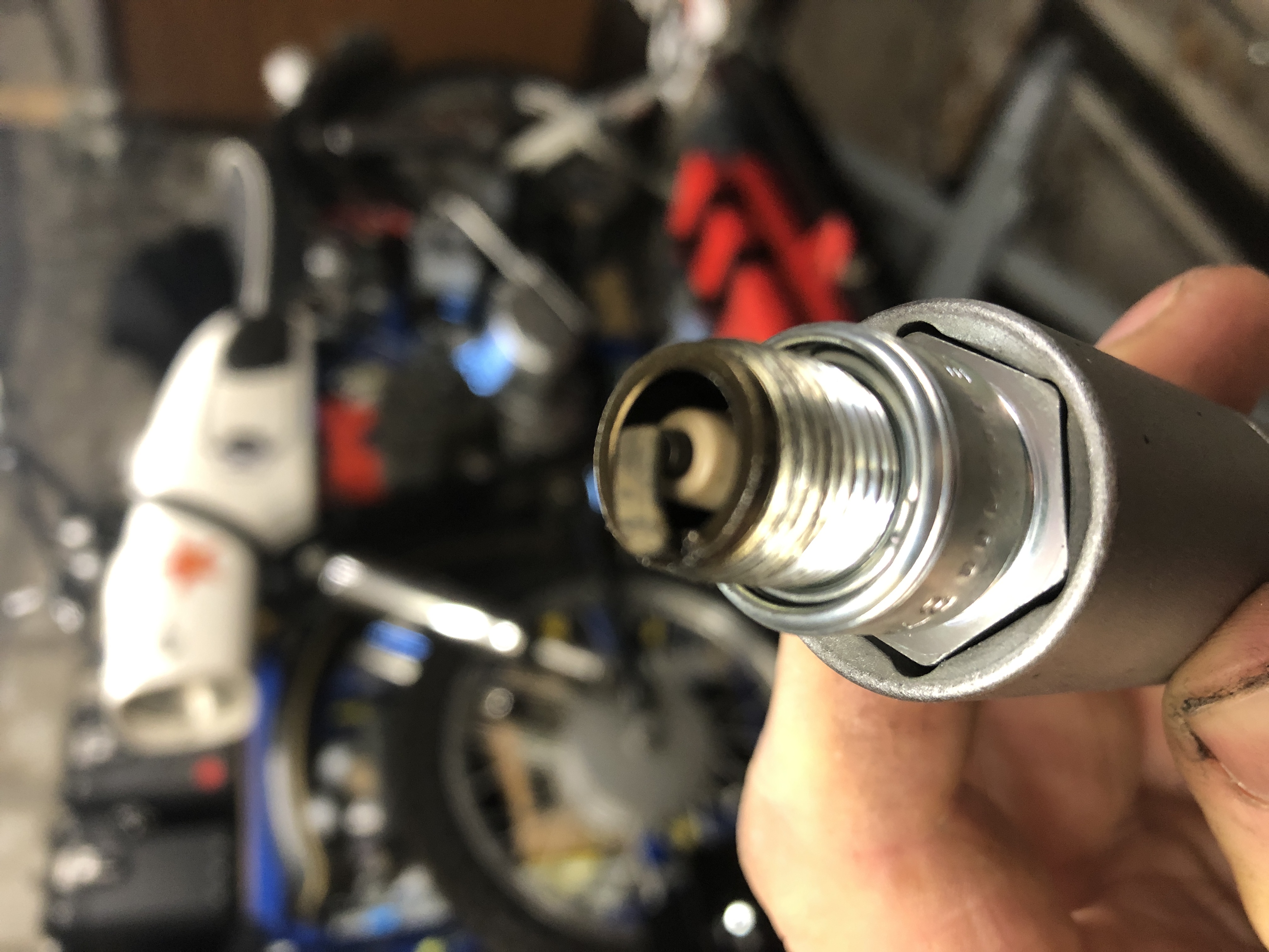

Postby ScotBob » Tue Dec 07, 2021 9:44 am
Plug colour:

Postby breakwellmz » Tue Dec 07, 2021 11:49 am
ScotBob wrote:Tried the tissue over the carb inlet and it sucks it straight in no problem, still reckon it’s main seals?
It would be difficult to start with shot main seals wouldn`t it?
Plug looks to show a weak mixture but has the colour changed from what it was?
Re: ES150 will not run right!!
Postby Blurredman » Wed Dec 08, 2021 3:23 am
Agreed. That is a lean plug!

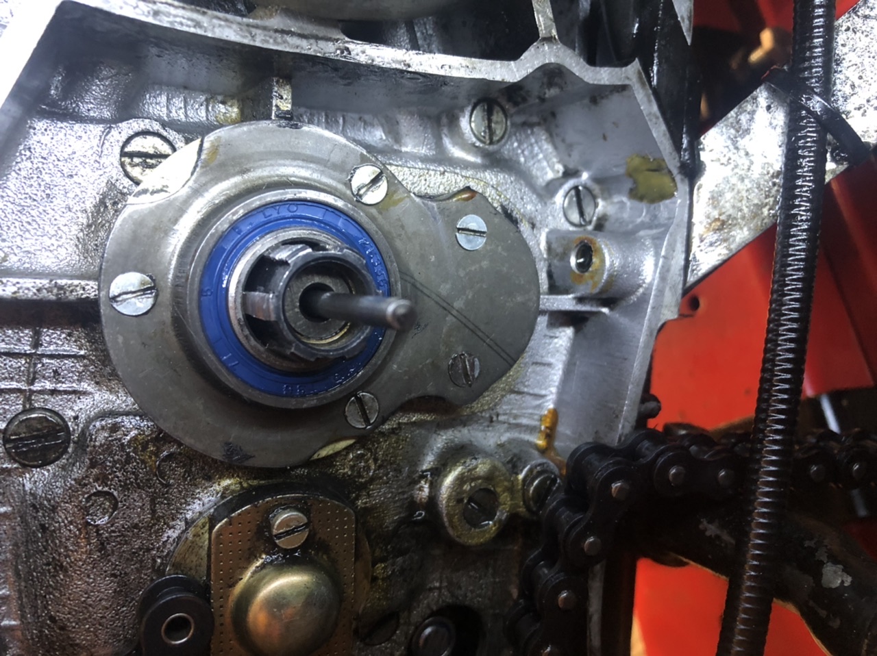

Puffs wrote:No I don't think it's the clutch side main seal. If it was, the plug would be wet with oil, it would smoke, and you would smell the distinct smell of gearbox oil, as I asked before. And if the seal was really gone, I'd actually be surprised it would still run, as I said.
You may want to have a look at the ignition side though. I believe these engines lubricate both their main bearings with gear oil:
The attachment 50.gif is no longer available
It looks like 2 seals, one on the inside of the bearing, one on the outside. Quite possibly the one on the outside leaks, causing oil to leak into the ignition, which causes your running issues (you have points?). Easy job, have a look.

I'm not sure that plug indicates a lean mixture. If the carb is in good order, and in the same setting as when it ran well, it shouldn't have changed. First sort the issue at hand, then maybe look at improving jetting.

Thanks for you thoughts and input; see pic below from ignition side if it is the pictured layshaft seals you are referring to, these are the first things I changed but to no avail,it’s definitely not burning gear oil and the oil leaks through the clutch rod hole in the layshaft.

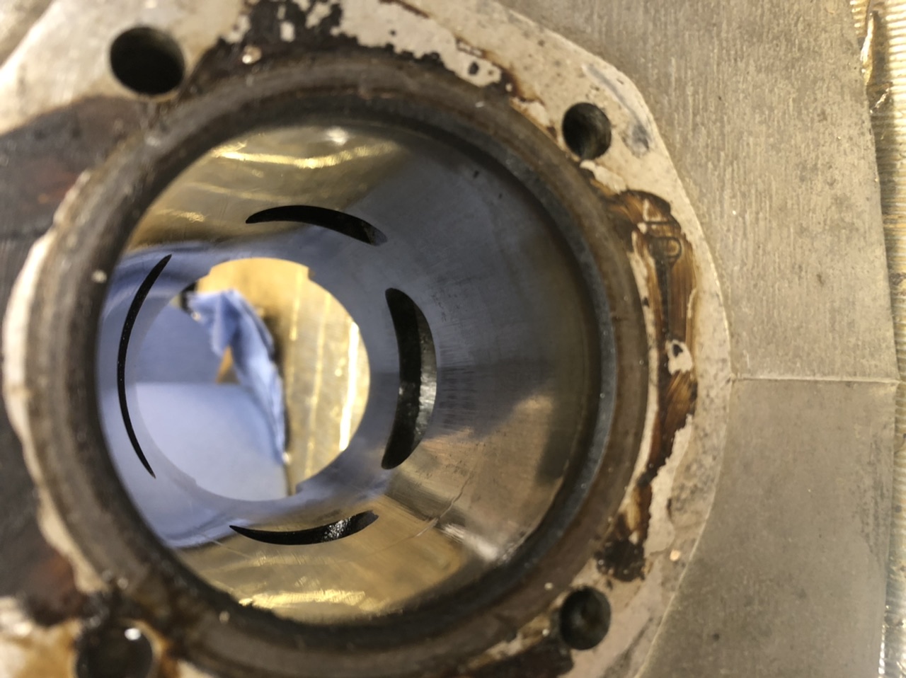

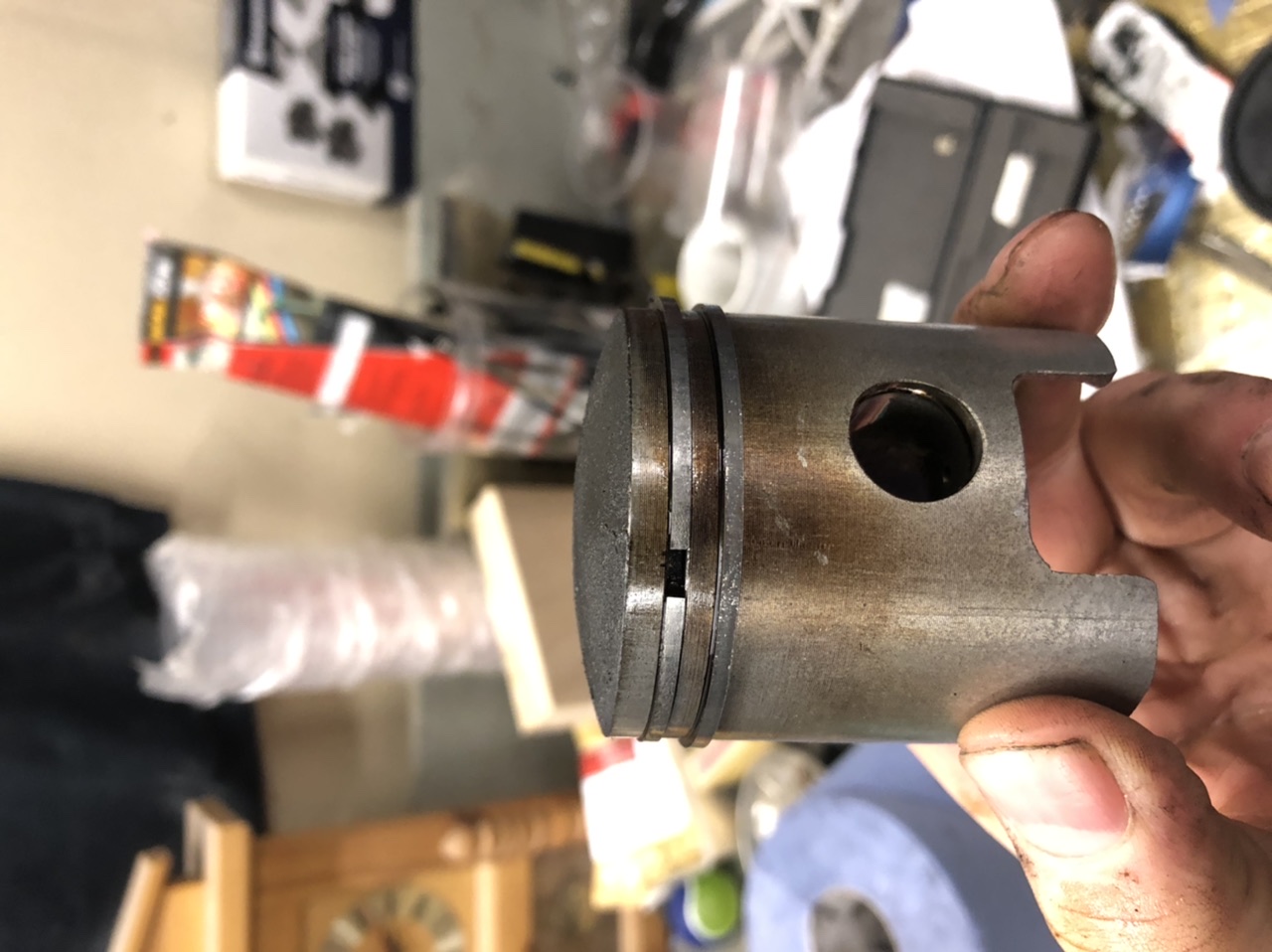

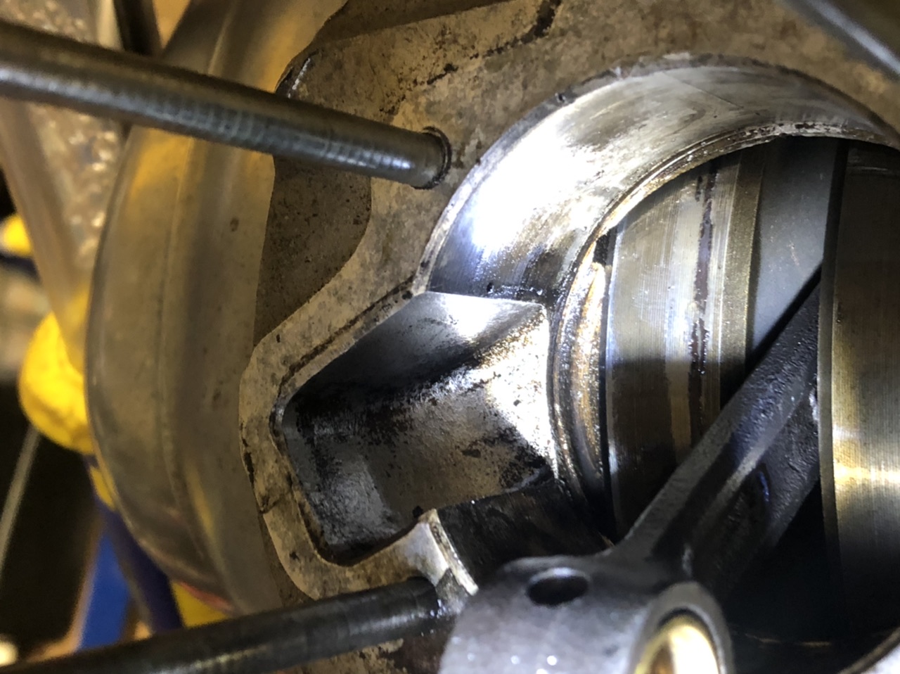

So head and barrel removed, rings are intact and undamaged and the bore looks good, there is a bit of scorching on the piston.
But the bad news: the crank is off centre and gouged where it has been hitting the casing, so could be bearing failure.
Postby ScotBob » Thu Dec 09, 2021 10:02 am
Piston and bore:

Postby AlanJ » Thu Dec 09, 2021 12:56 pm
Hi Bob,
Sadly looks as though you have found the problem. If you are right about the bearing, and, I suspect you are, then maybe it would be the right
time for an engine rebuild and if that is the case, and you want to go that way, then please give me a pm with your number, I may be able to help.
