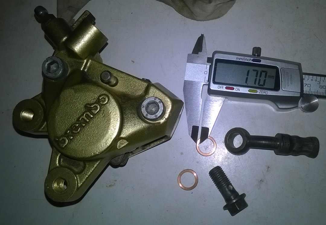

Note the construction is different, but to me those washers look like copper.

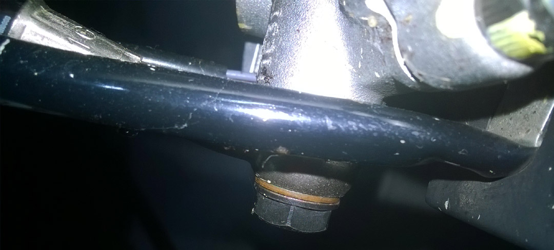

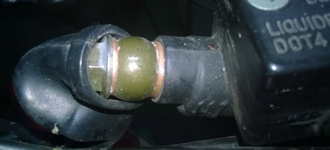

Hi Dave the fitting on the hose is standard. As discussed above and shown on the photos I entered here (although difficult to photograph clearly) the threaded hole in effect has no bottom to it...it goes all the way down and through to the cylinder section. With my original round tank version the thread is about 12mm deep and at the bottom is cone shaped with just a very small hole about 2-3mm in diameter. When you screw in the hose fitting, the end of it butts up to this and with further tightening hard it seals. As the new one has no bottom in effect it screws all the way in till the fitting itself meets the master cylinder boss so the only way to seal it is with a washer.
I contacted the seller and with his very tardy reply tells me that "ALL the new ones are the same"....Well maybe they are but I have no way of checking if he is simply selling me a faulty one as I cannot see any other new ones for comparison. I sort of believe him and will probably accept the item and now waiting for some Dowty washers to be sent to me. I was going to use copper ones but having used them before on other jobs, I know Dowty seals are very effective. Maybe as Puffs says, using them at high temperatures might be of some concern but at the master cylinder end, high temperatures are not going to occur unless my bike catches fire. :?
Hope you have the picture now Dave?
