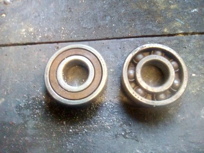

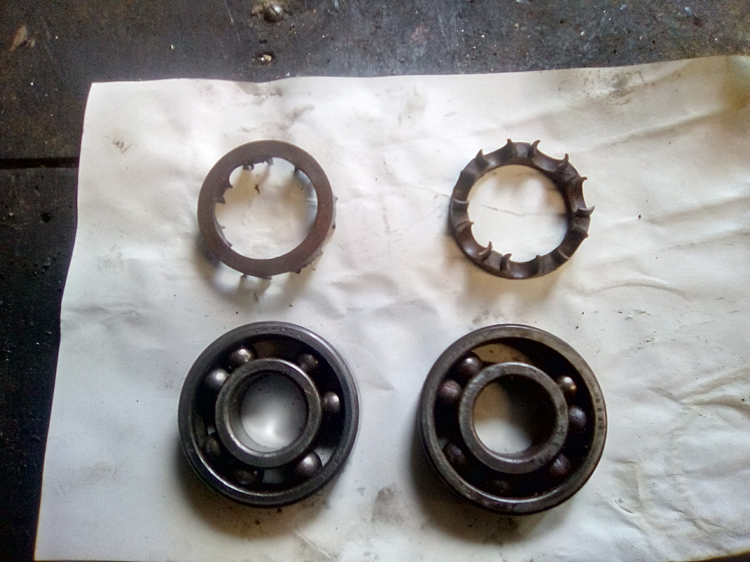

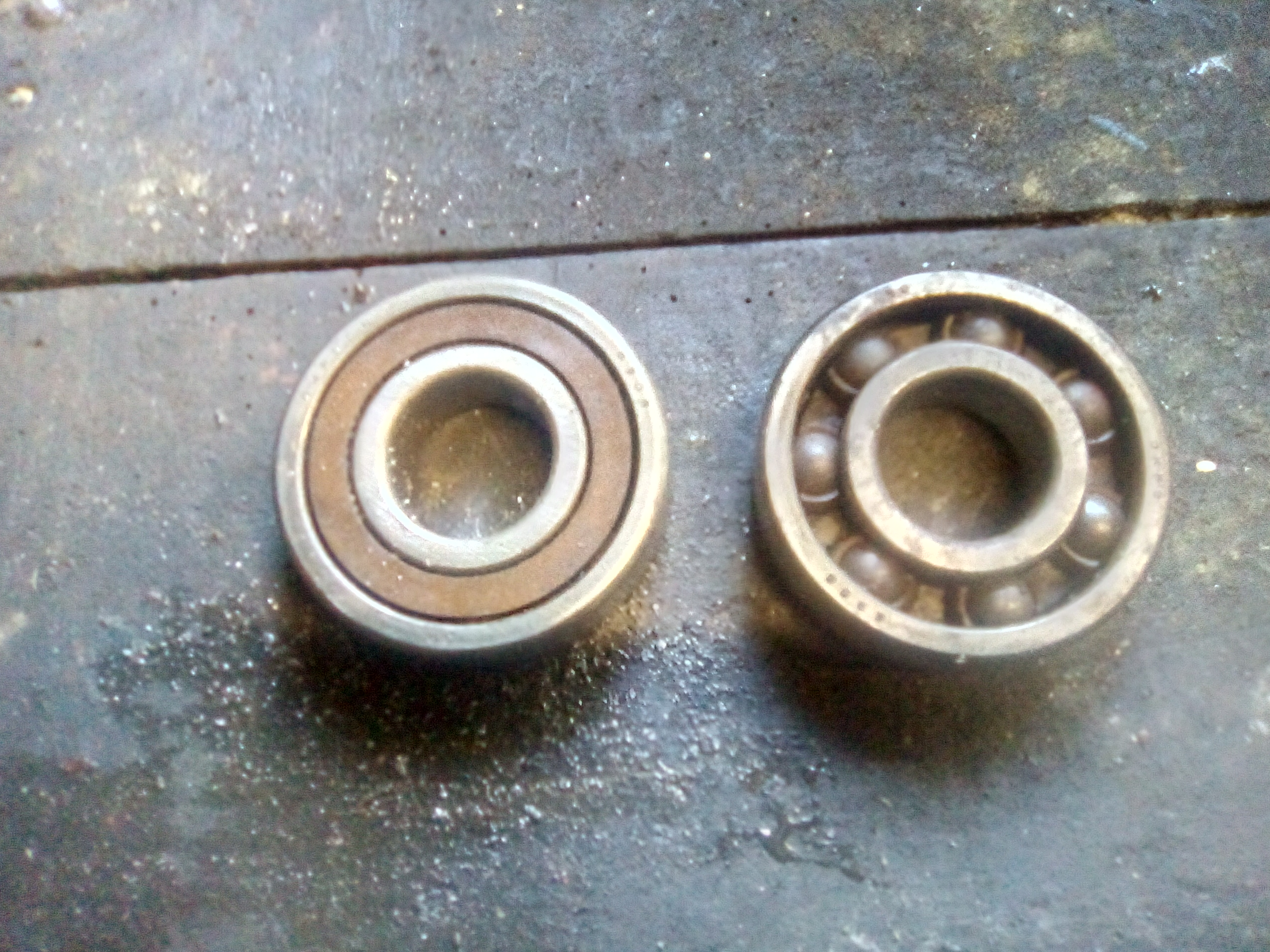

Postby Blurredman » Sun Jun 21, 2020 1:07 pm
Hi Guys,
I've attached my old bearings from one of the engines I have disasembled. This should clarify everything concerning the ball cage.
I really would like anyone who is re-building their engine to inspect what main bearings they have. If they don't have the attached DDR bearings then it is quite likely the engine may have already been re-built.. In which case the manufacturer identifier should be inspected.. The original bearings are actually labelled DDR.. You can take the cage out and have the bearings run sperately.
If the Nylon disintegrated into nothing (which I don't think is likely, actually) for whatever reason and all the bearings ran free, then it would be likely they would all freeze up the lack of ball roll woud rub away material on the ball and then they might fall out then when enough material is removed.. :?:
I myself have however experienced the cage being a potential issue however. On the last engine I rebuilt, one of the cages was cracked but it was still in a single piece and balls in their right place.. How long had it been like that? I don't know. I personally think it might not have been a product of a poor re-build, whereby the bearings weren't replaced. The crank had been re-built it seems with both copper shims on the one side. If it was built like that, then I also think the cage was broken by poor manhandling by whoever re-built it last. I think the two were historic poor workmanship by the last owner.
That said, I had put an extra 10,000 miles on it before MY re-build, so as above- was it a product of dodgy re-build, or did it happen naturally? 8)

Re: ETZ 250 Main Crankshaft Bearings
Postby nice2day » Mon Jun 22, 2020 2:55 am
An excellent interesting post Blurredman. Thanks for showing...Les

Postby Puffs » Mon Jun 22, 2020 4:23 am
Yes, thanks BM, yes, that does make it clearer: they are open on one side. That mitigates the concern I had on lubrication.
That cage makes assembling/disassembling easy! Move all balls down & you can pop-up the inner race.

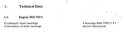

I wasn't sure when that 1:50 recommendation came, so I browsed some more in manuals: for the ES they still recommended 1:33, and changed that to 1:50 for the earlier TS (engine: MM250/3), which incidentally still lubed the main bearings with gear oil. Also interesting to see that for both those engines they specify "6305 c 003 f (geräuscharm)" as main bearings, for both. So those are C3's, 25x62x17, while for the later MM 250/4, where lubrication of the main bearings was done by premix, the recommendation changed to the 6306 C4f.
At least that's the recommendation in German, the English manual says 6304 C4f, which is odd, as 6304's are just 20x52x15, while the 6306 ones are 30x72x19. Apparently bearings shrink when translated to English, which is of course quite a frightening process.

Puffs wrote:I wasn't sure when that 1:50 recommendation came, so I browsed some more in manuals: for the ES they still recommended 1:33, and changed that to 1:50 for the earlier TS (engine: MM250/3), which incidentally still lubed the main bearings with gear oil. Also interesting to see that for both those engines they specify "6305 c 003 f (geräuscharm)" as main bearings, for both. So those are C3's, 25x62x17, while for the later MM 250/4, where lubrication of the main bearings was done by premix, the recommendation changed to the 6306 C4f.
Where were those English translations for the bearings from? Haynes?

Postby Puffs » Sun Jun 28, 2020 6:31 am
Yes, that's always good idea - have a looksee what's there.
See on page 92 of the "MZ_TS250-1977-Official_Service_Manual.pdf" that it says:

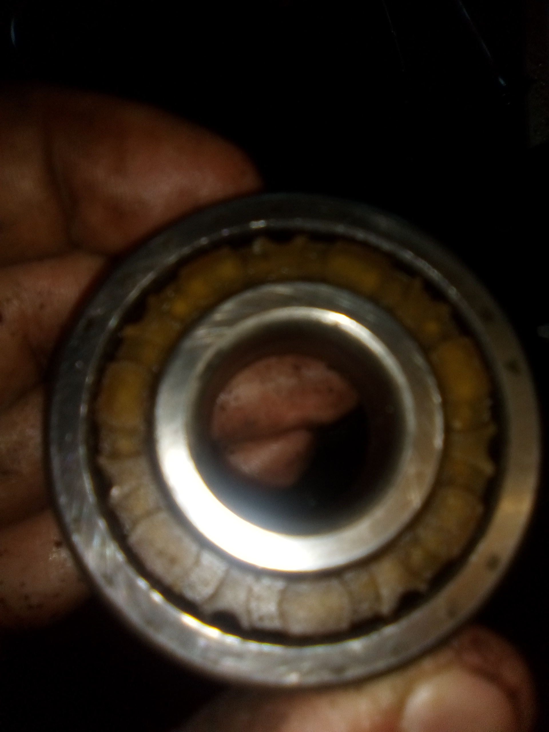

Postby Blurredman » Tue Jul 14, 2020 4:02 am
I was looking at my spare engine in bits, and looking through the bearings. And also found this little guy.
