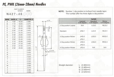

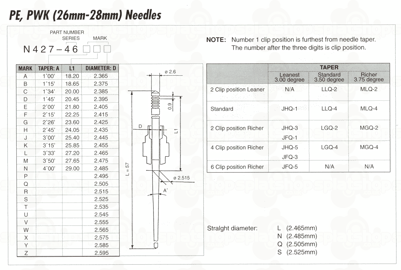

Been looking into replacing the needle, since it is still a bit rich around and past 1/2 throttle.
There are needle sets available, but I'm debating wheter I should buy just the needle I need or the whole set. Since the price is a bit high for my liking (cost as much as the whole carb).
In any case, first I wanted to identify the needle that comes in these carbs, and after a bit of searching around for the correct chart, I finnaly found all the necessary info.
The needle that comes in these replica carbs is a JHQ.
I attached the chart down bellow.
Hope it helps.

Re: TS 250 PWK carb
Postby Puffs » Mon Feb 14, 2022 12:00 pm
Thanks for that list. Interesting, but slightly confusing. I suppose it comes from Keihin?
So you're saying, the needle that comes with these replicas is a JHQ, wherein:
J --> taper = 3 degrees
H --> L1 = 24.05mm
Q --> D = 5.05mm
Do I understand that correctly? I'll have a look what mine is.

Postby Kruh » Mon Feb 14, 2022 12:21 pm
Puffs wrote:So you're saying, the needle that comes with these replicas is a JHQ, wherein:
H --> L1 = 24.05mm
Q --> D = 5.05mm
That is correct.
Except one typo; the diameter is 2.505 mm
I can confirm that all three needles I got with these carbs are exactly the same. So I assume the vast majority of replicas have the same one.

Re: TS 250 PWK carb
Postby Kruh » Mon Feb 14, 2022 12:45 pm
This chart is a bit easier to understand.
Also these are all the needles that come in those 10 piece sets.

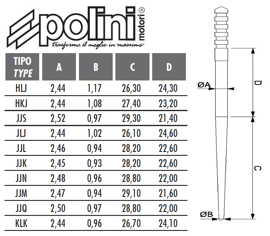

Re: TS 250 PWK carb
Postby Puffs » Tue Feb 15, 2022 4:12 am
Yes, sorry for that typo (needles are not 5mm in OD). I'll get back later on what needle I have in my Koso PWK32.
It's easier to assess a needle following that Polini table, as you don't have to calculate the angle of the taper.

Postby Puffs » Tue Feb 15, 2022 12:22 pm
So I had a look. First some comments on these charts:
1) In the Polini chart, the needle diameter ᴓA would be given by the last letter of the code from the Keihin chart. It is rounded down a bit, yet the KLK at the bottom should be 2.45mm
2) The taper calculated from the Polini values agrees roughly with what the first letter in the code suggests, but not precisely; within typically 0.1° (= 6').
3) The Polini needles are quite different from the Keihin ones, but of course so are the carb venturi sizes.
In my KOSO PWK 32 I found a needle without any marking stamped on it. It was slightly longer than what Keihin specifies for the 26-28mm PWK's, in mine the L = 57.9mm. It is clear that when the venturi size increases you need a longer needle. Yet min has a lowish taper, of around 2.63° (2°38'). The OD = ᴓA was pretty much a standard 2.50mm, so it comes closest to a HFQ. B, C & D were respectively 0.965, 33.43 & 18.15mm.

Postby Kruh » Tue Feb 15, 2022 1:26 pm
Looking at your numbers, I noticed I made a few mistakes. First of all, my taper turns out to be 2.6° (accidently rounded it off to 3). Later I also realized, the keihin chart measures L1 from the first clip notch to the start of the taper. Which I didn't measure.
The lenght of my needle is 57.8 mm.
Taper lenght, C = 33.7 mm
Diameter A = 2.50 mm
So I'd say you are correct, its something closest to a HFQ.
To me, they seem to be the same model, accounting for a margin of error. Whether its down to our measurements or the actual manufacturing of the needles. I mean, it is a bit tricky to pinpoint the exact start of the taper.
Thanks a lot for your input. Wouldn't notice my mistakes otherwise.
Also, I mixed some thing up redarding the jetting. It is slightly rich under 1/2 throttle, when on 2nd notch and lean at around 1/2 to 3/4 throttle, when lowered all the way.
So, from the commonly available needles, a JJQ needle might work. Since A is the same, but the taper starts later (should help low throttle), and with a steeper taper, should allow for more fuel in the mids. Maybe even the JJS might work. Others have a smaller A diameter, which wouldn't work.
Will look further into this, there a a few more models available in a few webshops.

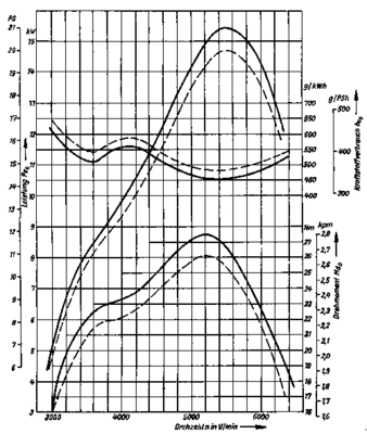

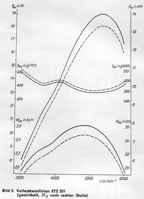

Postby Puffs » Thu Feb 17, 2022 8:01 am
Yes, I just had a look at the power bands of the TS250 (MM 250/3), ETZ250 (EM 250) and the ETZ251 (EM 251), and the TS does seem wider. However, the TS peaks at 5750rpm, the ETZ's at 5500rpm.
For what it's worth, see attached. These are confusing graphs, and particularly for the 251 inconsistent with the text (where they say it does 21hp=15.5kW).
I do not have a rev counter (no cable), I shift gears when I feel the engine roll off the power curve - is that what you mean by 'rev out'? I would expect that if you'd give full throttle, you'd reach that point quicker?
The Doctor's advise was: brake later, and open the throttle earlier. Wide open, I think he meant.
