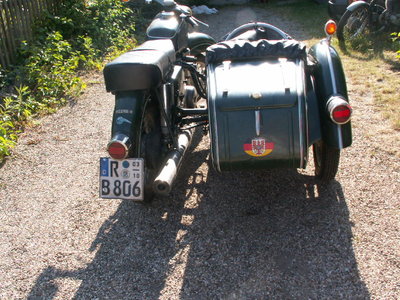

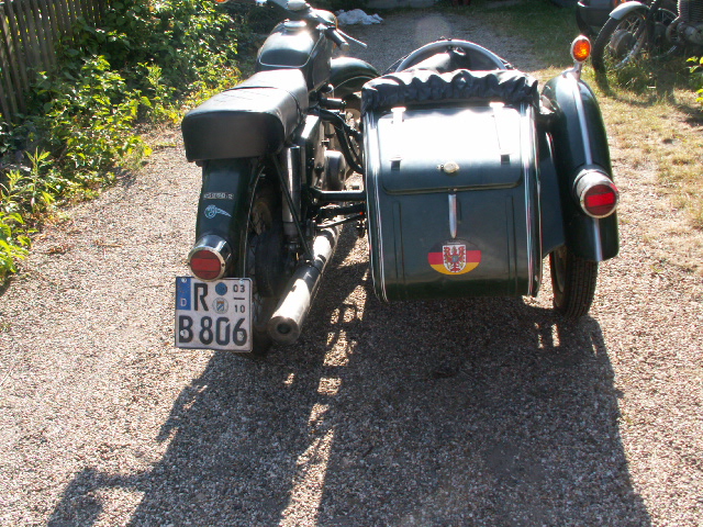

The attachment point on the frame are:
1.axe for rear swinging arm
2. Between fuel tank and seat
3.on the front support bearer (don´t know if it is the right english word for it).
And there is an additional stabilizer on the rear swinging arm.
And it is no problem to drive an ES 250/2 with sidecar. It was fitted this way from the factory, so you cannot compare it with the BMW :-)

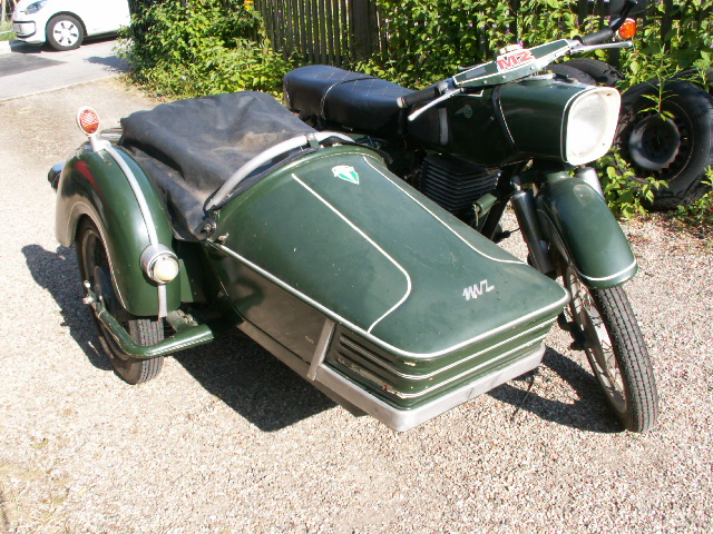

The bike on the pictures is for sale from a friend of mine.

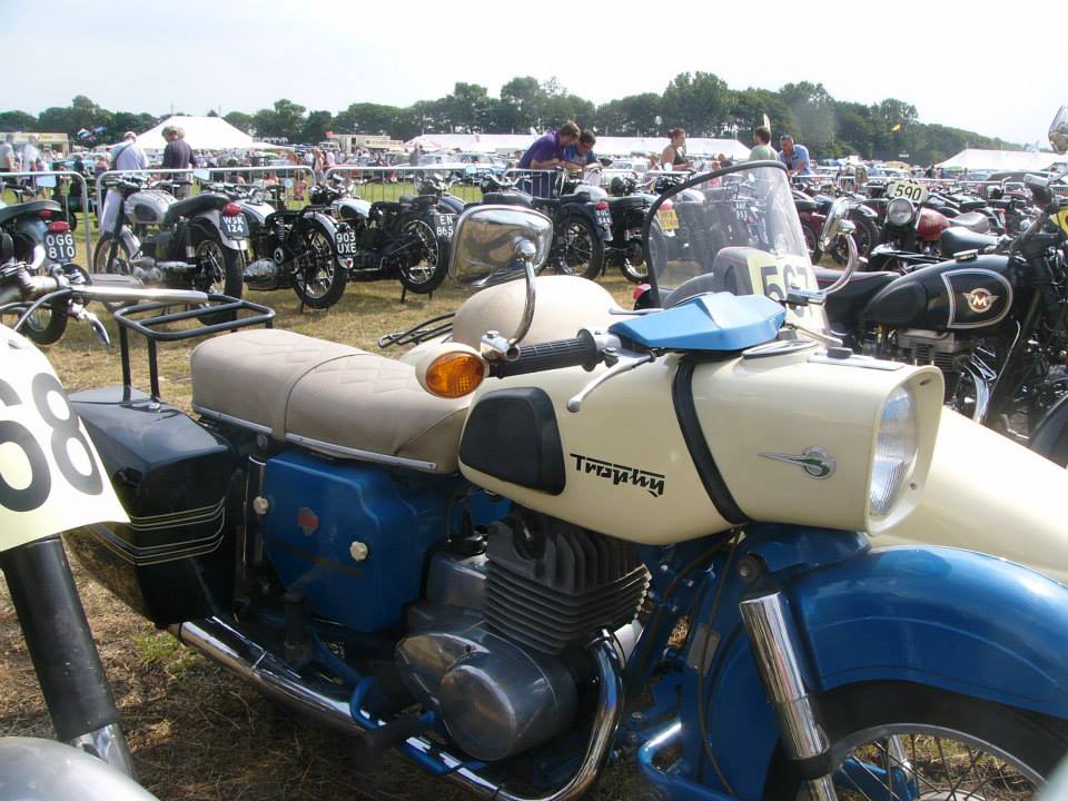

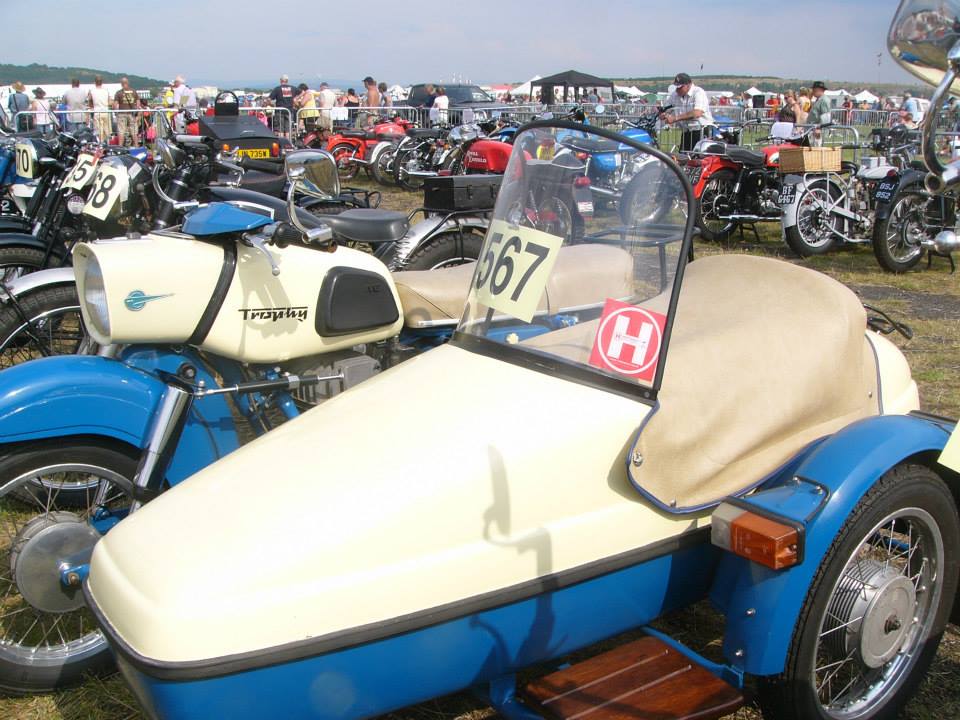

Nice ES250/2 Velorex outfit spotted at the Cumbria steam fair last weekend

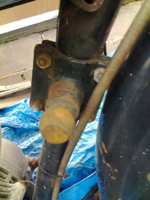

Could someone please show details of this.

Postby therealche » Fri Aug 16, 2013 7:18 pm
This is the mounting that MZ use

Postby neddyo » Fri Aug 16, 2013 8:51 pm
Thanks Therealche for such a quick reply.
I guess they would be like hens teeth to
find, but at least I know what the setup is.
Nick

The fittings are also rare ( the one in the picture is spoken for!) but it shouldn't be difficult to fabricate some sort of clamp to go round the downtube . Or find a rusty british fitting that can be modified
