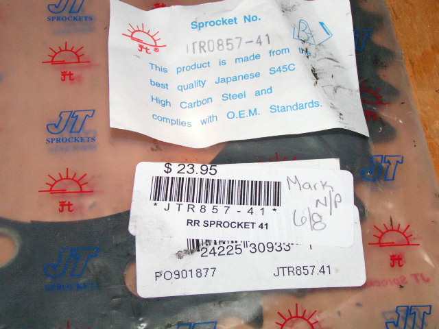

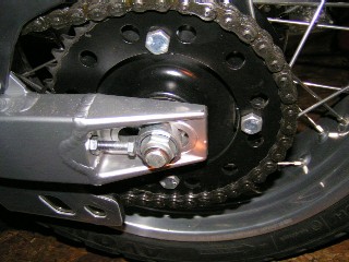

Hey - installed 41 tooth rear sprocket about 2 weeks ago. cruises noticibly better & imho effortlessly at highway speeds. usually 65 to 75mph no problem. stock power configuration (no mods / with purge canister) has enough torque to haul a$$ without bogging anywhere through the gears. i thought for sure i'd be stalling somewhere in 1st or 2nd sometime around the block... not at all. with the 43 tooth rear i felt i reached the top end too soon most of the time on the open road...not any more! the stock chain (@7500km) is new enough that it leaves room for 1 or 2 more adjustments before i need to remove the one and a half links as recommended by the shop i bought the xt600 sprocket from. i'm luvin it!

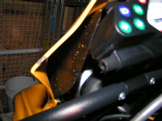

also replaced the original headlight bulb with a piaa super plasma bulb ($39.95) which i feel is worth the extra bucks over the ($8.99) H4 from pep boys (it'd better be since i spent it already...right?). last night on my ride i noticed more focused & brighter low beam spread PLUS laser like blind 'em a mile away high beam performance. i like it. to minimize the nasty reflection behind the headlight fairing, i cut some black number plate sticky material down to a cone shape to fit between the headlight and the speedo which knocked the reflection down considerably.

Is the rear sprocket a OEM Yamaha part? If so, what is the part number? I was at my dealer last week trying to get a smaller rear sprocket and they could not find a part number for anything other than the stock 43 tooth. I really dont want an aftermarket sprocket.....

JTR857-41

Ah, an aftermarket JT sprocket, did it look as good as the original? The price looks right :)

The only difference I see on the sprocket is that there isn’t a recess in the metal around the 4 boltholes. When I replace the chain I want to use a polished steel rear sprocket. Probably look into a Scott oiler too…I wonder how messy they are.
