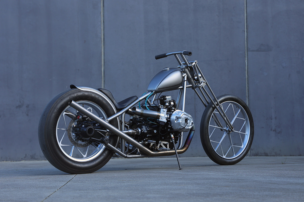

Like this? Ha ha. :D

the problem with most bmw choppers is they turn out real UGLY most of the time
the one above is better than most
DAVE
