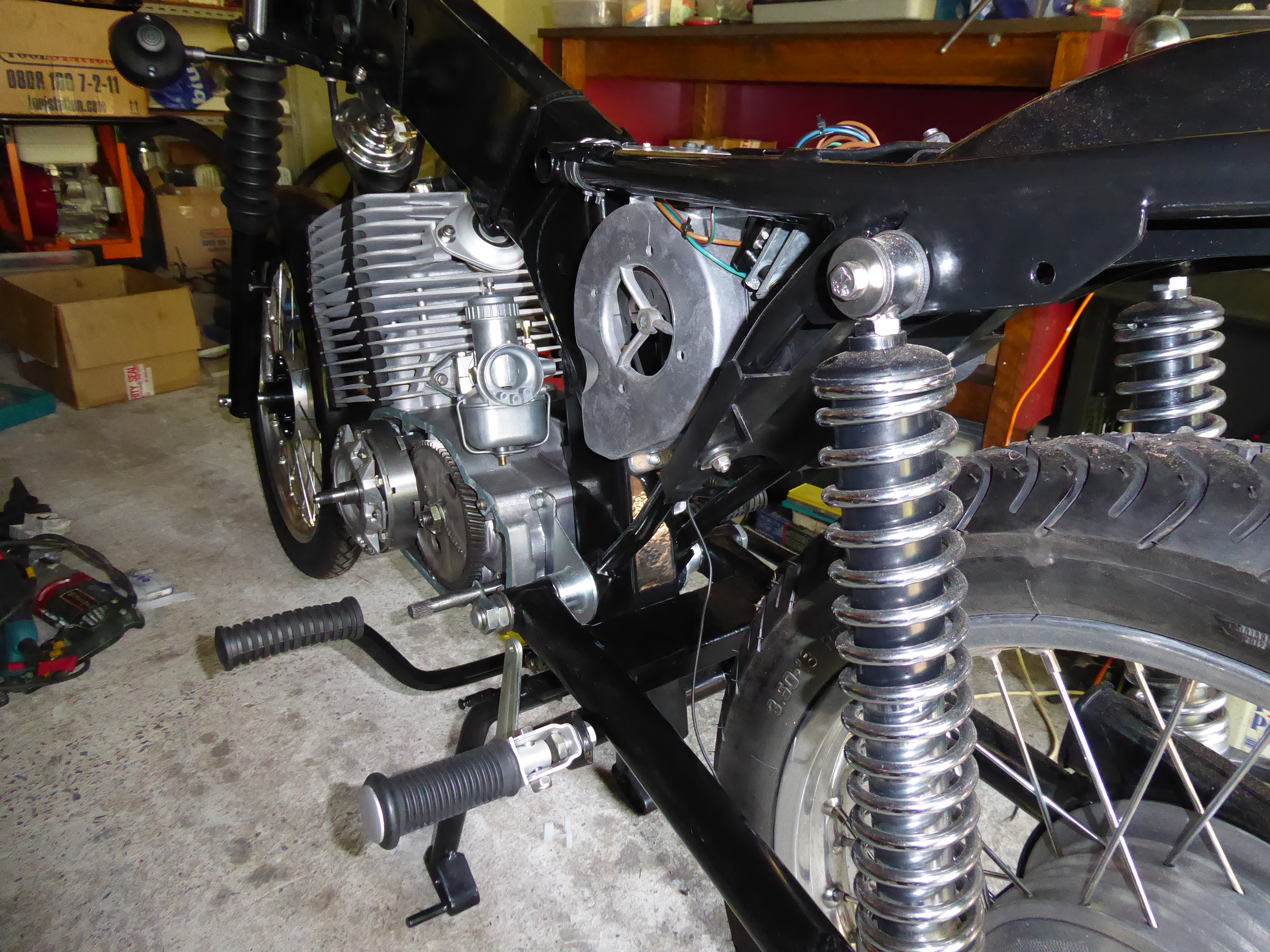

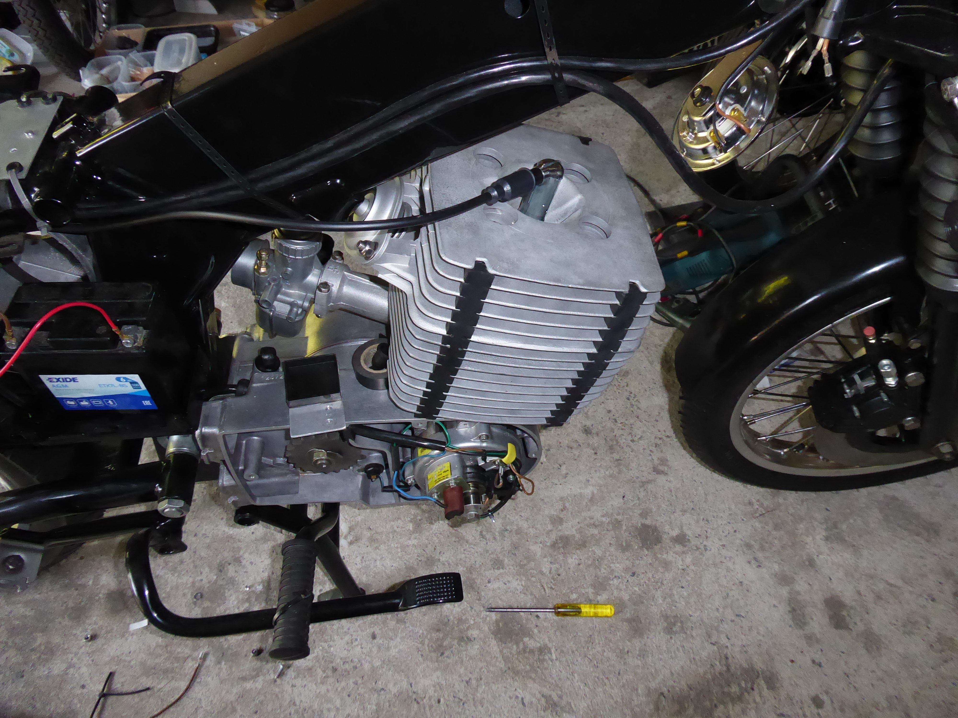

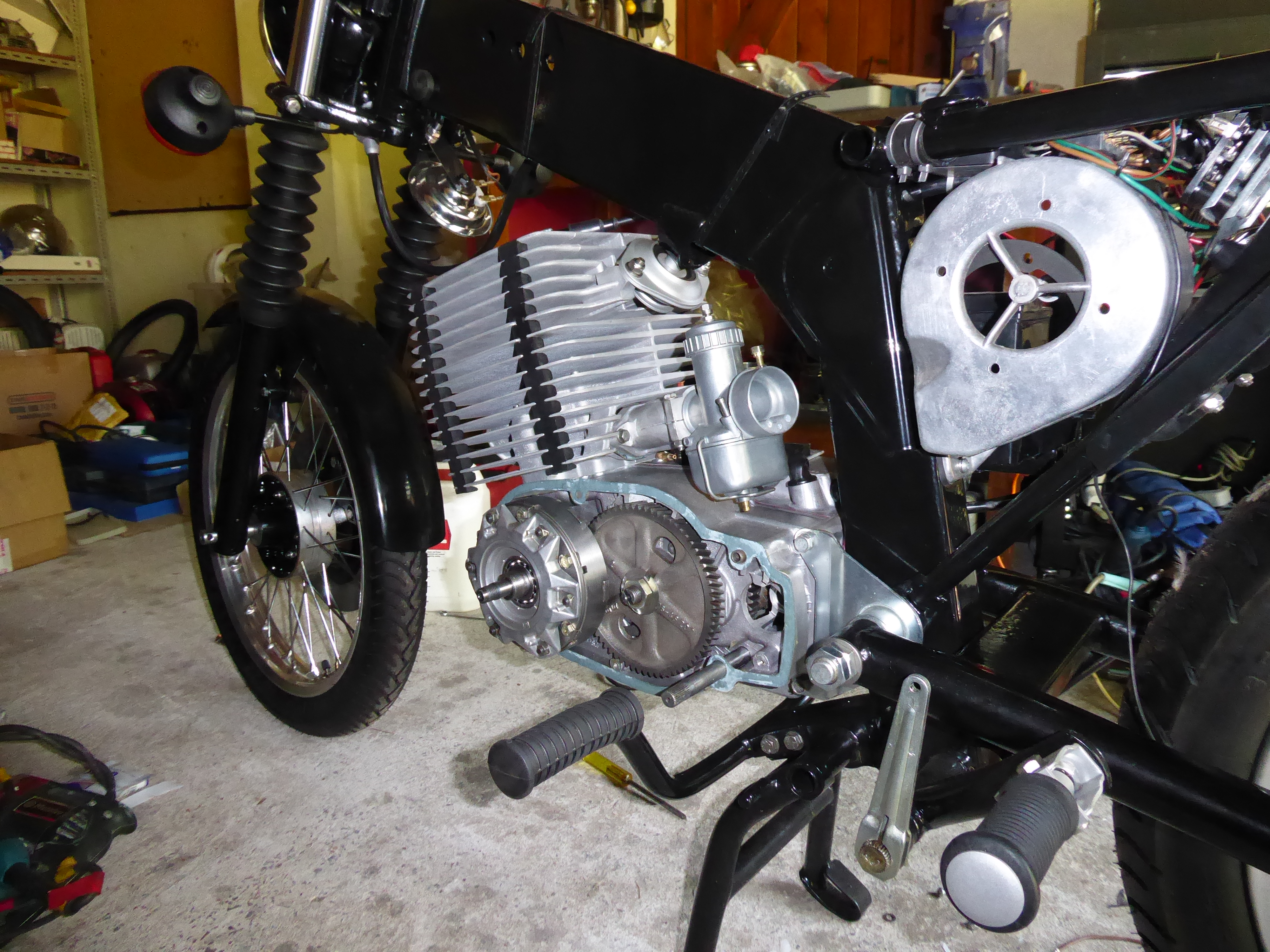

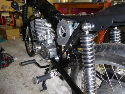

Just to let you know Guesi. I respect every part of the MZ I am restoring. I treat it with utmost respect as I admire the quality of the engineering. I am a bit of a perfectionist which is why every thing I do (apart from eating my dinner :lol: ) takes such a long time (years). When I work on a bike I have to try to make everything as perfect as I can, or even make it better as long as the upgrade is in sympathy with the original or unnoticed. My current ETZ 250 has been taken apart to literally EVERY nut and bolt on the entire machine, apart from taking the speedo and tacho apart there is not one screw that has not been removed and 90% replaced with stainless steel items. When I look at the Factory Parts List I think wow, there so many (hundreds) but I have worked on every one, cleaned and refurbished every single part...I have even rebuilt the wheels myself and I try to keep as many original parts as I can and all these are refurbished by myself too. Today I found 5 screws that I will not remove as they seem very difficult to undo (they seem to be glued in?) I wonder if anyone can guess what screws I am talking about ?..one clue they are on the left side of the bike... :D
Anyway here are a few more photos...it's coming together a bit more quickly now (Thank God!)

Postby Blurredman » Thu Sep 17, 2020 5:28 pm
Looking lovely..!
Boyer Branson ignition?

Postby Puffs » Fri Sep 18, 2020 2:34 am
Yes it does!
Even a new horn... Did you make the inside of the F hub black? How come all castings (& carb) looks so new? Did you sand (/vapour/?) blast it?
Anyway, seeing this & your previous work, I once again think that when issues arise, you'll solve them adequately.
Even so, I'm quite disappointed that you did not take those 5 screws out. You know the ones I'm talking about...

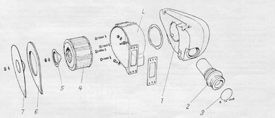

And yes...I tried to undo the 5x screws (I think there were five) so I'll tell you...they are the screws that hold the air box together and I realised afterwards that the box is GLUED together so pointless in getting them out. The inside is perfectly clean and bright anyway....well something had to be clean somewhere... :wink:

Postby Puffs » Fri Sep 18, 2020 4:27 am
Ta Les, on sharing those trade secrets. That all sounds quite intense & a lot of work - but it looks great!
The airbox & filter holder I've had apart too, but thought those were just 3 screws. Anyway, looked it up:
Maybe 4, maybe 5 as you say. I think I left those in place too & just sprayed the airbox as-is.
