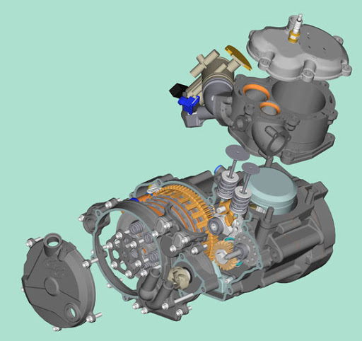

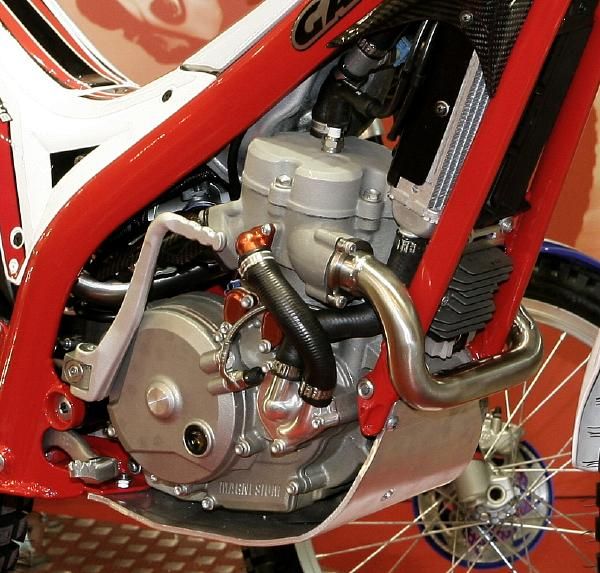

Not this one! :) -

That's a very interesting engine breakwellmz. The advantages of a side-valve engine is the lower cost due to simpler design of operating the valves and the simplicity of head design and lubrication system. The dis-advantage is all down to lower efficiency because of the shape of the combustion space and the restriction of gas flow from the valve into the combustion space as it has to take a right angle turn across the top of the cylinder bore which has to be shallow in order to attempt to get a half decent compression ratio. Lower efficiency also means higher fuel consumption for any given BHP output. These aspects are not that important if the engine is used to power a trials bike as shown plus the lighter weight of the engine is an extra advantage.
In reply to Puffs, I am not sure the oil consumption is worse than an OHV design, in fact I would say a side-valve should use less mainly because the valve guides are only splash lubricated and that the oil is applied at the bottom of the guide rather than in the OHV design where it naturally wants to flow downwards into the inlet port (assuming the cylinder is vertically aligned)...Proof is in the eating (burning) of course. :) ..I would say if any engine is badly worn it will burn oil, but maybe the side-valve might have wider/slacker tolerances due to lower cost engineering? :|

A shorter engine with a lower centre of gravity as well by the look of it, it would still be far more fuel efficient than a two stroke though surely?
Gas Gas didn`t take it beyond prototype form it but here is a video of it in action. - https://www.youtube.com/watch?v=jyxHBw0ymvg
I seem to remember reading that it would rev to over 10000 rpm if needed!

Definitely more economical than a 2 stroke. I would imagine the engine was perfect for a trials bike. Maybe just too expensive... but many riders have enough money to buy the best if it gives them the edge...Thanks for showing this.
