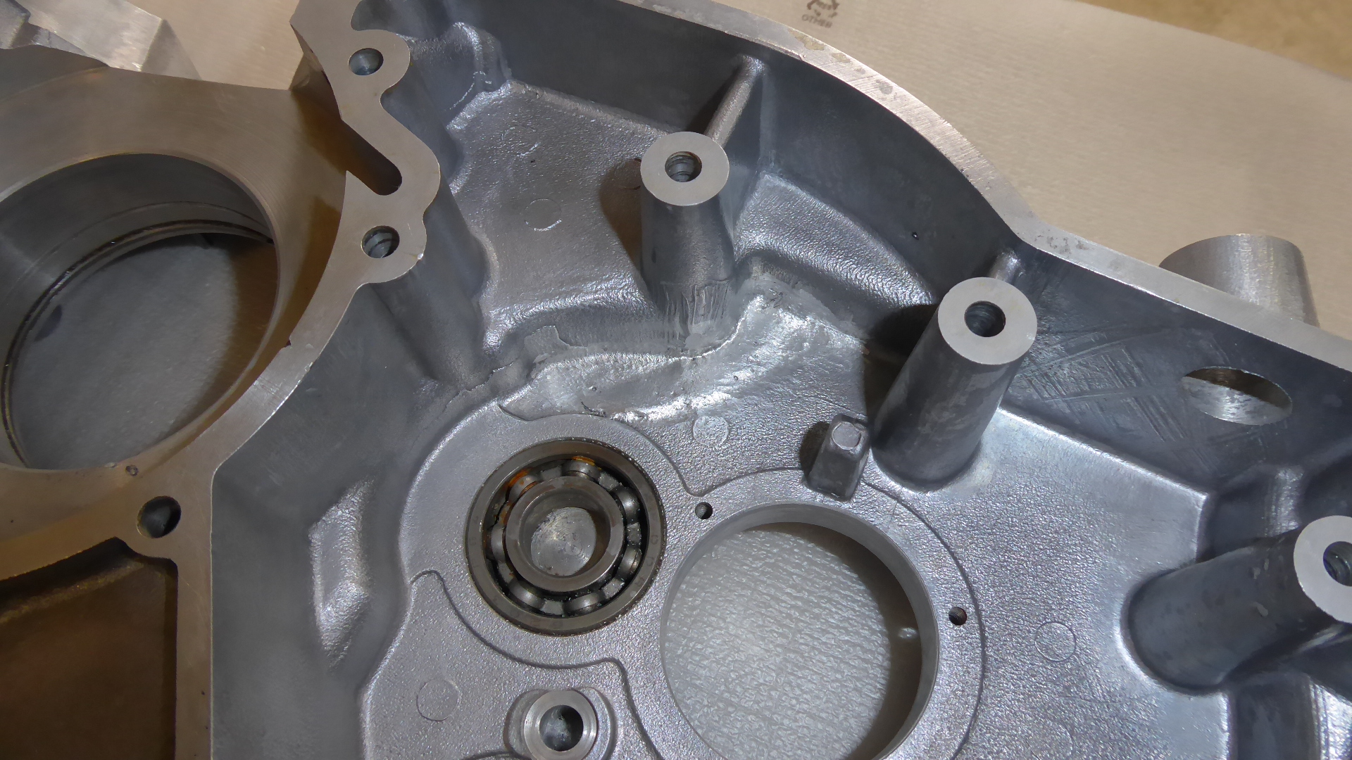

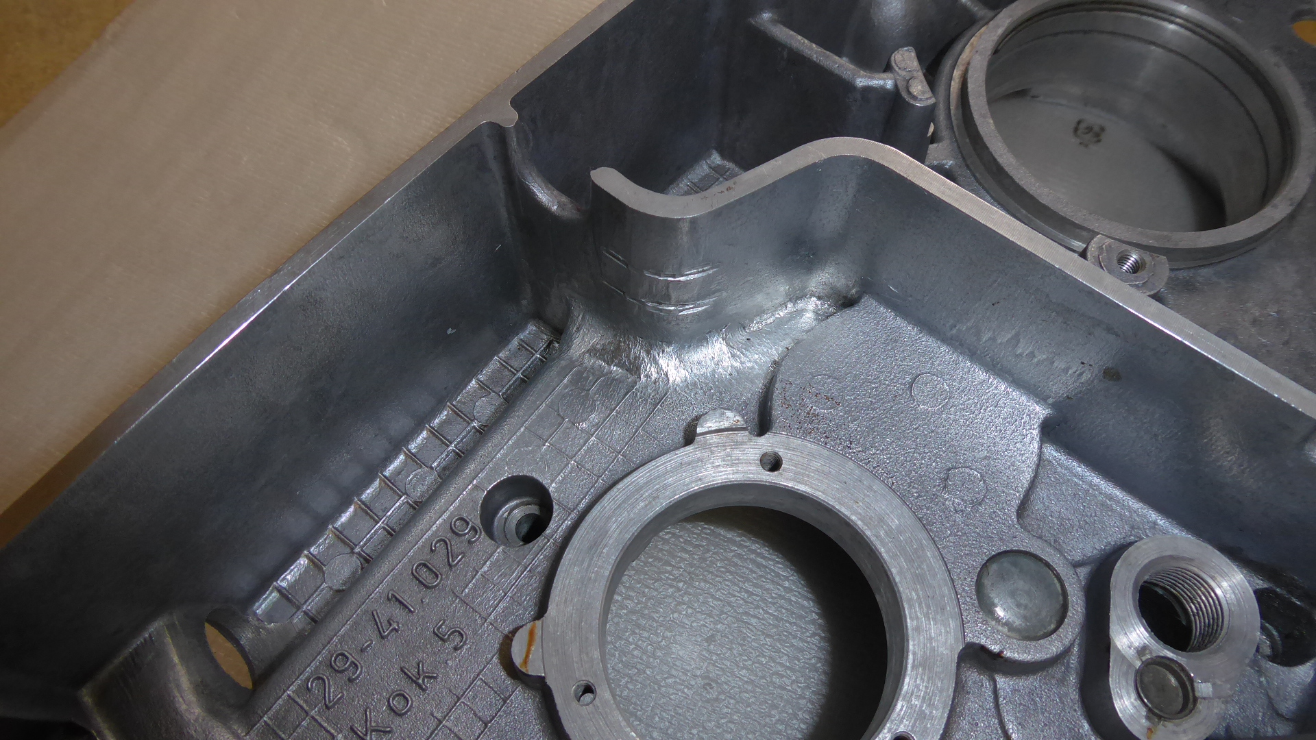

Well I eventually did get the crankcase back. The welding wasn't too bad but not easy areas to get to in all fairness. Well I used a Dremel with Carbide burrs and cleaned it up so I'm reasonably happy with the weld (Noting it would be an unusual event if I was entirely happy :D )
I just have to get the layshaft bearing removed now but can't shift it by heating to at least 200 C and slamming the case down on the bench so I have had to order a blind bush extractor set...still waiting for that to arrive.

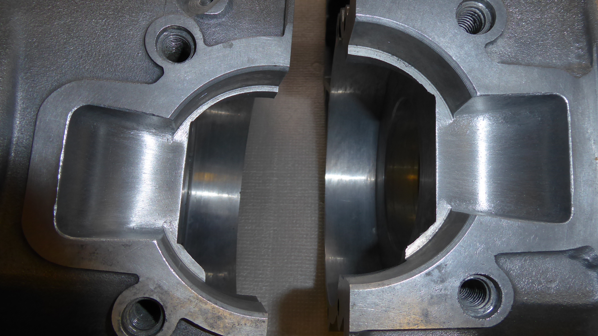

I also thought it would be worth matching the crankcase transfer ports. The right side one was badly matched where the port met the the machined area at the neck of the opening which left a sharp 2mm deep right angled step which would have impeded gas flow on one side. If they were both the same (with a step) maybe I would have left them but there was a large difference and its crucial on a two stroke that the transfer gas flow is near as identical as you can get it.... Using the Dremel carbide burr and then wearing away my thumb flesh, I managed to get both ports with a similar smooth curve.
