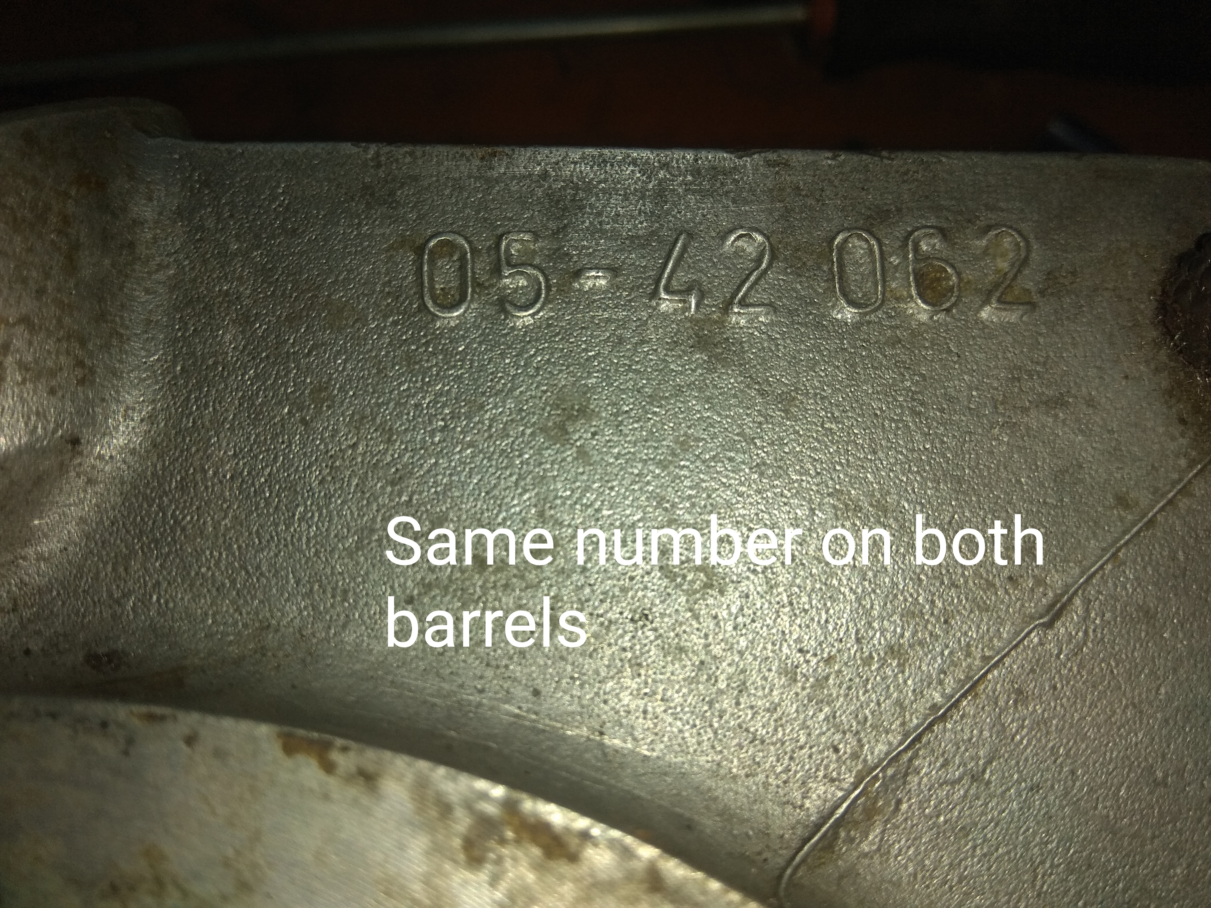

Both barrels have the same casting number

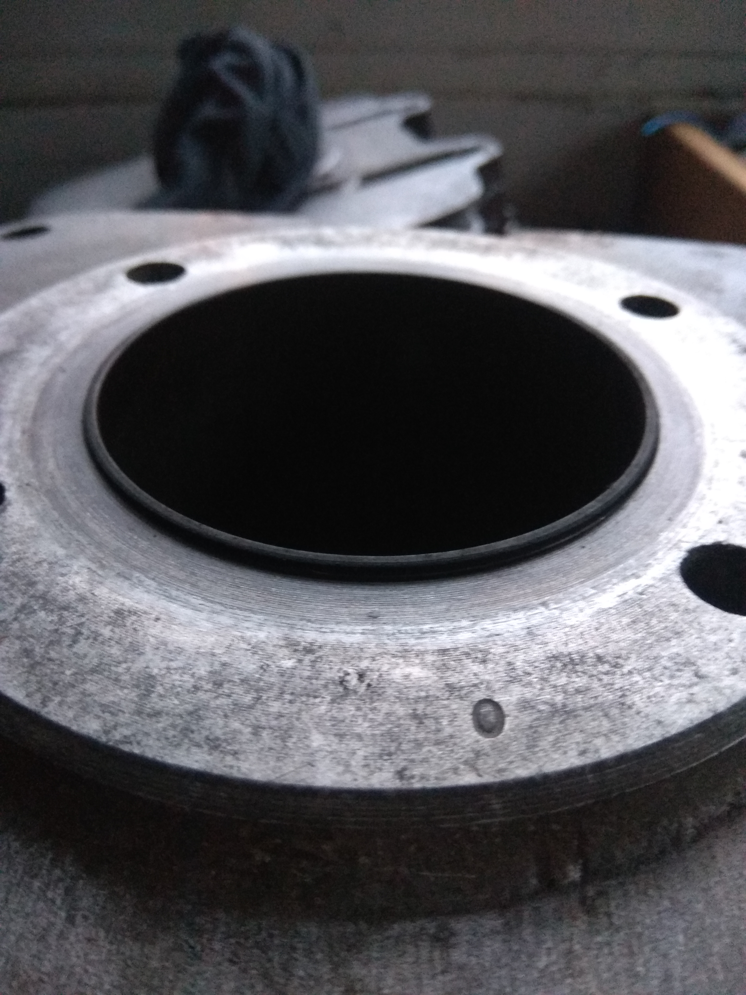

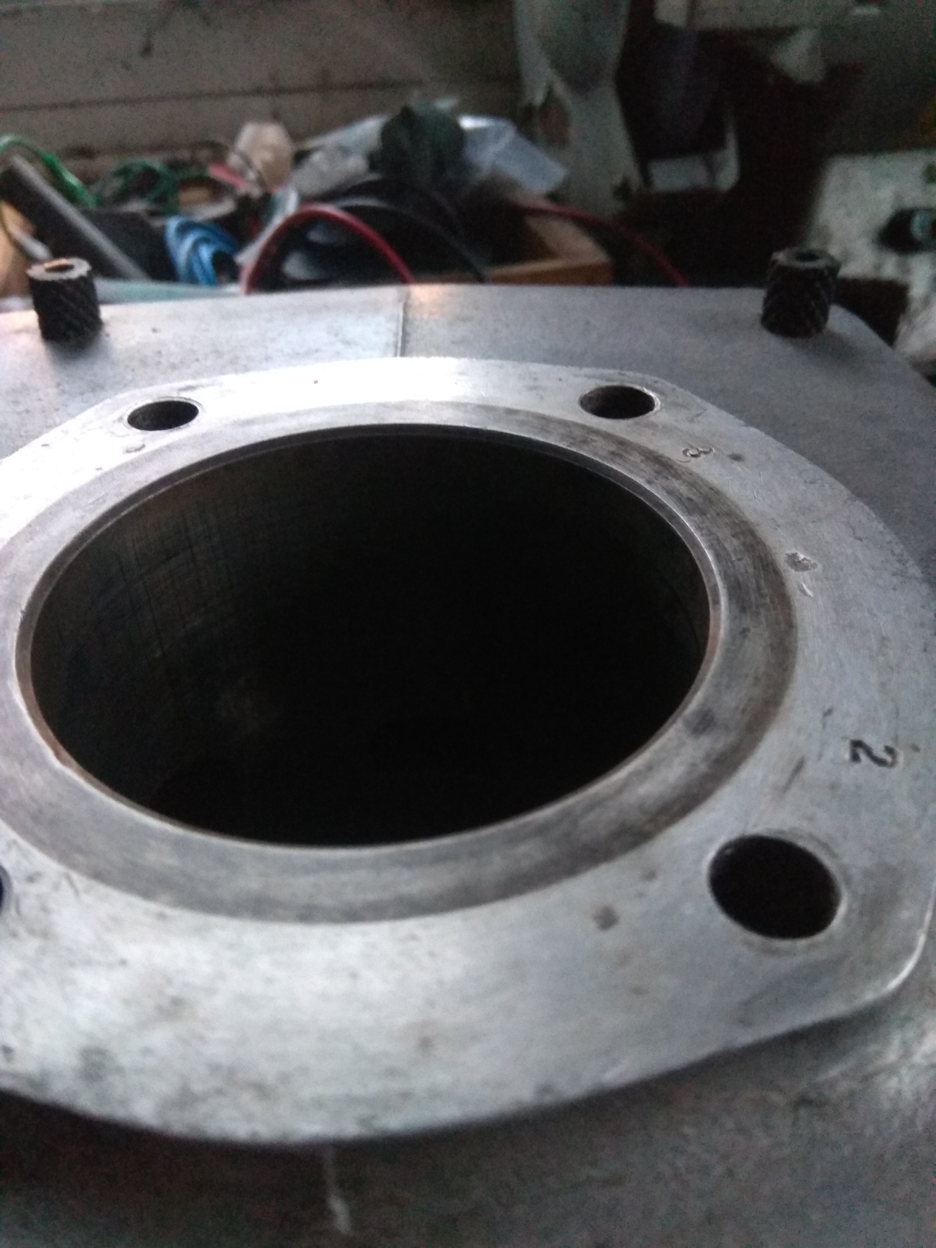

Ts 250 barrel at the to[p has no lip

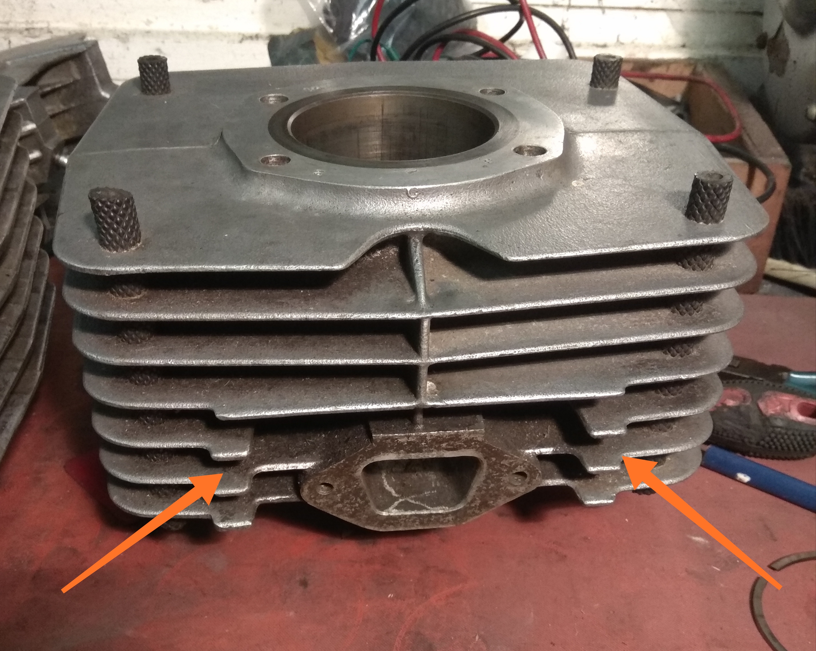

250/1 has a lip at the top

2) The lip at the top of the barrel where it meets the head. 250/1has a square casting and a lip but the ts250 is round with no lip.

Right, I learn that when they went from the 4-speed TS250 to the 5-speed TS250/1, that lip was introduced. I had not noticed that lip on your earlier pics, and just reminding you that I never saw any of those barrels in-the-flesh. However, that lip is also there in the later ETZ's, which followed the 5-speed TS. It probably helps sealing, but I don't think it is essential: when boring a 250 barrel to 300, as some do, that lip is lost. However, it will probably require a different head... Either to accommodate the lip, or to compensate different heights - you should measure the heights & distances as indicated in viewtopic.php?f=20&t=10396&sid=a1e9473259d5d867a7cb99b1e9f93366#p51000. I suspect that the port heights from the top of the lip will be the same as those from the top of the barrel (sleeve) in the 4-speed one.

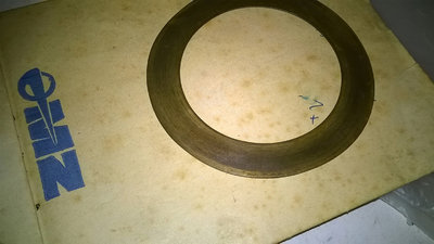

2) The lip needs to fit inside the head. At TDC, the piston will probably be at exactly the same height from the top of the lip in the TS250/1, as it is from the top of the TS250 barrel. But you need to verify that. If that is so, you might still use a TS250 head on the TS250/1 barrel, but it requires a ring around the lip, to correct the compression & the height of the barrel. A bit like this one:
Compression ring.jpg (21.86 KiB) Viewed 327 times

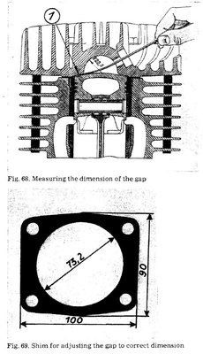

but then with the thickness of the lip's height. But as your bike is a 5-speed one, you might actually already have the correct head? We don't know what your predecessor did, have a look. At any rate, you should measure the gap (page 30 of the manual):
Gap in TS250.jpg (30.73 KiB) Viewed 327 times

The TS 4 gear and 5 gear cylinders are interchangeable.
But the one without lip is not an TS 250 4 gear but an ES/2 cylinder.
The lip was to center the cylinderhead in relation to the cylinder
The ES cylinderhead was centered by the long cylinderhead screws.
So there was no need for a lip.
The TS 250 models had another cylinderhead with smaller holes for the Stud bolt for cylinder fastening. The head also had the function to hold the engine in the frame.
So your cylinder without lip is NOT interchangeable. It is an ES/2 cylinder.
As the mould for the cylinder is the same on both models, the spare part numbers are the same.
That is why I asked for a picture of the intake side.
You can see on the right cylinder on the picture above that there is a sprue on the left side where the intake is.
This is because on the ES models there was a cover for the carburetor. And this cover should touch the cylinder where the sprue is.

Yes, I see what you mean, there is a straight protrusion on the RH barrel in
barrels mz.jpg (43.87 KiB) Viewed 327 times
which could fit a cover over the carb, as the ES had & the TS not.
Indeed, a major difference between the ES & the TS is that the engine in the TS (as in the later ETZ) is fixated in the frame via the head. That will enhance the need for a positive fixation barrel<>head, hence the ridge/lip on the barrel. As you have a TS frame, you will have a TS head, so you should be good to go (after a rebore?).

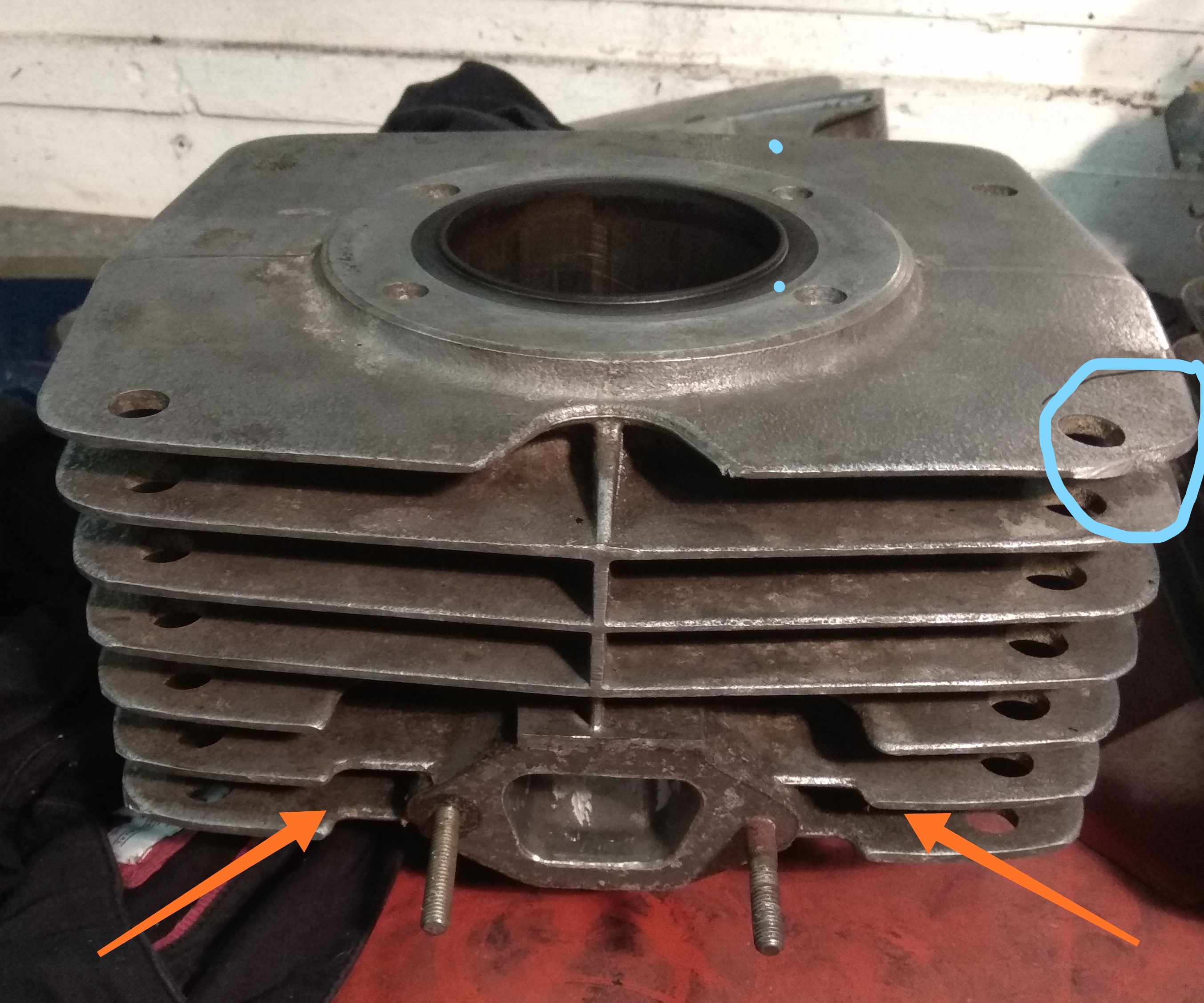

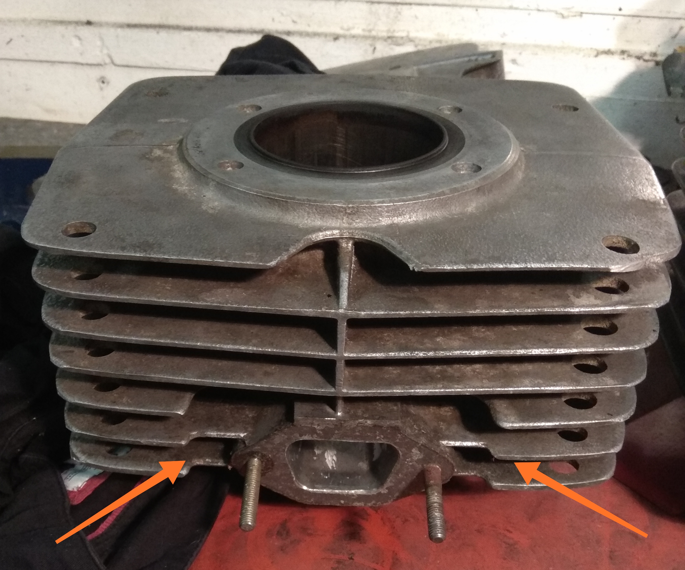

Just to be clear.The old barrel with a broken fin from the bike which is a TS 250/1 Supa 5 from 1982, the barrel I was hoping to get rebored and fit to it now turns out to be an es250 barrel.
1972 Es250 barrelwith the carb shroud supports shown
and these to barrels cannot be swapped
1982 TS250/1 Supa 5 Barrel from the bike

this is the barrel orginally on the bike note the damage in blue
Above is the one incorrectly rebored form the bike
ES250 (so I'm told) bought from ebay
This is the one that will not fit, due to fitting of the head bolts..shame
