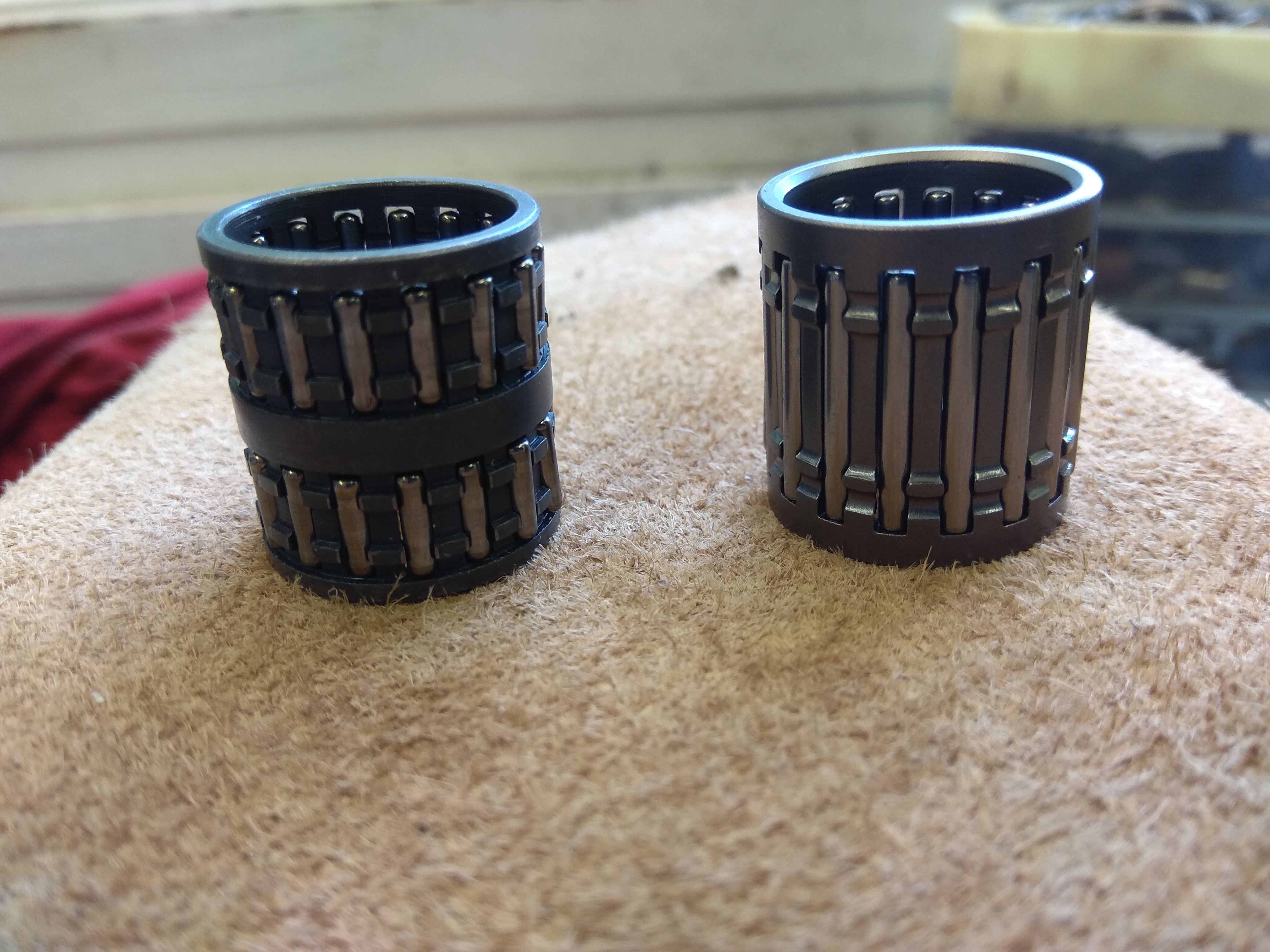

Bad news it is. All back together with new long pin needle roller bearings and although the engine does sound very slightly better it still has a rattle. So it's engine out time.
There didn't seem to be any wear to the bearing surface of the con rod at the top end although I could detect a slight left/right movement at the lower end. I think this maybe the issue ..so out it comes.
I think my next move may be to have the engine stripped by someone with a liitle more knowledge than myself...Any recommendations?

On the small end, I do not really see a problem in the bearing cages you show. The one on the left is the original, and I see some signs of touching the inside of the small end, on the edges of the cage, but that probably shouldn't be an issue. With the piston pin in it, can you feel any radial play? I have had a small end failure on my 251 (some 18 years ago, no pictures), and it was quite obvious. Actually a lot more play than I expected from the sound, it did not sound all that bad.

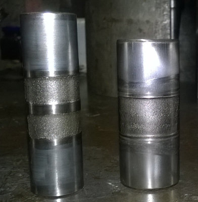

Postby Puffs » Thu Oct 03, 2019 12:29 pm
Just to show an example of small end failure, as my 251 had some 15-20 years ago. That damaged piston pin is shown here on the left:
Pins with wear.jpg (31.4 KiB) Viewed 710 times
The eye in the conrod had similar wear, but I can't show a pic of that.
The pin on the right is a big end pin of another bike.

Thanks Puffs for the infomation. The story continues, I decided that as I'm going to keep the bike for some considerable time I'd get it fully rebuilt by a professional. So I've taken it down to Martin Burwins who went though it with a fine tooth combe. The Big end had statred to remove its surface very much like the photos of your small end pin. The clutch had started to spin aon the shaft and there was quite a bit of wear to the various known gearbox slector parts. So i'm now happy that the engone is fine.
