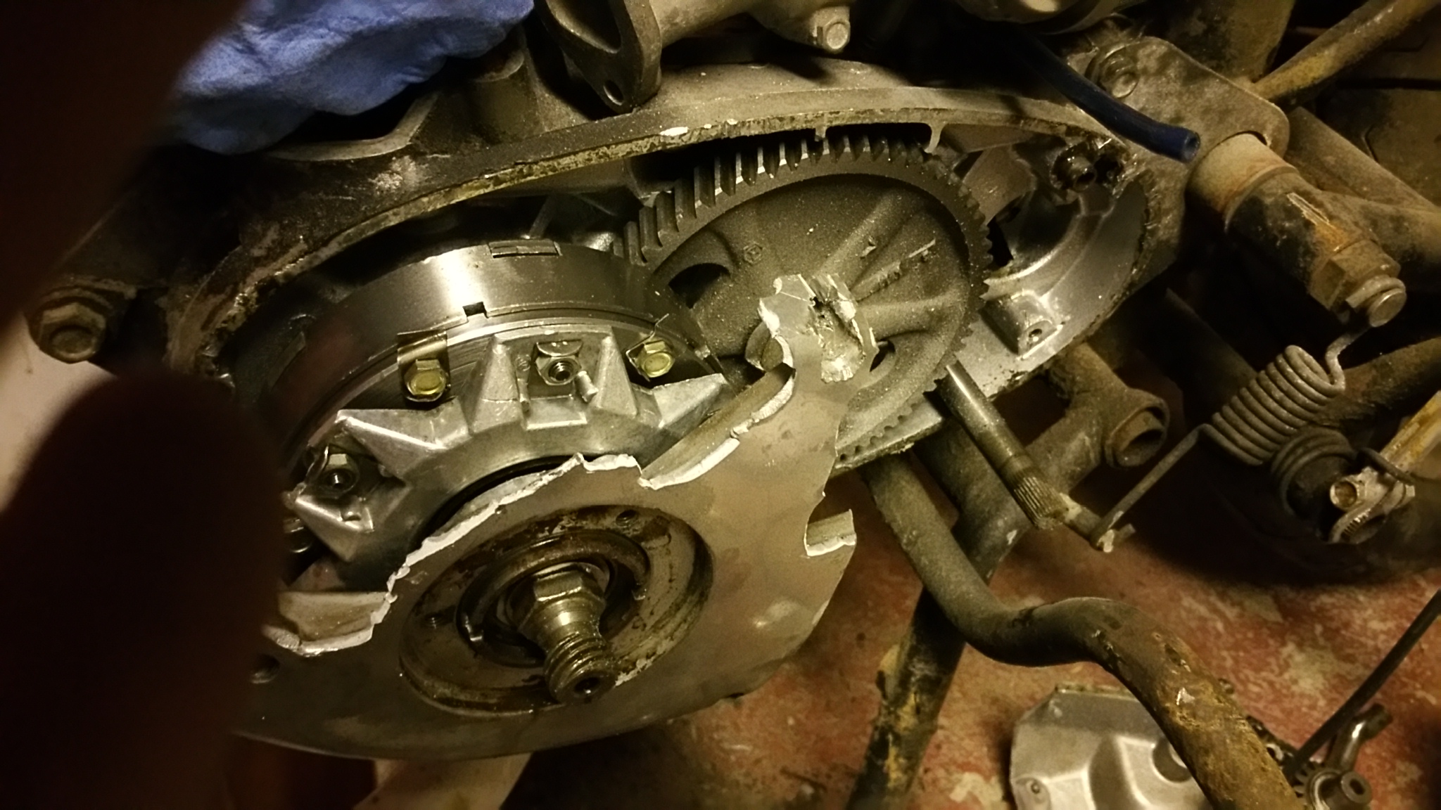

Postby therealche » Sat Feb 02, 2019 12:44 pm
At least you realised before it ended up like this!

Postby Puffs » Sun Feb 03, 2019 5:16 am
Ouch!
