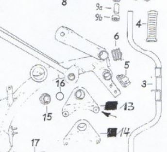

Postby Daniel_I » Wed Mar 14, 2018 2:52 am
Help requested:
MZ TS250/1 Centre Stand
The stand has a hose clamp affixed to the stand so that it doesn't hit the frame when it's down and standing. I bought the rubber stop to replace the bodgie hose clamp but do not know how to mount it. I think it gets mounted under the engine block... but I cannot see how.
Any help offered is gratefully received,
Many thanks,
Daniel

Can anybody show me photograph of the underside of a MZ TS250 or TS250/1 illustrating the rubber stops (preferably front and back) for the centre-stand. Many thanks.

Postby Guesi » Thu Mar 15, 2018 12:41 am
Hello
I cannot remember that there is a rubber on the TS 250.
There is a stop in the front:
https://www.guesi-motorradteile.de/inde ... 4/c/_/_/?_
made of Bakelite or plastic
and in the rear:
https://www.guesi-motorradteile.de/inde ... 9/c/_/_/?_
made of plastic.
But no rubber part....

Postby Daniel_I » Mon Mar 19, 2018 8:02 pm
Thanks Guesi.
If you can tell me how those stops are mounted, I'll buy them from you.

Postby Guesi » Tue Mar 20, 2018 7:51 am
You see it on the spare part catalogue picture...Nr. 5 and 6
