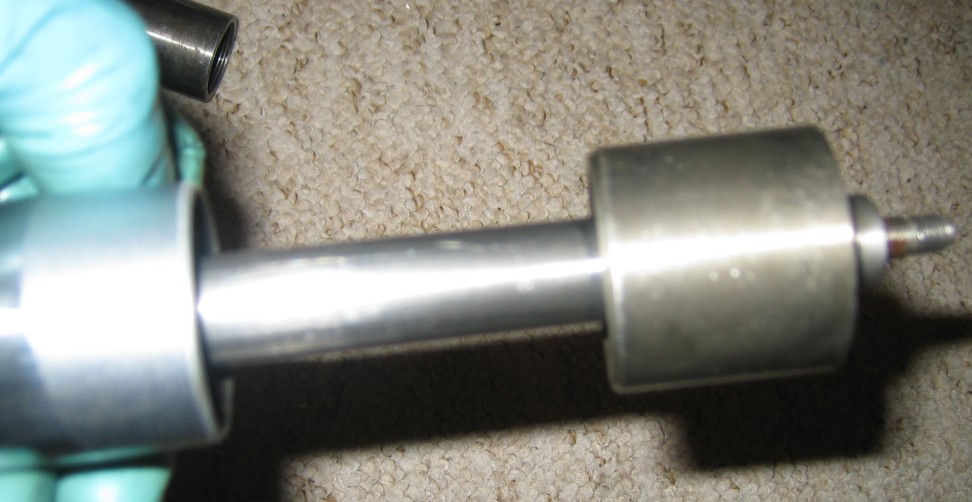

So, after playing with my knackered fork suspension units (see viewtopic.php?f=5&t=7789) and ordering a load of parts from Ost2rad, I found something even more puzzling. A wide bushing with a snap-ring and washer inside it! It shouldn't be there - these are 35mm forks, not the older 32mm version. The bushings came sliding out of the suspension sleeves when I up-ended them, but I don't have a clue why they're there, since none of the parts diagrams show them [see attached picture for where they were in the fork assemblies, and look at http://www.gabors-mz-laden.de/index.php ... 885d018/?_ for a parts diagram of the 35mm forks]
So now I'm really confused - did MZ do a half-way solution between the 32mm and 35mm fork versions, or has someone put 32mm components in my 35MM forks? Is that bushing needed if I have the 4-spring-and-two-washer arrangement on the end of the damping piston? WHAT IS GOING ON WITH MY SUSPENSION UNITS?!

Any photos would be _really_ appreciated - I'm really at a loss with this one, because with the bushes in I can't see how I can possibly install the final end-seal washer properly, or why the ends of my stanchions won't just smash into the bushings since there was no spring in there when I took 'em to bits. So confused :evil:
So yeah - a few photos, or even just a list of what parts and in what order you put them back into the forks would be great, thanks - I'd like to put them back on the bike before I change the front wheel bearings, which is the next job...

The main fork springs should stop any bottoming out of the forks. But if the ends of the upper tubes do descend that far they will make contact with the moveable bush which will then be forced against the bottom of the lower fork leg.
The lightweight 14mm spring holding the bush up against a machined lip is there to allow it to descend easily under braking and whenever the wheel hits any road irregularities.
As it descends it offers a less obstructed oil flow through the lower damping holes as the height of the walls of the bush surrounding the holes decrease, ie it's main purpose is to provide (a crude form of) variable damping.
If you first assemble the oil valve positioned at the bottom of the upper fork then insert the damping rod and then the 2ft long spring and turn the tube upright, the spring will keep the end of the rod in place and protruding out of the fork leg. Then place the large bush deepest section first onto the end of the rod, then the small 14mm? diameter spring and then the sealing washer. Then fit the lower fork leg over the lot and the threaded section of the rod should poke out the bottom to be secured with the Belleville washer and the 6mm nut.
