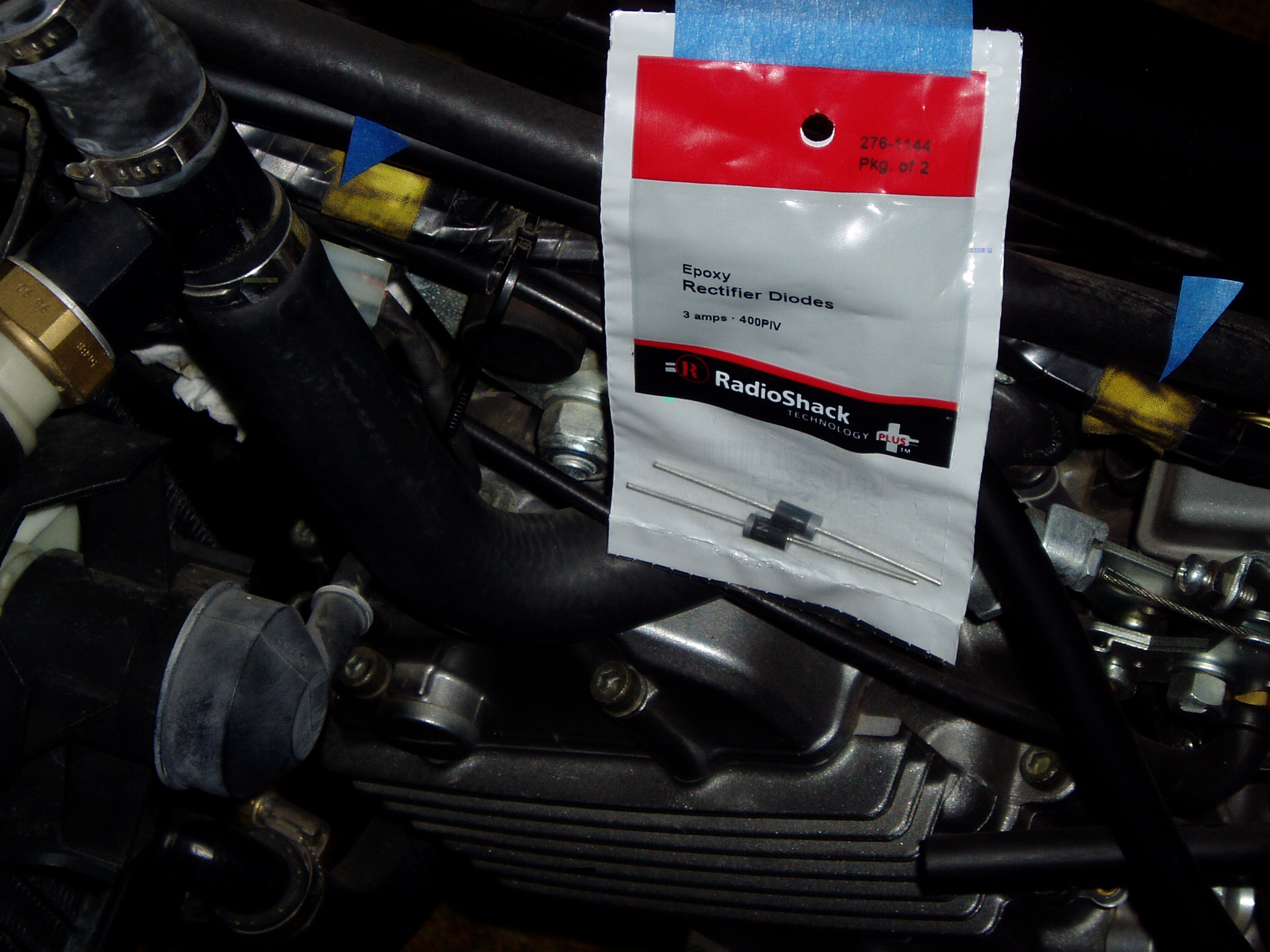

Postby OLDMTNCARVER » Mon Jul 30, 2012 11:30 pm
David,
Searching "Diode" I found a thread "Diode Failure" back in 2006 that mentions the location of diode(s) found by yellow tape marking their location along the frames main tube (Mastiff / Baghira).
Bill,
Thank you for the information I just got back from Radio Shack...
The schematics that I have for a Mastiff show three (3) diodes. I'd expect the third is in the same location at the steering head that Bill shows in his pictures.
I'm still at it... and learning... Thank you all for your help,
Robert

Re: BAGHIRA 15AMP FUSE
Postby hb7 » Mon Jul 30, 2012 11:45 pm
Where is the 3rd diode ? since you have the yellow tape......
I have never seen yellow tape on the Skorp....
hb7
Posts: 348
Location: Los Angeles
Postby OLDMTNCARVER » Tue Jul 31, 2012 12:51 am
When I mention three diodes, I'm looking at a schematic specific to the Mastiff. The diodes are numbered 30, 31 and 32.
I'm just betting that the Baghira is the same.
I used reading glasses and a magnifying glass as the schematic is all on one page and small type but the parts list for the Mastiff schematic is where I verify the numbers and that there are no more to be found.
David was kind enough to email me a schematic for the Skorpion Tour / Sport. When I look over it I only see two diodes and reviewing the part list for that schematic it shows only two diodes numbered 31 and 32, verifying that I haven't missed any there also.
As far as the yellow tape, ok...? Now I'm wondering what the white tape is for...
I'd rather not tear into the harness more than I have to. Like I said I'm learning.
