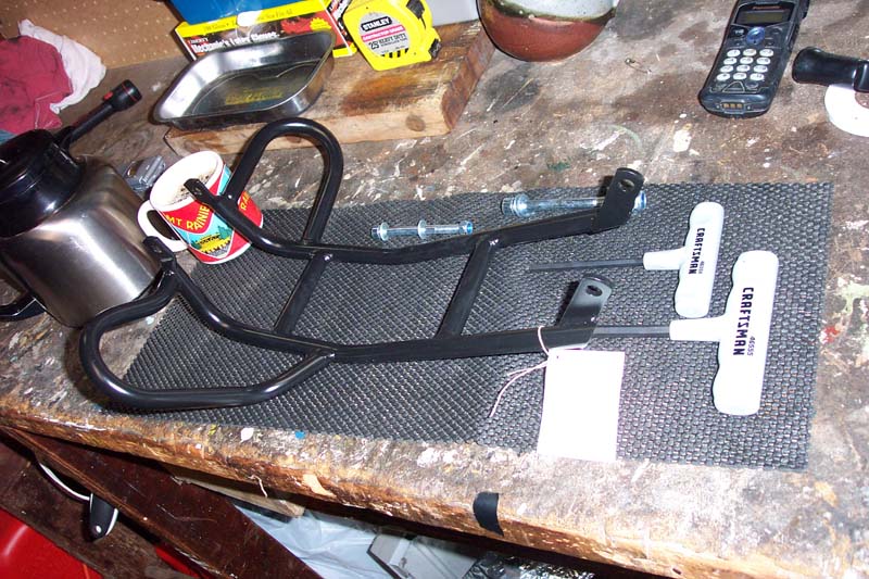

Postby RR » Tue Mar 15, 2005 10:51 pm
Here's the gear! Does that look like $200 worth? Those Germans like to get real paid, I guess. Nothing wrong with that.

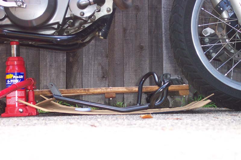

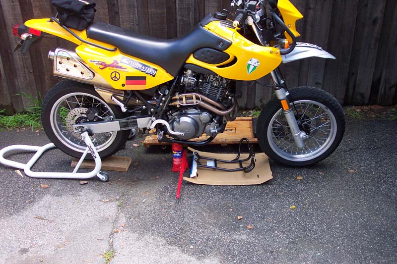

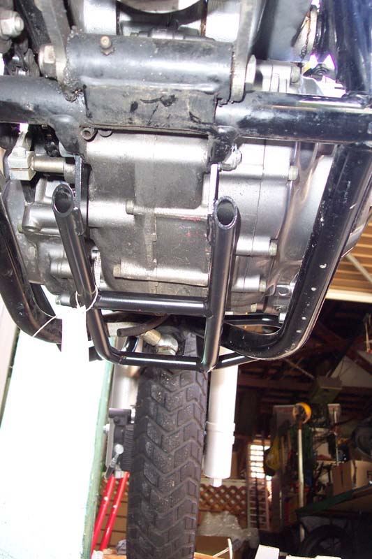

Postby RR » Tue Mar 15, 2005 10:56 pm
I don't suppose you have to brace the bottom, but I did. Didn't want to pull a bolt and have all that Yamaha iron fall on the ground. Note the little red jack.
RR

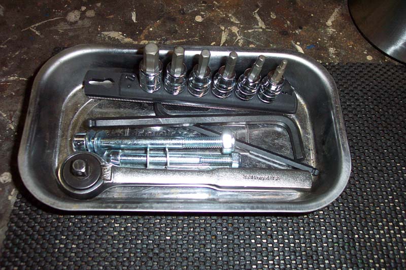

Postby RR » Tue Mar 15, 2005 11:02 pm
Ready to wrench.

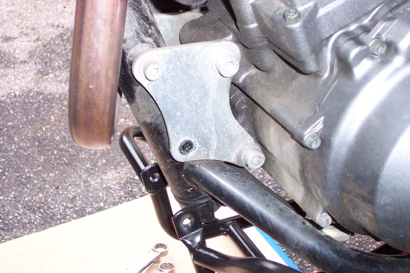

Postby RR » Tue Mar 15, 2005 11:05 pm
Get at the big back bolt through this opening.
RR
Posts: 41
Joined: Wed Aug 04, 2004 7:27 am
Location: SoCal
Postby RR » Tue Mar 15, 2005 11:10 pm
The smaller bolt goes in the lower and most frontest hole. Frontest is not an acceptable word for writing books and stuff, but it is perfectly appropriate for writing about motorcycle fix-ups on the Internet.
RR

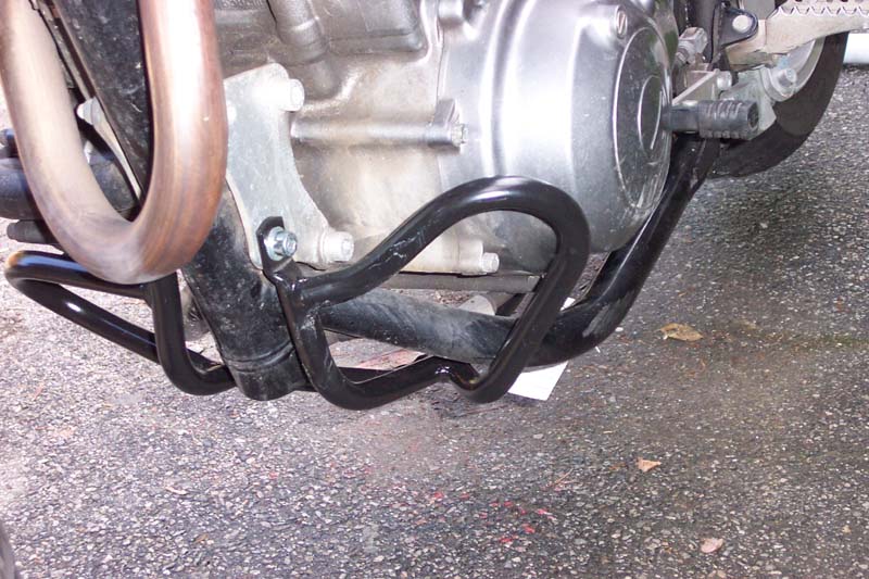

Now she's all hung up and cranked down. A few shots of the new piece follow.
As I said, it doesn't reach around too very far.
RR
Posts: 41
Location: SoCal
Engine Protection Bars for Baghira
Postby RR » Tue Mar 15, 2005 11:15 pm
The face is covered nicely.
RR
Posts: 41
Location: SoCal

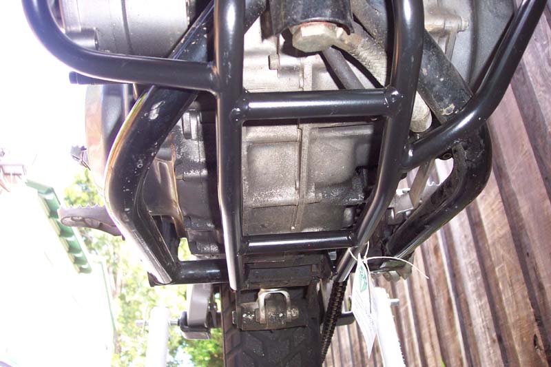

Postby RR » Tue Mar 15, 2005 11:16 pm
And the bottom.
RR

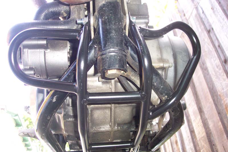

Postby RR » Tue Mar 15, 2005 11:21 pm
From the back bottom.
And I hope you all appreciate my crawling around on my belly on my day off for your entertainment.
The bias cut on the ends looks pretty cool. Not that anyone will ever see it without falling down near your bike.
