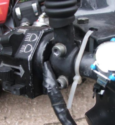

The size you need is M10 as this is the tread size, not the spanner size. as a rule a 6mm thread nut needs a 10mm spanner, a 10mm thread nut a 14mm spanner. Be aware however there are two pitch sizes for 10mm threads, 1.25. and 1.5, older MZ's used the coarser pitch. An easier option may be to fit a mirror clamp to the handlebars, if you check out the following link to bay you will find a type which will replace the rear part of your clutch lever boss. I have the same fitted to my etz 251. Just beware that its for the finer pitch, ie jap mirrors.http://www.ebay.co.uk/itm/Motorcycle-10mm-Thread-Mirror-Clamp-Fit-Back-Switch-2-Bolt-Fitment-/280855441160?pt=UK_Motorcycle_Parts&hash=item416449ef0

Replacement mirror boss on emzie
Here's the clamp I mentioned in my previous post in this string. Its an easier answer to the problem for most as it involves no thread cutting, its also a lot cheaper than buying a helicoil kit.
