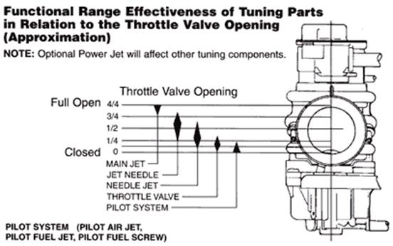

You know.. at full throttle the needle position does not come into play at all, see attached picture.
Its only jet size or as I suspect in this case the diaphragm swelling issue which affects 3/4 open or more.

Anders wrote:You know.. at full throttle the needle position does not come into play at all, see attached picture.
Hi Anders
Maybe thats why the carb was adjusted the way it was (incorrectly), so the bike would still run full throttle as the venturi wasn't fully opening? Looks like I'd better make that spacer up this weekend!
