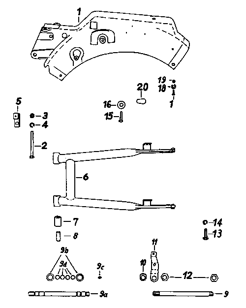

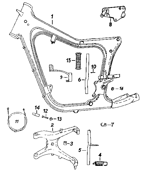

Postby manumensa » Sun Jan 24, 2010 8:58 am
Hello and wellcome
djsbriscoe wrote:Hi,
Have you got a photo to illustrate what you mean from the above quote. Is the wheel damaged in any way?
Thanks,
...or if not possible it, please, in this schemas
MZ TS.gif (5.79 KiB) Viewed 2043 times
