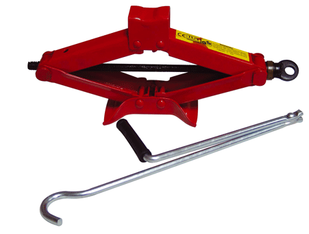

A old car-lift like picture help a lot; down the engine is unconfortable, it is a bit
heavy.

I did think about the jack, i have a small trolley jack that will help there.
