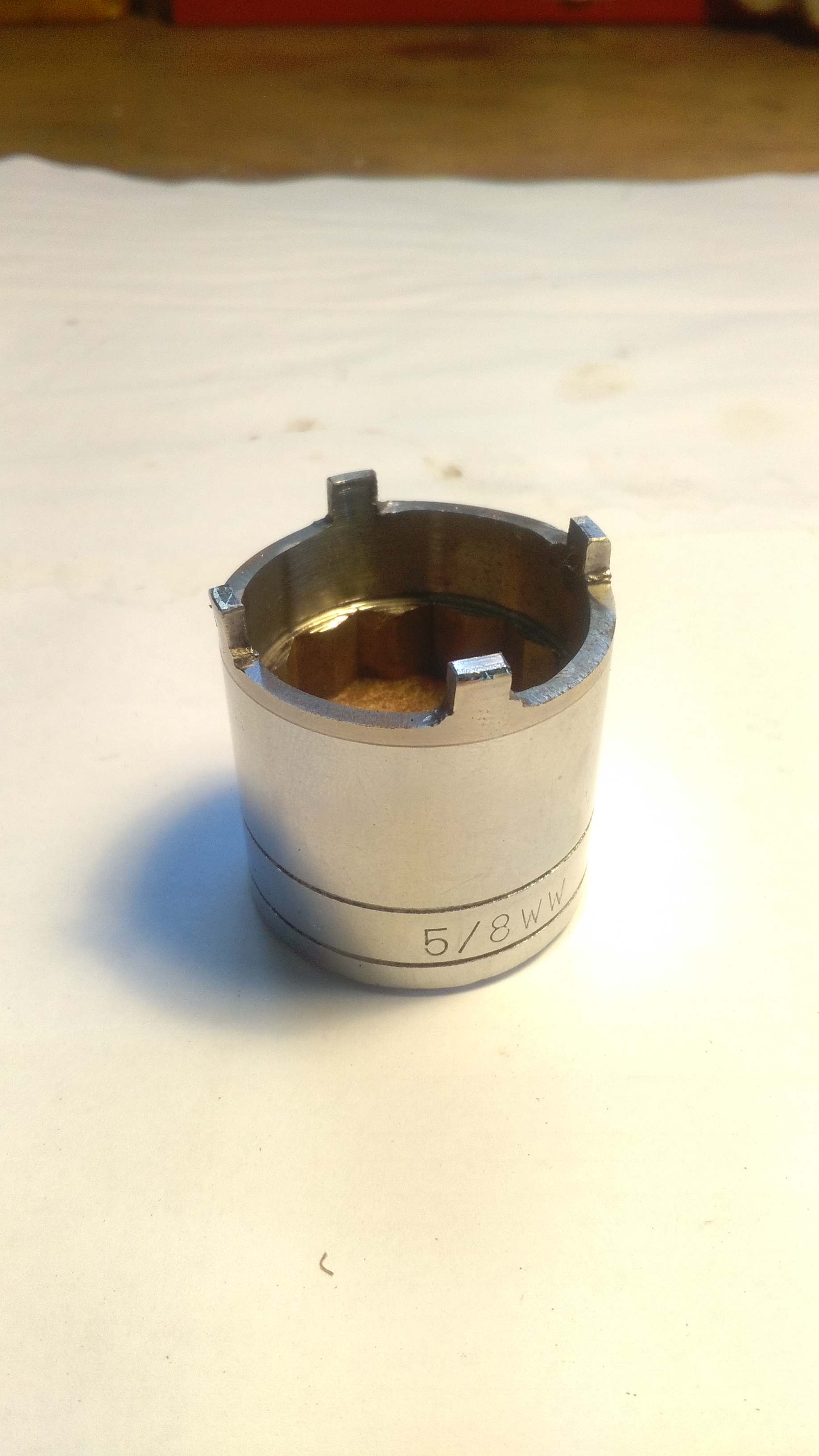

To get at the mechanism you need to remove the clutch. I made a special tool from a socket and used a rattle gun to remove the clutch nut/collar.

My gear return spring also broke at around 30,000 m. Grahams supplied a new one and I made up a clutch tool from an old socket. Thank god the selector operating system is outside the gearbox. Although the box on this machine can be removed in one piece if I remember rightly.

Can you tell me what you did to make the clutch tool or show a picture, I will buy a spring next time I am in Taunton.

33mm I'd is a critical measurement. Used a grinder and a miniature belt sander followed by hand file to finish. Hope this helps.

Thanks Shiny, I don't have access to a grinder at the moment but I might know someone who has. How thick are the teeth?

Postby DAVID THOMPSON » Sat Mar 19, 2016 7:08 pm
grind it slow so you do not get too hot and ruin the temper

The posts are approx 5mm wide with approx 20mm between them. Davids right, too much heat might result in the dogs failing due to the rapid power delivered by the rattle gun. It really is worth taking your time, trial fitting as you go.

That looks amazingly like a bicycle tool I used to have...don't have that bike any longer( and no idea where the tool wound up...it ain't in the box)
Park 4-prong freewheel tool
That one is only 32mm inside diameter, though.
