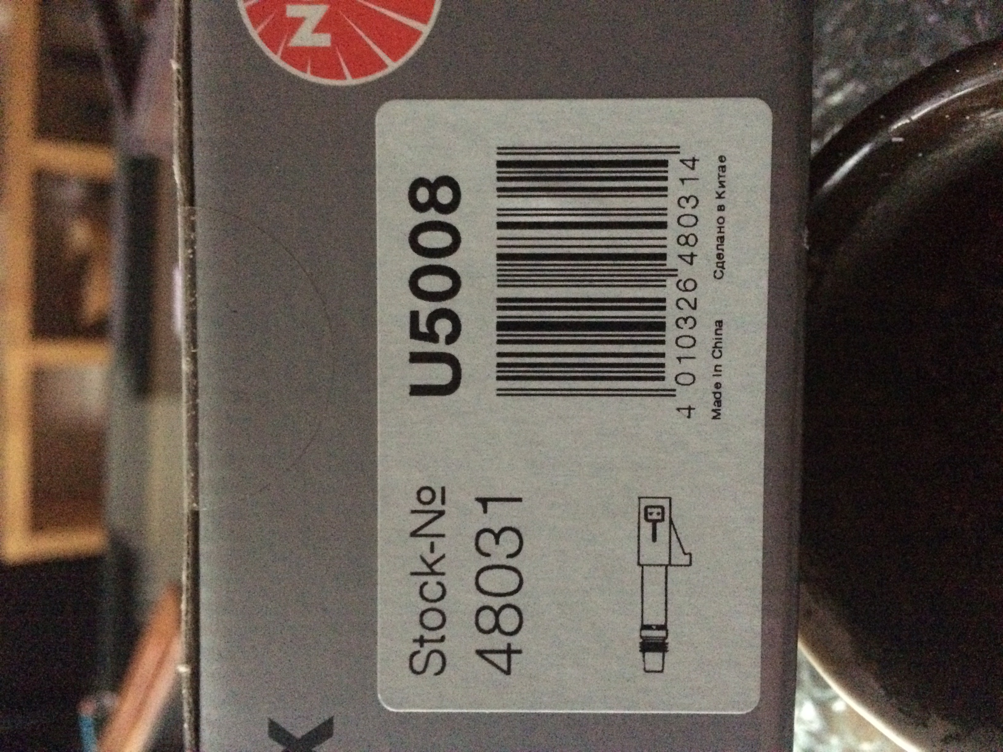

Postby silver MZ-1000s » Thu Jul 28, 2016 3:18 pm
NGK coils for MZ 1000 , cost without shipping around 27$

Postby Thorsten-aus-SO » Mon Aug 08, 2016 12:17 pm
@MJ310
Why so complicated ? They are offered at ebay in Germany, you can order from UK as well.
http://www.ebay.de/itm/NGK-Zundspule-48031-/191459305063?hash=item2c93dd2667:g:6qYAAOSwdWBXPC1a
And there will be customs union - as a member of the EU :-)

Postby Joe Cool » Sat Mar 11, 2017 8:28 am
MJ310, Would these be the ones I need?
http://www.ebay.com/itm/New-Premium-Ignition-Coil-For-Nissan-Renault-UF-653-C1560-8200380267-/161616658388
Would like to try the NGK's 48031 U 5008 if I can find them? Would these work as well?
