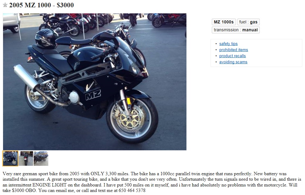

In addition to the wrecked MZ mentioned in another thread (http://sfbay.craigslist.org/sby/mcy/4914575846.html), there is this fine example currently for sale in Orange County, California:
http://orangecounty.craigslist.org/mcy/4897972743.html
It isn't perfect, but the mileage is low and the price seems right. We all know how rare these are in the US and this is the first black example I've seen in a very long time. I know these bikes score very well in terms of durability/reliability but what is their current state of parts availability? I'm not concerned with finding a local dealer willing to service it (I do all of my own repair and maintenance), but if parts are nonexistent or exorbitantly expensive, we have a problem.
Does anyone know how many of these (total) were imported/sold in the states?
And lastly... anyone in SoCal interested in inspecting this bike on my behalf? I live in Georgia and if another trustworthy enthusiast gives it the thumbs-up, I'll have it crated and shipped.

hi guys the bike from ST Clara CA was purchased by the owner of that stolen MZ 1000SF from Utah . it will serve as a parts bike to rebiult the one and only SF in USA :) BTW that Orange CO MZ 1000s have check engine light :) and the owner dst know what is causing it . i would stay away from this one . God know what is the problem and idt that any dealer or mechanic wants to touch that bike :) good luck with that purchase .

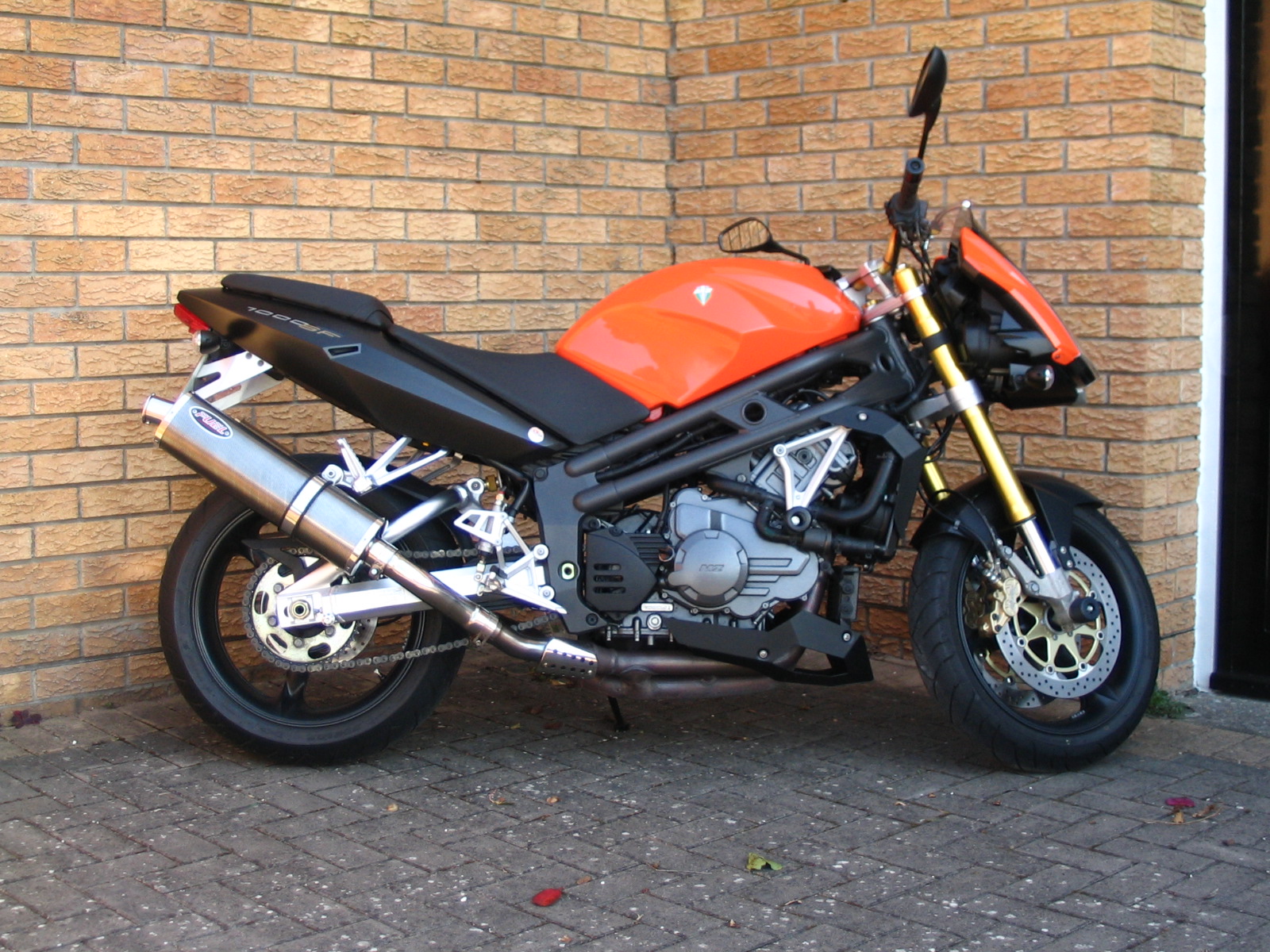

There were only 1566 1000cc bikes made in total, of them I have been able to account for the ones that came to the UK. 19 s models, 11 sf models and 8 st models. However I do know that a number have been sold off abroad and a couple have been crashed and a couple have been stored away so I think there are less than 5 sf's currently running about and I have an orange one. I do know of a silver s in as new condition and an st on the south coast with minor problems and a couple of sf's in wales and grahams of taunton have one. Here's mine and the set.
