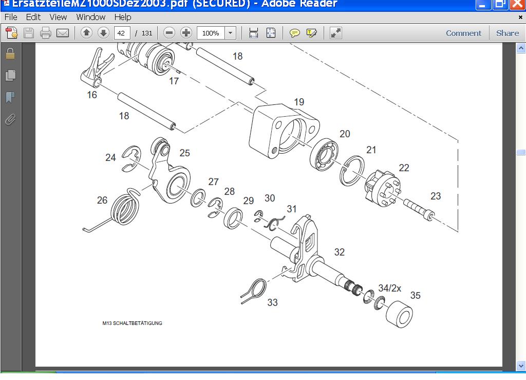

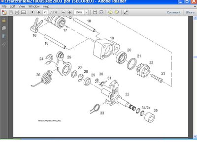

Postby DAVID THOMPSON » Wed Jun 08, 2011 10:30 pm
here is the picture and what is see commented on
in the next post below
save and print both posts its easier to read that way
Re: Trans lockout?
Postby DAVID THOMPSON » Wed Jun 08, 2011 10:50 pm
clip 30 can come loose spring 31 may break
spring 33 can break
a 1974 bmw has a spring almost the same as 31 that was known to break
and let a lever drop down and not shift
the pin wheel at 22 is similar to one in some other trans i have worked on
and it was what a lever worked against to make it shift if a spring in it broke it did not work
i think you have lost a spring at 31 33 or 26
the roller on item 25 may have came off
hope this helps i don,t think its more than bad springs
the one like # 33 i have replaced maybe a dozen times in mid 1970,s bmw 5 speeds
2 of them in my 1974 r90s # 33 may even be the same as the bmw spring

If the problem does lie with the spring that David is referring (and there is a very strong possibility that it does) to then you will find my previous posting (on this website) on the problem where the replacement sequence is outlined, including the manufacture of a special clutch drum removal tool. The spring itself can be purchased from Grahams here in UK. Be aware that the spring may not look broken but on dissasembly of the mechanism it will fall apart. You should also replace the clutch cover gasket following removal /replacing of the cover.

Sorry, I should have told you its spring No 33 in the drawing that usually breaks.
boilermaker
Posts: 370
Re: Trans lockout?
Postby iceman » Thu Jun 09, 2011 9:14 am
The line that spring 33 touches ,(that tab looks like the one that hangs up and breaks off) and comes out in the oil as has happened to two members.
