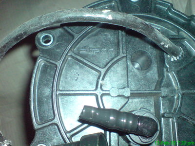

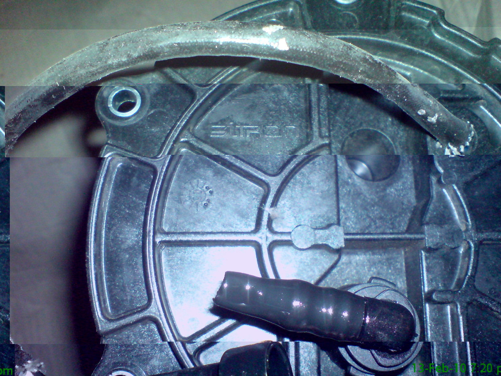

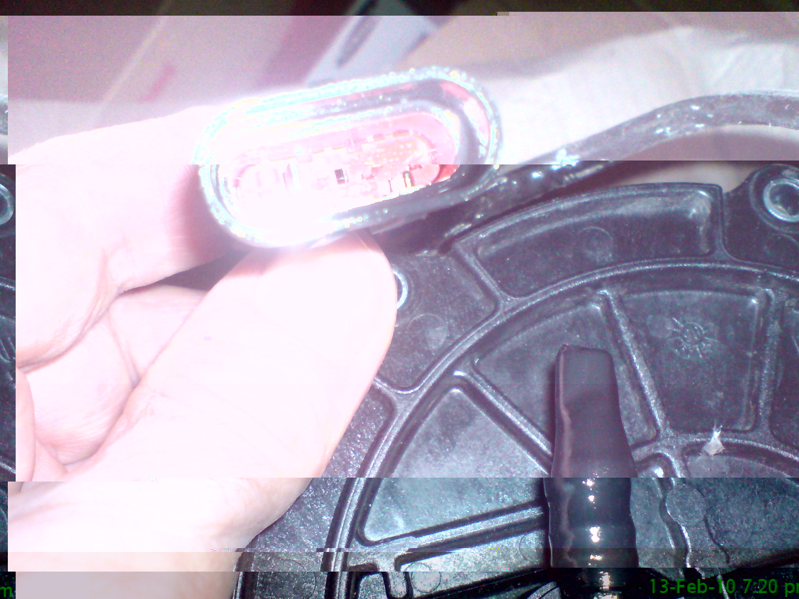

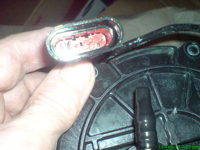

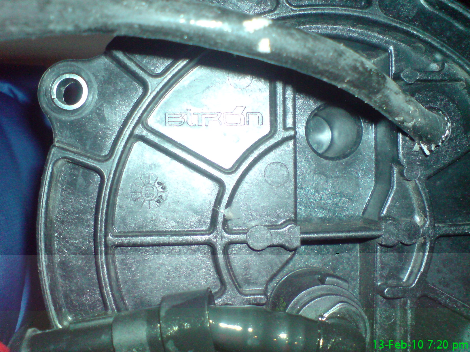

Postby boilermaker » Sat Feb 13, 2010 2:00 pm
Tom
Who makes the fuel pump assembly?

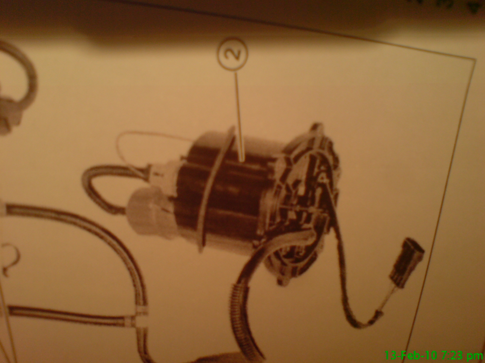

picture of original fuel pump from the mz manual
i'll try and take some clear pics using a better quality camera and replace some of the fuzzy ones above.
