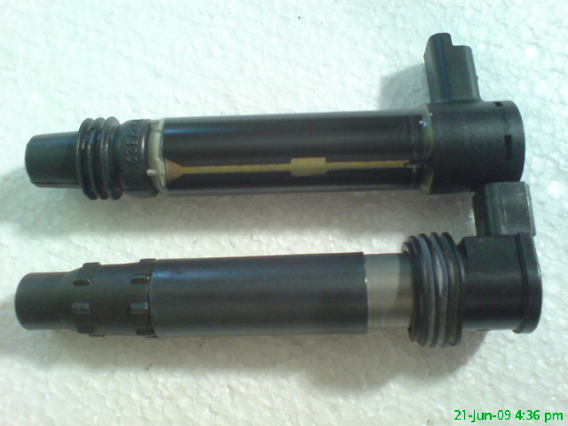

Postby tomtom » Sun Jun 21, 2009 12:48 pm
purchased three triumph 675 coils for just over £30 off a low mileage bike.
The coils are the same length as the mz ones, but the connector pins are different. I'm going to trace the coil wire back about a foot or so and put in a superseal connector so that i can either have a connector for the original coil or the triumph ones.
The original coil is sealed with an o ring in the head whilst the triumph has the standard ribbed silicone rubber sleeve. This sleeve needs to be pushed down the coil on the 675 coils and sealed with some heat resistant silicone so that it is fully sealed so that when its in the head it is sealing at the right height. If its too slack an o ring will be needed as per the original on the bike.
Obviously i've not tried firing up yet but if i get the chance i'll try and splice the wires
The ribbed lower "gaiter" on the original mz coil can probably be swapped onto the triumph one as they just pull off. Normally on bikes, these seals are at the top of the head not low down so that you get a pocket of water sitting above the seal as on the mz. No wonder there was moisture on the coil when i removed it.
the mz coil details stamped on top are as follows
21598394-3
JCI Now this is a diverse coil which was originally made by Sagem, which was taken over from Johson Controls International (JCI) which has now been engulfed by Valeo!!!PBTP-GF20 which equates to a sagem coil as used on a 2001 aprillia futura
try this link
http://motardsardechois.free.fr/Page%20Futura%20Technique/RST%20electricite/bobine%20allumage.pdf
for car replacement coils its in french with a english forum at the end but it appears you take the plastic housing off the car coil to get the bike coil pbtp-gf20 . Plenty of pics , worth a look as someone else has done the donkey work for us.
bottom coil 675 top original mz
