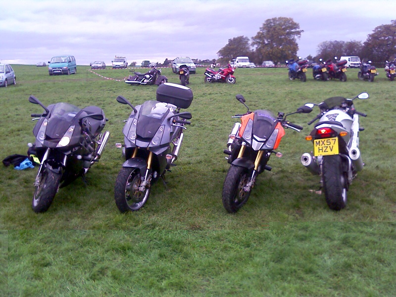

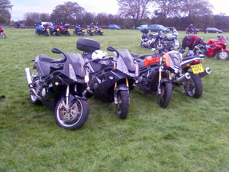

shame about factory visit and breakdown - hope it didn't spoil things too much. The Staffs show was pretty good and we managed to meet up with two other 1000 owners. As shown - the biggest gathering of MZ 1000's in this country so far. 2 1000s's, 1 1000ST and one 1000 SF !!!!! The bikes generated a lot of interest from onlookers. Great to meet you guys - next time lets see if we can get a larger gathering

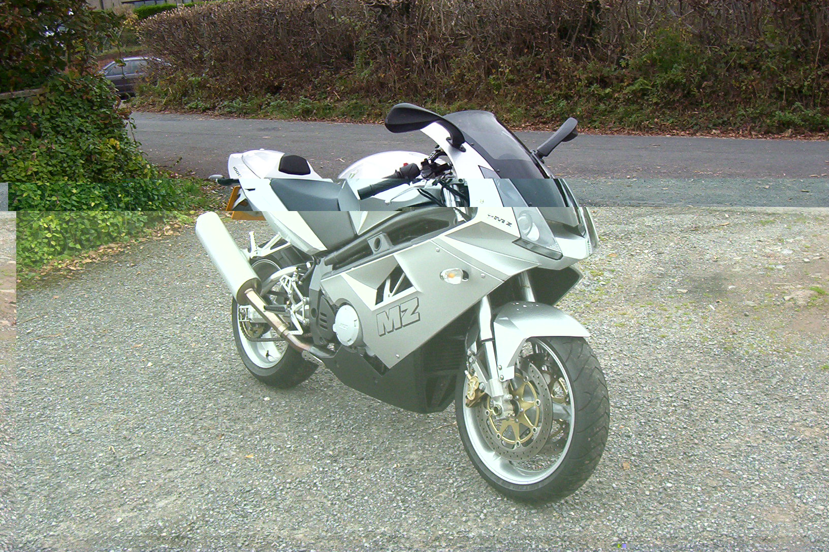

HOW MANY MILES WE ALL DONE, I ONLY DONE 4800 MILES JUST FLEW THROUGH 2ND MOT, NO PROBS,
ONLY EVER HAD ONE PROBLEM, INTERLOCK SWITCH BEHIND FAIRING STOPPED BIKE IN ITS TRACKS, THINKING OF SPRAYING 07 COLOURS AS PROB MZ MIGHT NOT BE AROUND NEXT YEAR, STILL THEY GOT 5 INTERESTED BIDDERS, BUT NO FIRM PROPOSALS ON TABLE AS OF LAST WEEK WHEN I WAS IN GERMANY,
BYE ANDY WALES
NOW 12 MZ IN MY LITTLE COLLECTION
