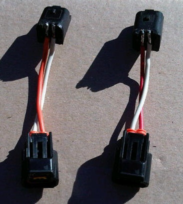

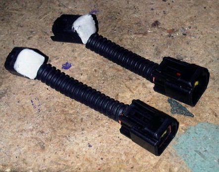

Postby Stephenonz » Sun Aug 07, 2011 11:12 pm
Hello all. I've done the Denso coil modification (finally). The Denso connectors came quickly from Corsa in the US (as per recommendation from Tomtom, htttp://www.corsa-technic.com/item.php? ... gory_id=55 and the 675 coils from the US were as cheap as chips.
I didn't want to cut the wiring loom so I made up some short leads using the Corsa connectors and the Valeo pencil coil connectors, which I cut off.
Pictures are attached, the first shows the soldering on the Velo connector and the second shows the epoxy covering the soldered wire and split flex.
I fitted the leads this morning and the bike fired up with no issues.
