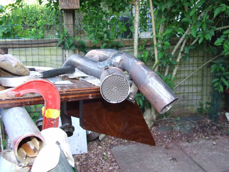

Postby tomtom » Sat Jun 06, 2009 12:14 pm
boilermakers pics
with cat removed
cat cut in halfshowing cat internals

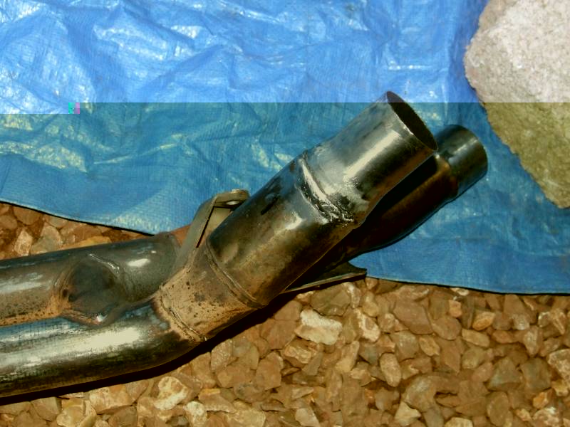

Postby boilermaker » Sat Jun 06, 2009 3:00 pm
Tom/ged
Thanks for uploading photos,
Ged The one photo that is not on this string (look in gallery) is the one showing you that the catalyst is in a length of straight pipe with reducing cones at both ends, so I did not cut the pipe in half but cut off one of the reducing cones (concentric/eccentric reducers in pipefitting parlance). If you make the cut as close as possible (or even through) the weld connecting the outer cone to the cat chamber you will have a fair thickness for the re-weld, and the cut will not go through the matrix (possibly causing toxic dust to arise) Although the reducer should be reasonably concentric on one cat, it is offset on the other, so it is imperative to witness mark the items before cutting. Use the thinnest slitting disc or narrow blade power hacksaw maintaining constant pressure throughout the cut (it is stainless). Then find a friend with a TIG set and some 316L filler wire and get him to weld the ends back on when you have removed ALL TRACES of the matrix.

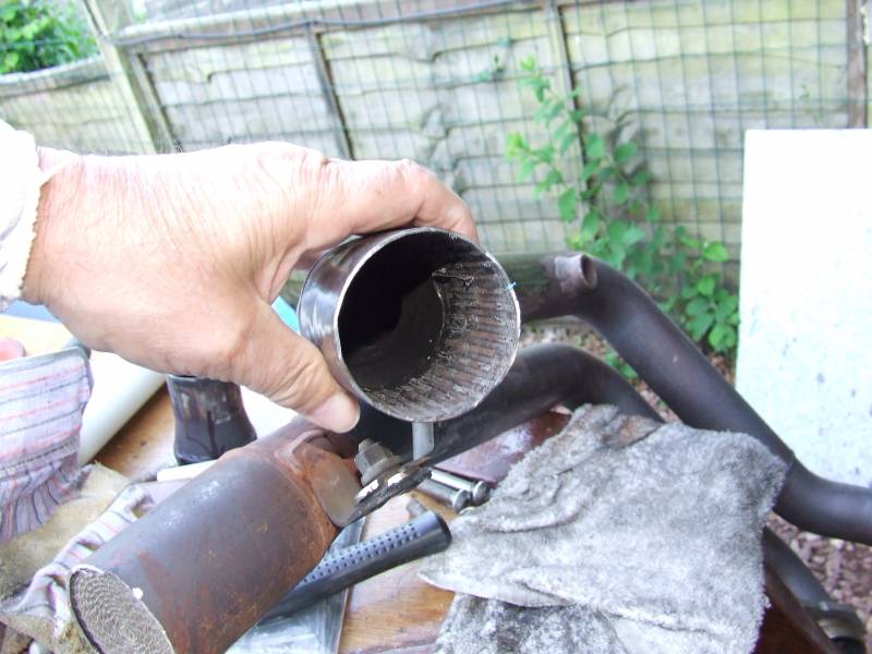

Postby tomtom » Sat Jun 06, 2009 3:20 pm
photo boilermaker refers to
You can buy stainless steel cutting discs for an angle grinder which are really thin at toolstation/screwfix
