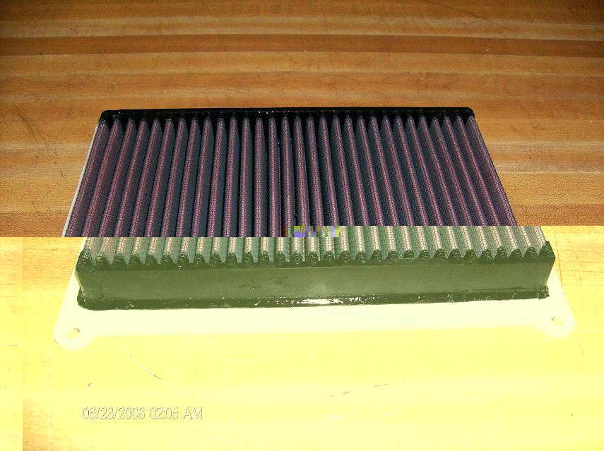

Postby LWS66 » Mon Jun 23, 2008 3:01 pm
Anybody wishing that there was a K&N filter for the MZ 1000 might find this as a possible homebrewed option. You'll need an old air filter, and a K&N air filter Part#33-2087 (this fits many late 90's Chrysler V6 engined vehicles (filter is available in the US and UK, I got mine from Advance Auto Parts for about $36 as all K&N's are on sale 25% off, it would have cost $48 otherwise)
You cut (hacksaw)the sides off of the old filter so your left with just the flat plate/base, clean the old filter material off of the inside edges, and clean up and roughen the flat surface.
You take the K&N filter, cut the big sealing ring/lip off, and then cut one end off along a pleat to the length of original filter you just cut off. The width and thickness of this K&N is the same as the OEM filter so it's a perfect fit otherwise. I used black silicone to adhere it to the base, the black bonding material on the K&N is silicone based and other adhesives would'nt stick to it, but it should be fine as is, we'll see.
It's a pretty easy mod overall, might be of some value to homebrewers? :-)

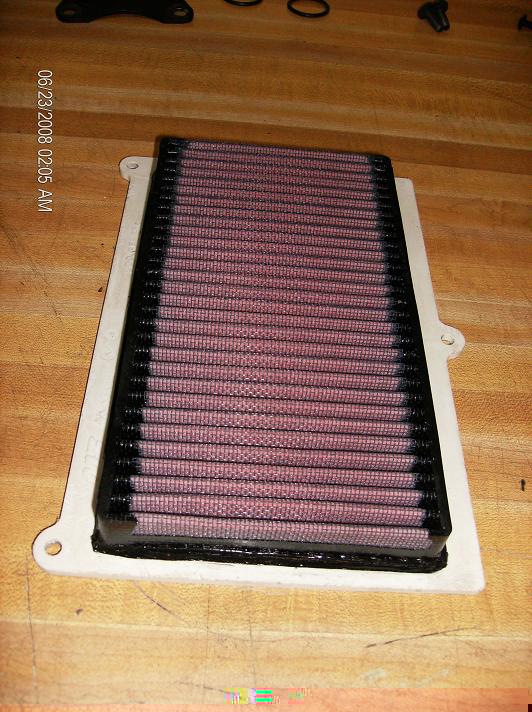

Postby LWS66 » Mon Jun 23, 2008 3:33 pm
Another one:

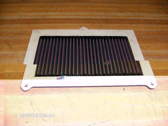

Postby LWS66 » Mon Jun 23, 2008 4:19 pm
Another

Postby tuxracer » Tue Jun 24, 2008 1:30 pm
That looks good, you'd think it came direct from the manufacturer. Are you still running the standard ecu map or are you using a PC111 or Tuneboy map? Have you had any clutch problems with your 1000S since you changed the exhuasts and filter?
I'm going to have my SF dynoed in the next week or so just to see what it puts out as standard. After that I've got some mods in mind to see what extra power can be had for little money and this filter should help a bit :D
I removed the filter lid and rigged up a temporary mount for the air temp sensor and it seemed noticeably quicker. The only problem was the clutch could not handle the extra power when it hit 7k, so I've ordered some heavier 1000S springs. Once I have them installed I'll modify the filter/air box and fit a modified standard exhaust system - no cats and hopefully no baffles if all goes well. Then back to the dyno to see what the difference is and check the fuelling.
I'll let you know how I get on.

Postby LWS66 » Tue Jun 24, 2008 6:56 pm
Tux,
I have'nt run it yet with the filter, had to get some foam tape today for the underside of the filter where it sits on the airbox. Will ride it to work tomorrow and see what my "Butt" dyno says. The thing runs great at the moment so I don't expect any major improvement, I'm setting expectations extremely low so I can be more objective? We'll see! At least I won't need anymore special ordered oEM air filters!
To date I've changed to Denso Iridium plugs, opened up the airbox cover, sync'd the throttle bodies (they were off a little), am running Engine Ice instead of standard gycol based coolant (runs at 4 bars on the gauge vs. 5 prior to changeover, even in sweltering heat down south) changed the gearing, and have the Sebring Twister exhaust w/baffles in (with them removed it was too lean, it seemed a little flat down low, with some hesitation when whacking the throttle full bore, really could'nt feel any difference in top end power, just louder, and there was popping on deceleration) Runs great with the baffles in and there's no popping/backfiring on deceleration, and a recent plug check revealed them to be at that fine line between lean/acceptable. I've been hesitant to buy a Power Commander because I don't want to muck about with the ECU, and, more importantly, based on the fact that there's no good info on suggested settings for it with various setups, such as what I've got, I'd have to flog the thing on a dyno to dial it in, something I'm not comfortable with now, it's a pretty "stonking" setup right now. As far as the Tuneboy or other options? I don't know enough about it, there's absolutely nothing available here in the states, as far as I know. Just hesitant to dick around with electric brain stuff! And I have'nt had any problems with my clutch, other than a cramping hand after looong rides! Looking forward to reading what your findings are! :smt006
