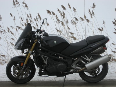

Postby tomtom » Tue Mar 30, 2010 6:43 pm
picture of icemans ram air ducting seen below nose fairing
doubleclick the pic to see better
