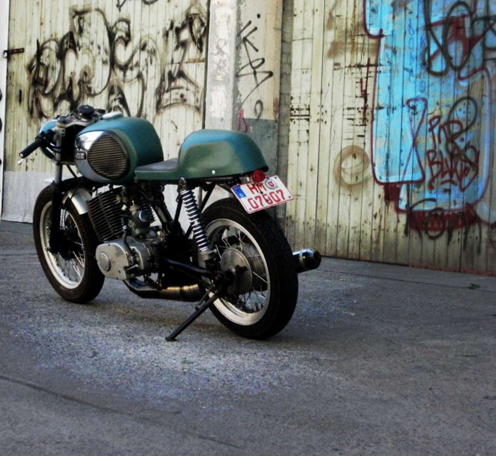

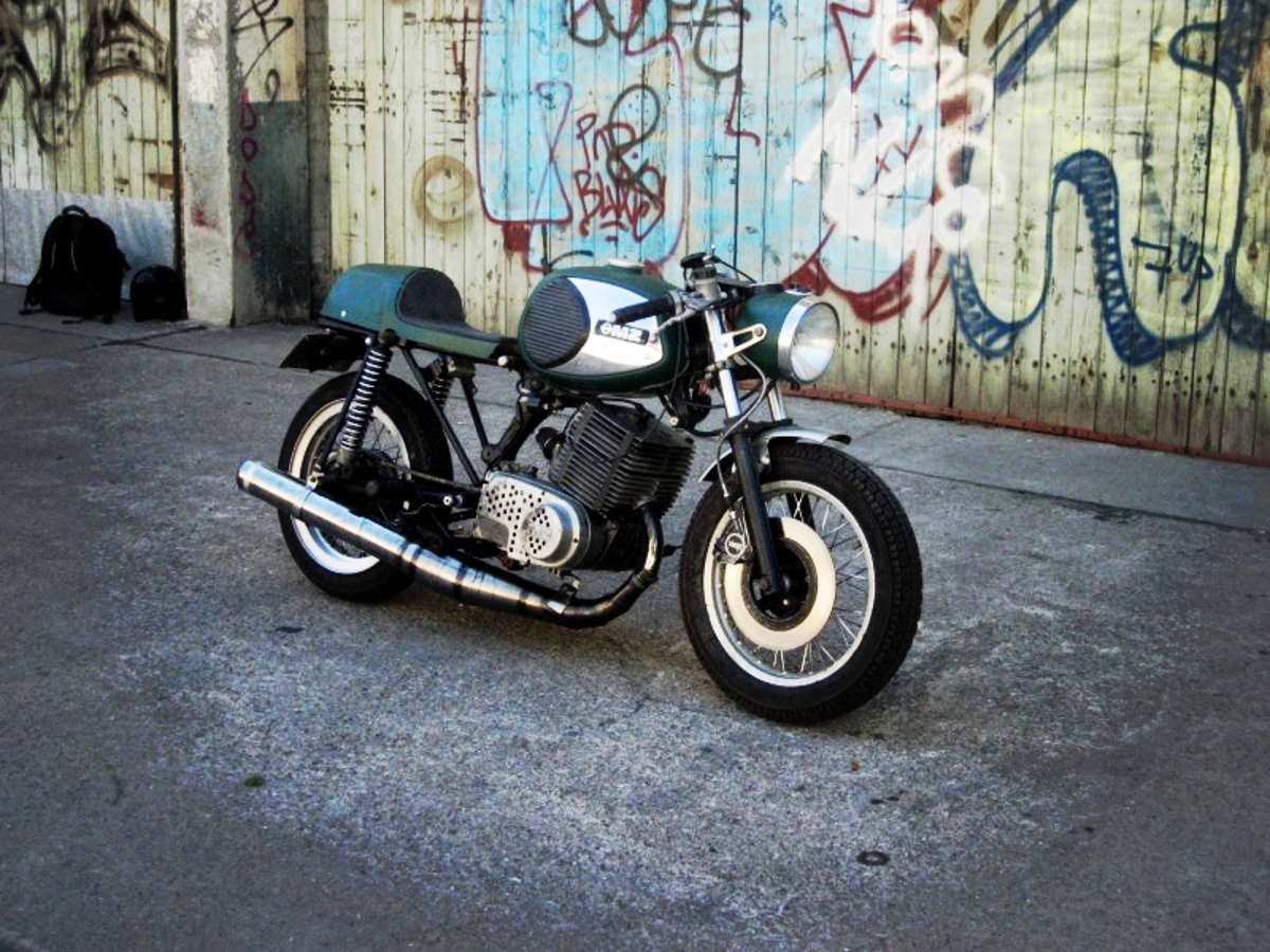

This is the look I would like to acheive

If anyone cares to have a chat.......... I have just been given an MZ TS 250 circa late 70's, as much as I like the quirkiness of the standard bike I feel that I want to make a 'Café Racer' from it as I have seen a one on Google that has caught my eye.
