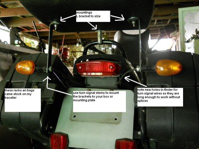

Hi everybody, I'm the new owner of a Skorpion Traveler 1998 bought with 3500 miles on the clock. I'm in the process of prepping it for a trip to Europe. I've just bought a Brembo caliper and master cylinder from a Mito, I should have looked at the photo more carefully it had three different types of bolt holding it together! Anyway I have a new seal set, pads and new bolts so it should all back together in a couple of days.
The question I have for any body who can help is regarding fixing points for a rear luggage rack I've bought, it is a Hepco Becker topbox with a mounting plate for a Moto Guzzi I intend to turn the plate into a rack and fix it to the Skorpion. What/where are the best fixing points on the the bike? It has the panniers and racks

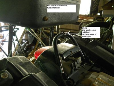

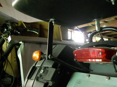

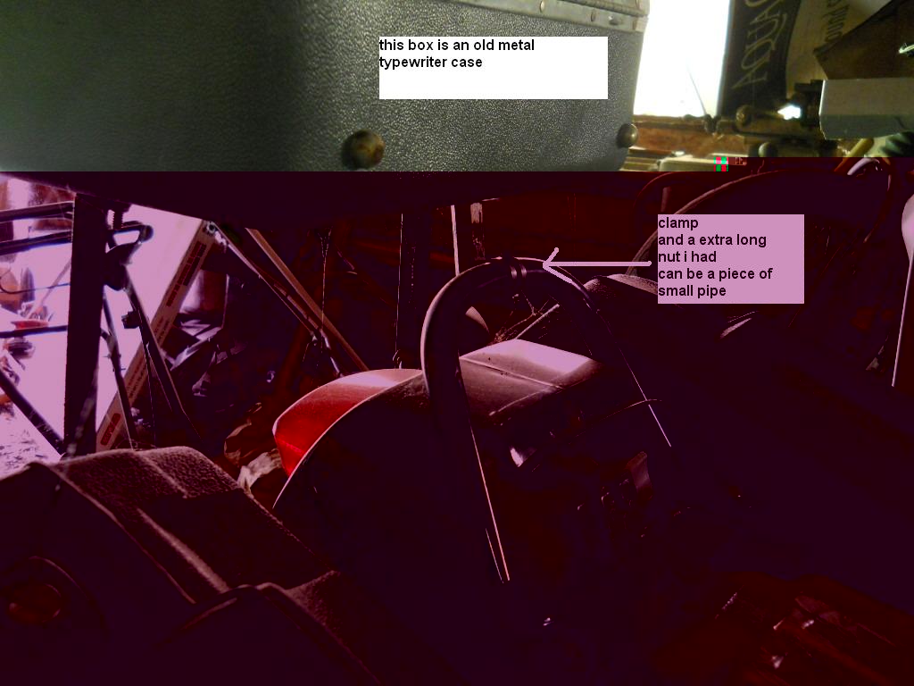

Postby DAVID THOMPSON » Sat Jul 27, 2013 12:40 pm
have a look at the typewriter case on mine
with oem bags and rack
as always click on picture for bigger view
turn signals are ktm duke about year 2000+/- a bit

Postby DAVID THOMPSON » Mon Jul 29, 2013 10:39 am
its fastened to the grab bar /seat rail at the rear of the seat
the picture i had did not have the seat installed
and the turn signals were replaced
it sets on the rack where the sigs install
one of the past owners had some real tiny signals on it
and they were falling apart
the ktm duke sigs work ok
