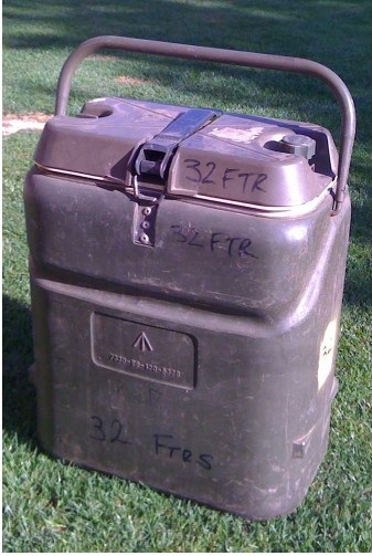

I have seen ex Army food boxes used as panniers. Known as 'Norgie Boxes' due to being first used by the Norwegian Army, these are used by the British Army for carrying food out to the field and are sold off through surplus shops.
Although they are referred to as '18 litres', they have a thick thermal liner, which if you cut it out would increase the capacity to around 35 litres. Completely waterproof with a snap down lid, they are very robust. There are videos on the Web of people running them over with military vehicles!
Supply is sometimes difficult and they vary a lot in price, but I found two suppliers: http://www.armysales.co.uk/field-catering-cooking-utensils/18-litre-norwegian-food-container-grade-b and http://www.ebay.co.uk/itm/18-Litre-Norwegian-Thermal-Food-Drinks-Container-EX-British-Army-Grade-C-SALE-/370737018425?pt=UK_Collectables_Militaria_LE&hash=item5651a5f639
