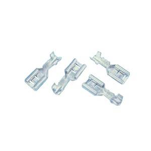

OMG--Dont ever use thos types of crimp connectors , You will set yourself up for a whole lot of trouble in the future,The problem with those are that they crimp rubbishly , sometimes cut the wire without you seeing , they let the water in and rot, they dont like too much amps,the fall off easily too , i would use thease all day long ( see photo below ),, you can see how well you have crimped them , you can also soulder them aswell to seal just inside the copper cable ,They will take a good amp load , you can applie a little silicone sealant when you pull the jacket on,,long winded but fool poof although jacket sold seperatly and more expensive there well worth the effort

I've used this type for years with Mac Tools crimpers and heat shrink and had no trouble at all.
