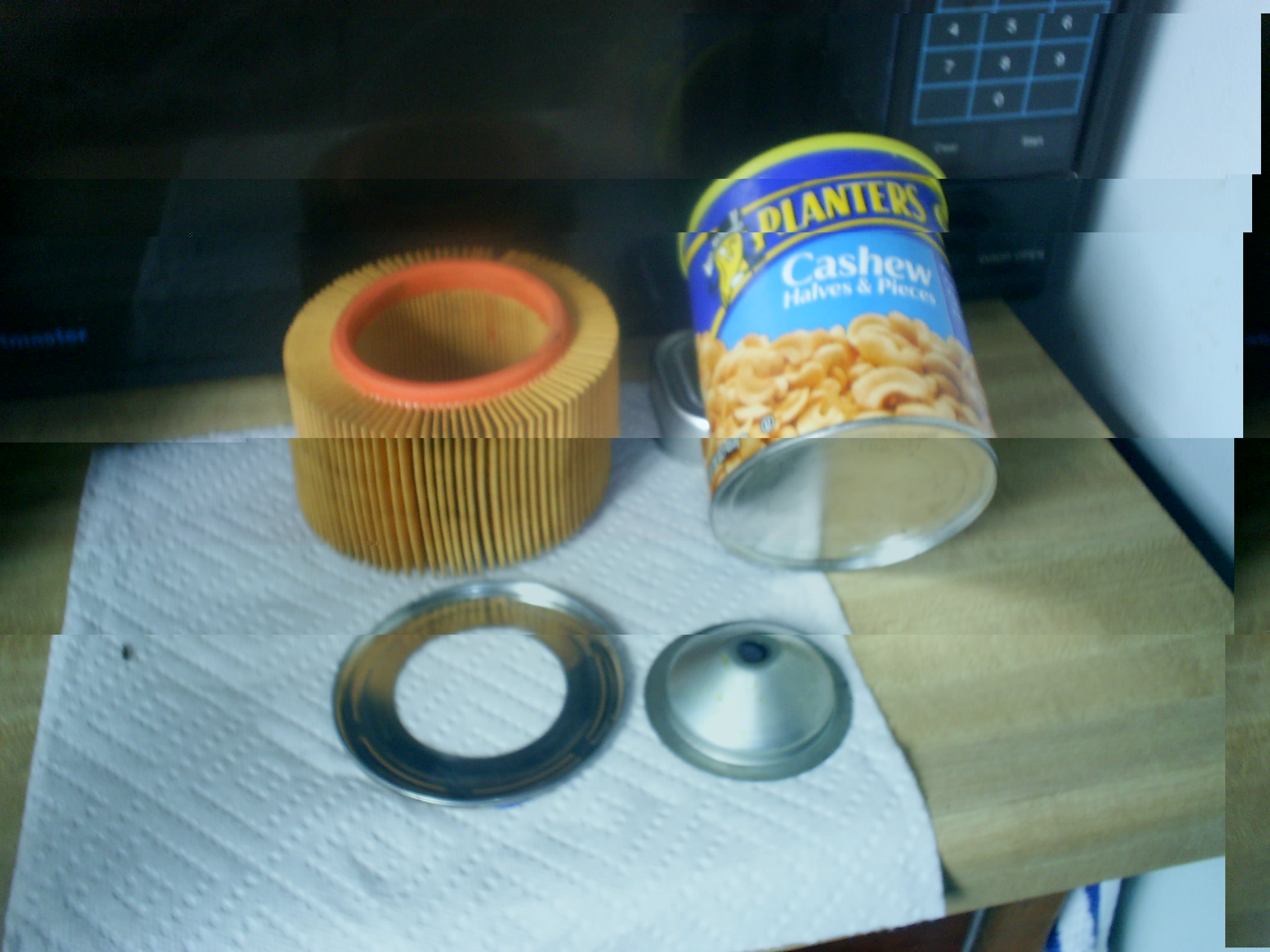

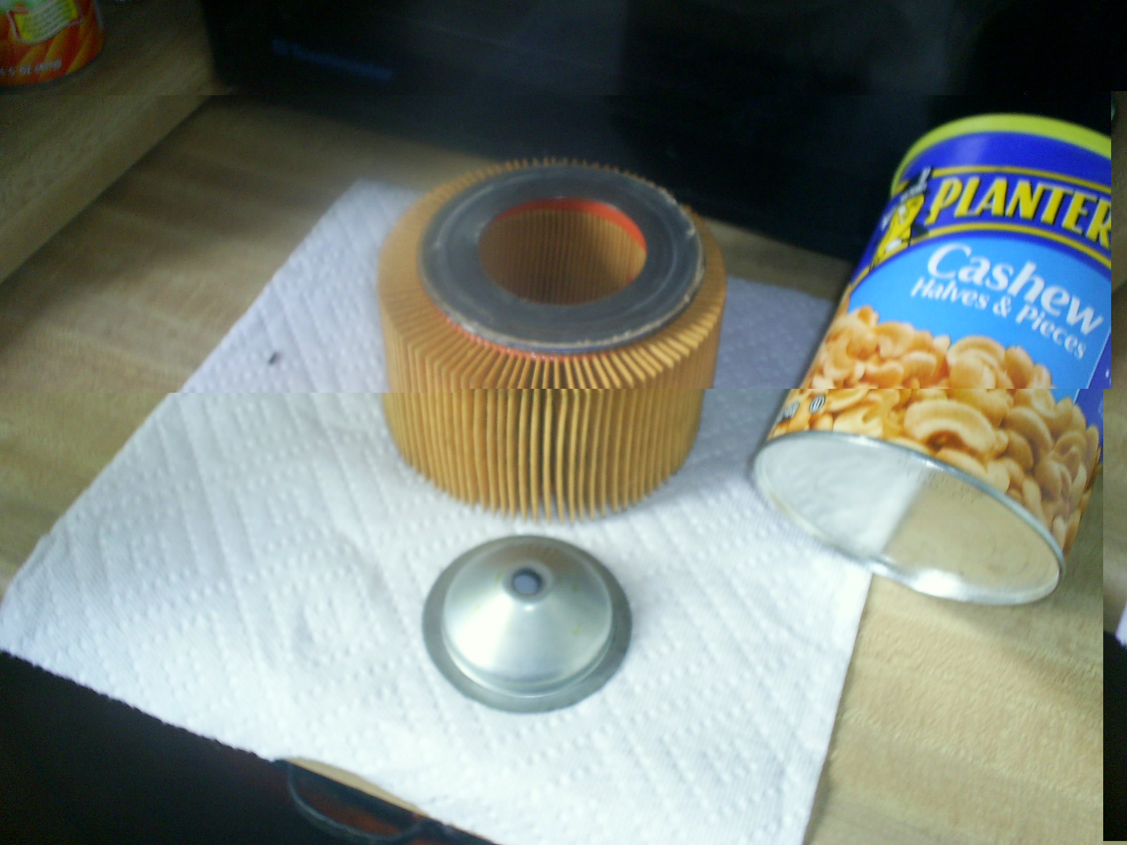

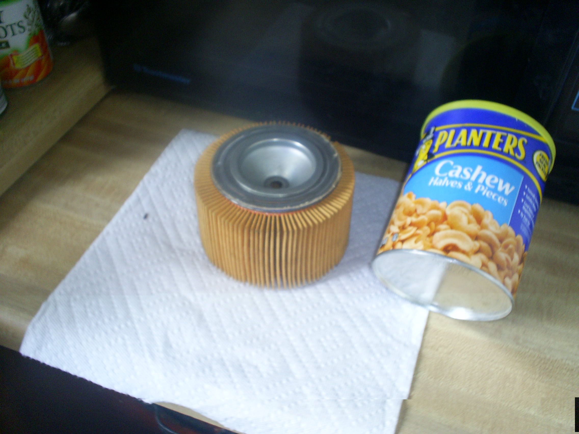

Postby DAVID THOMPSON » Thu Aug 20, 2009 12:16 pm
the filter adapter is made from planters can (wife is an avid planters peanut fan so lots of cans here..)
see pictures
click to see site crops them and there a bit dark till showing full size
read picture labels
better view just down load and use a photo viewer
ROTAX AIR AIR AIR AIR
cut a hole in bottom of peanut can i think it was 88mm i used a 3jaw chuck on my lathe
apply the can bottom lip edge down so it stays in place
add the factory ori holder and install filter

Postby comanche91 » Thu Aug 20, 2009 7:25 pm
Thanks David. Changed out the battery today and the airbox had a huge K&N filter stuffed into the airbox that was taller than the center screw, not anchored down, basically useless. Ordered a new K&N and made the plate similar to yours to secure it. I also found the seat wasn't secured into the two front clips and was held on by only one bolt in the back. Found a few skinned wires under the seat too. But it's getting there............. :D
