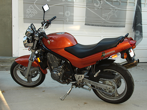

Hi Riders:
This summer I bought my first bike = 2001 Skorpion Tour. I am on it every day and I love it! ~58 MPG has been very nice for the budget. I am in the San Francisco Bay Area, a student at Stanford.
Thanks for this community.
While I am here: Everything on the bike is sweet except . . . the turn signals keep blowing the fuse!! - after about 10 minutes of riding and signaling after fuse is replaced (I have not done a scientific study, but I think it happens more when the the throttle is open to varying degrees and the clutch is engaged or bike is in neutral, causing a power surge?). I have had the mechanics look at it 3 times, but at $95/hour the money adds up and it hurts. . . they have replaced some wires in the signal lights, the turn signals themselves, and some other small stuff but the problem persists!!! I am upset with their service, I worry the problem is deeper, and they are too lazy to look into it. I am the 3rd owner, and the other two guys had the same problems and "lived with it".
** Anyone had this happen with this model, could tell me what is up? can recommend someone who can get to the bottom of this and repair for a starving student?

Postby Doc Strange » Tue Oct 07, 2008 3:34 pm
Can't help with the fuse lesson, but that's a tidy looking bike.
Have fun!
DS

Re: New Rider: `01 Skorpion Tour in CA
Postby el-mar » Tue Oct 07, 2008 7:51 pm
welcome to the club, and congrats to your nice looking bike

Postby J-Ball » Wed Oct 08, 2008 3:36 pm
Sweet ride. I often thought my bike (2000 Tour) would look sweet that very color. I had no idea they made it that color. Wow! Have fun on her, be safe.
