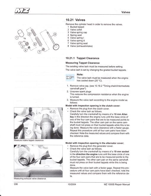

Dam,good to know they still have customer support. Stinky i bet Ducati shims would work,they work on Aprilias for the few guys who needed them and then did they as what feels like it,s ok to you at xx01 might feel just right to someone else.
Make sure the motor is cold when they do them as heat contracts and will make the valves seem loose when in fact if the motor were cold they would be right on.

Just to make sure everyone is clear on the valve setup on these things, the 1000 only uses buckets, no shims. They will be an MZ specific piece. You make adjustments swapping out to differnt thickness buckets, so there will be more work involved in removing the buckets: cams are raised up/removed so as to get to them.
