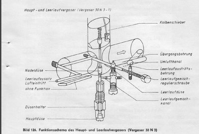

Assuming you have a 30 N 3 carb: Which tickler?
For idle speed, that carb has a bypass circuit:
Leerlauf 30N3-1.jpg (26.65 KiB) Viewed 1147 times

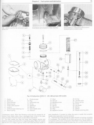

Adjustment is explained in section 9, page 77 of Haynes: ftp://blurredmanswebsite.ddns.net/Vehic ... es/077.jpg,
or the original (German) on page 66 of ftp://blurredmanswebsite.ddns.net/Vehic ... TZ-251.pdf
