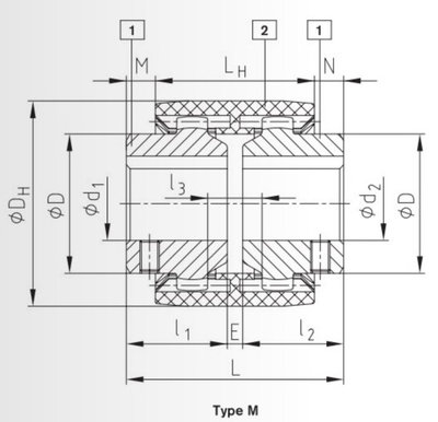

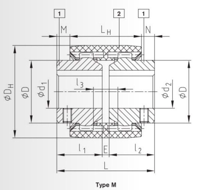

Yes, you mentioned the BoWex M-32 earlier, a curved-tooth gear coupling involving nylon parts: Image

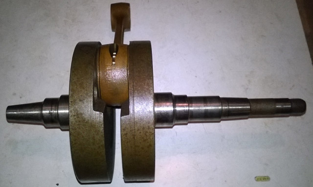

How you're going to fixate that to the crankshaft of an ETZ?
I guess you'd still be pressing & making parts.
A serious concern is that this coupling is rated to just 100°C, and rated for a load range of up to 180 Nm ( https://www.ktr.com//catalog/index.php? ... gy#page_92 ). Are you sure this is suitable? My fear would be that both the temperature range and the load range will be exceeded. I know that the torque specified for these engines is only about 27.4Nm (ETZ251), but that's an average value, point loads will be much higher. If you use a coupling like that, you would certainly have to use a 0° orientation, with combustion cycles in unison, but even so, I have my doubts if that joint will last long. Also because under full load those main bearings are likely to generate heat. But I'm not a mechanical engineer, so maybe I'm completely out of order. I hope you don't find me looking into this intrusive, otherwise just ignore me.

On bulky: the M32 has a length L=84mm, and an overall diameter DH=75mm (other info in the earlier link). With all the adapters, the coupling, bearings & seals in between, I suppose the big ends will be a fair distance apart. On the up side: then you don't have to take much off the cooling fins.
