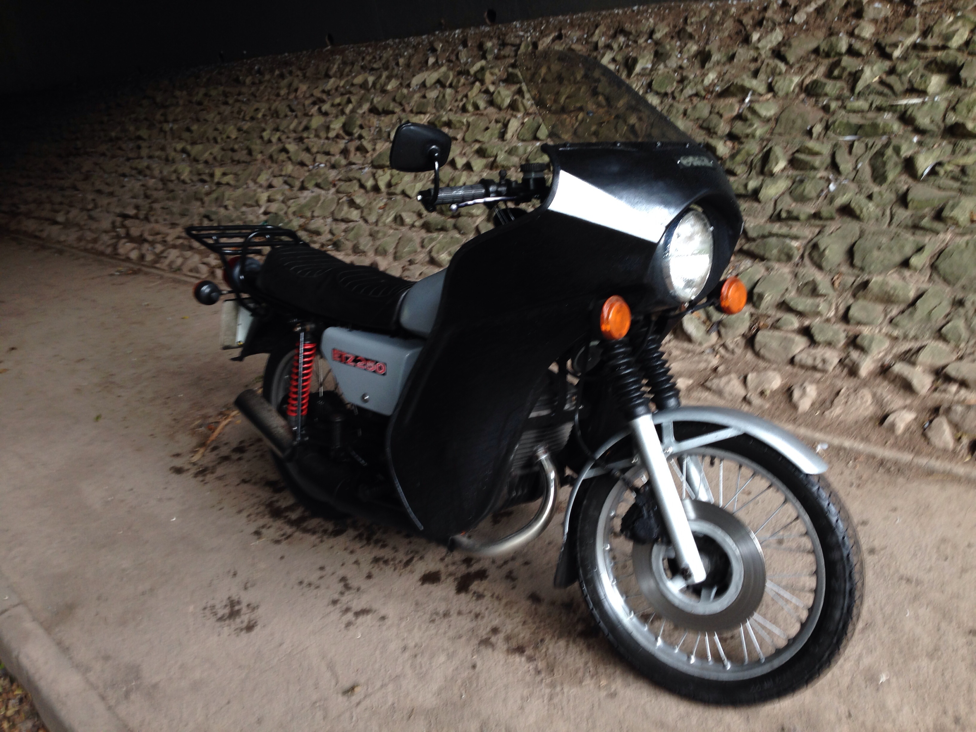

Postby Lpo90 » Sun Nov 03, 2013 11:47 am
Finally got take a pic or

Postby stogadog » Mon Nov 04, 2013 5:50 pm
That looks like it's in nice nick. Hope you get on with it OK!

Postby pmorris4562 » Tue Nov 05, 2013 3:51 am
Very smart looking ETZ. Enjoy.... :-D

Postby davegsm82 » Fri Nov 08, 2013 12:52 pm
Nice looking example that is.
I would only say one thing though, you really should ditch the 'power pipe' exhaust and get a proper ETZ250 one, I say proper one as the 'Generic' ones sold for the 250/251/301 is more suited to the 251/301 with the slightly higher rev range. The older, 'proper' 250 one sticks out past the rear wheel more than the later ones.
The 250 really won't be done any justice using that pipe. I had an almost identical one on my 125, it was abysmal so I took it off again.
Conversely, I had a 250 pipe on my 301, that gave it loads of low down torque compared to the original shorter 301 pipe. I think the shortening was more of a fashion thing than a mechanical decision.

Postby Lpo90 » Fri Nov 08, 2013 2:55 pm
Thanks Dave, yes the bike came with the original exhaust which is good condition but on the day a I collected the bike I completely forgot about it! So the seller is sending it to me by post at a cost, along with the bracket. Think the original will be a bit quieter to.
