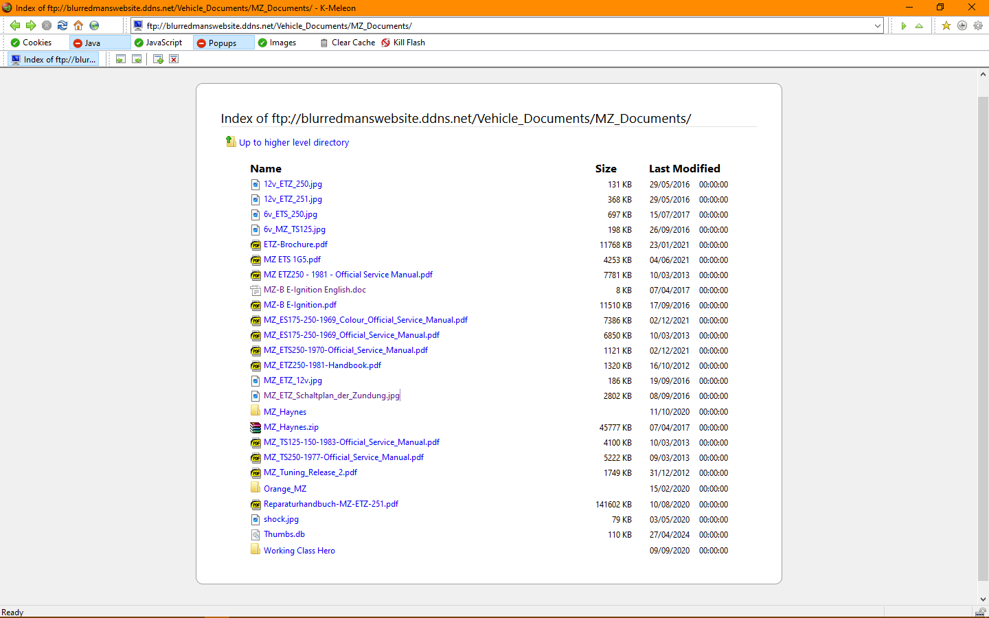

Postby Puffs » Sat May 24, 2025 4:26 am
Hi Det,
many modern browsers do no longer support FTP, you can access blurredman's FTP site with, for instance, K-Meleon Portable (try https://portableapps.com/apps/internet/ ... n-portable):
You want the ES manual, I do not know the difference between the 2.

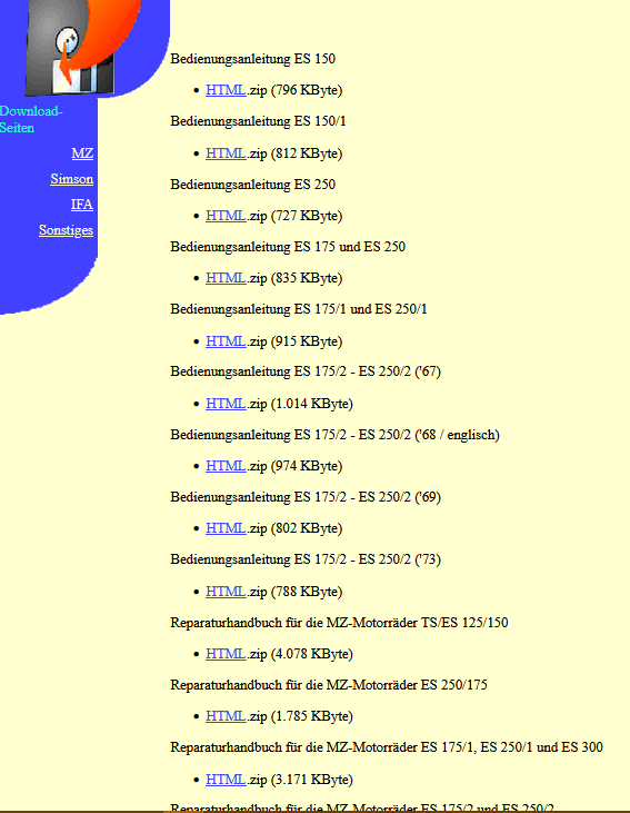

Miraculis has MUCH more, and these are the scanned original manuals, in HTML. You might be able to read them in English via a modern browser (the text, not the pics).
