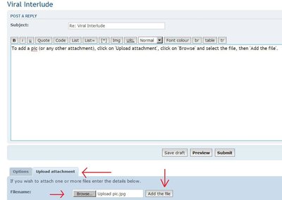

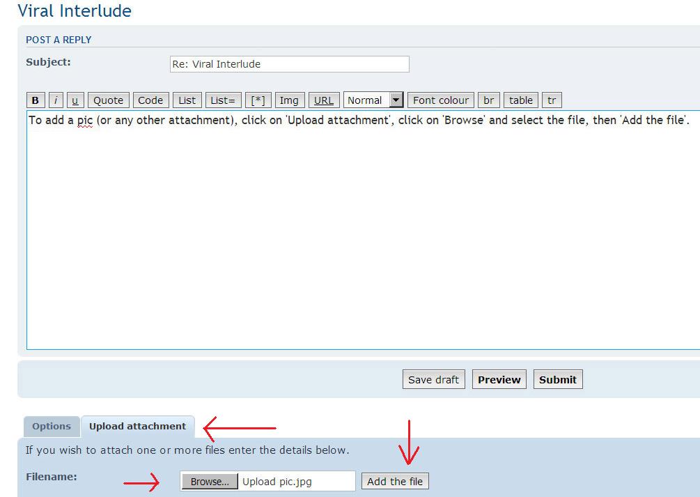

To add a pic (or any other attachment), click on 'Upload attachment', click on 'Browse' and select the file, then 'Add the file'.

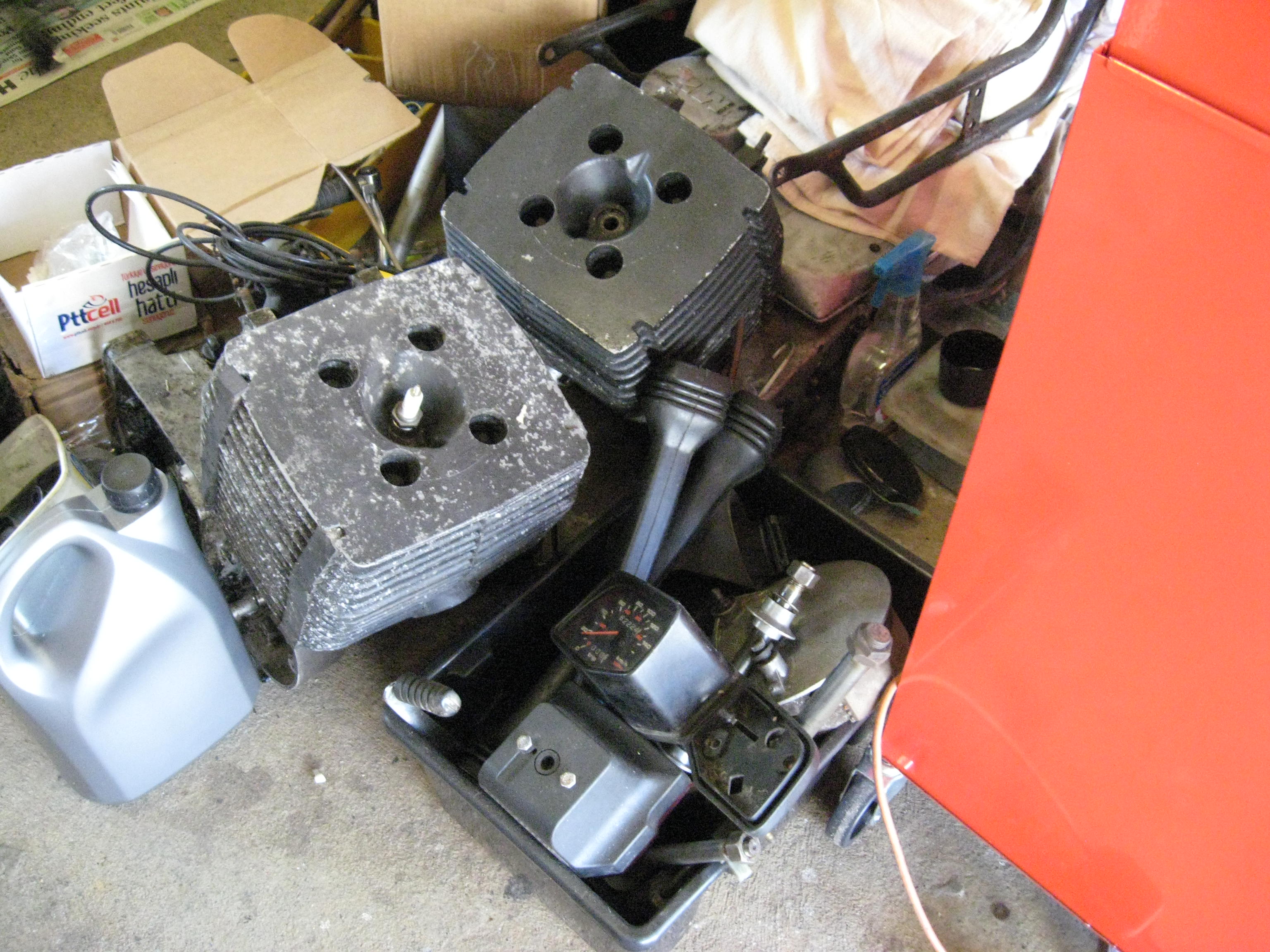

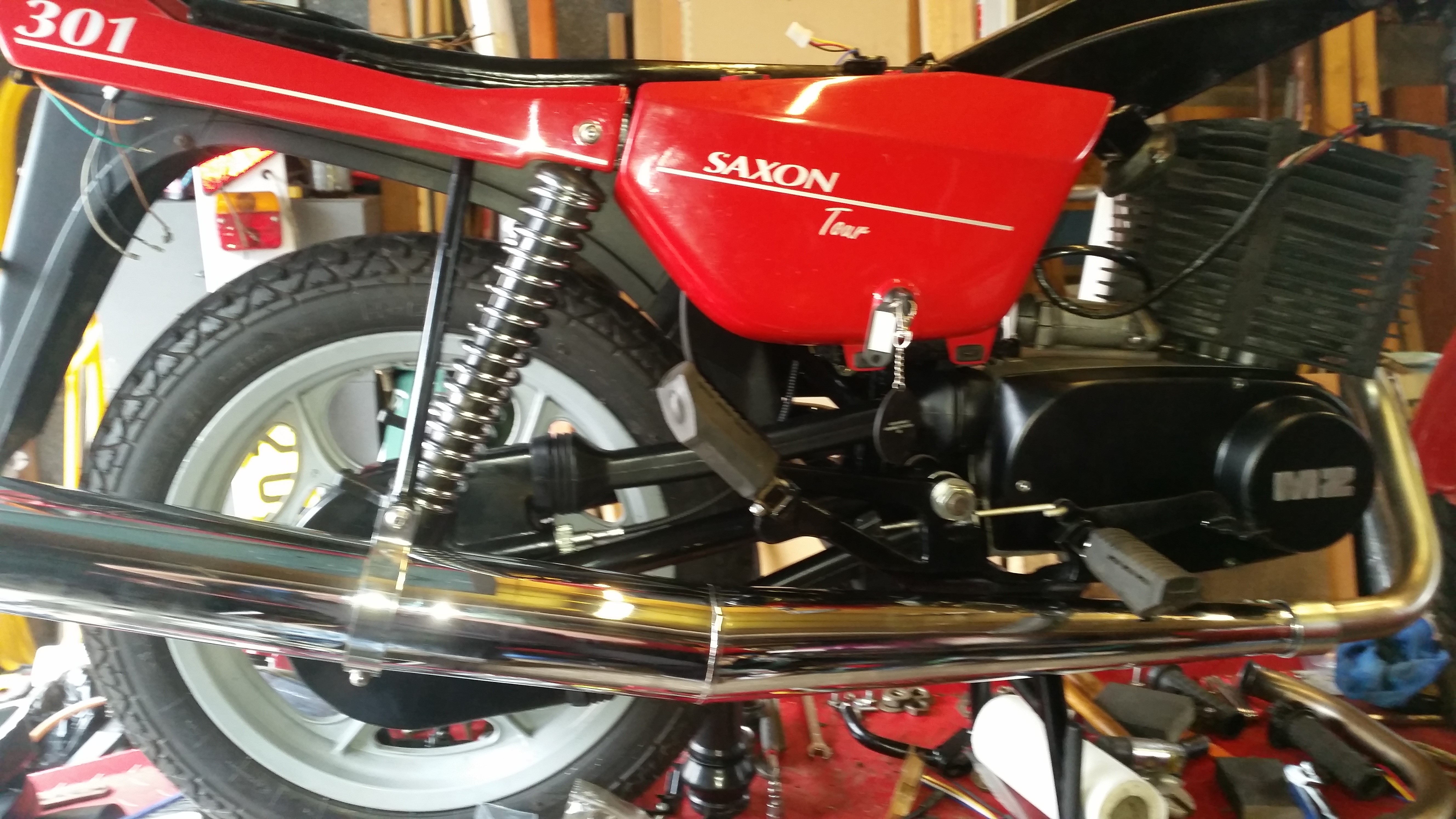

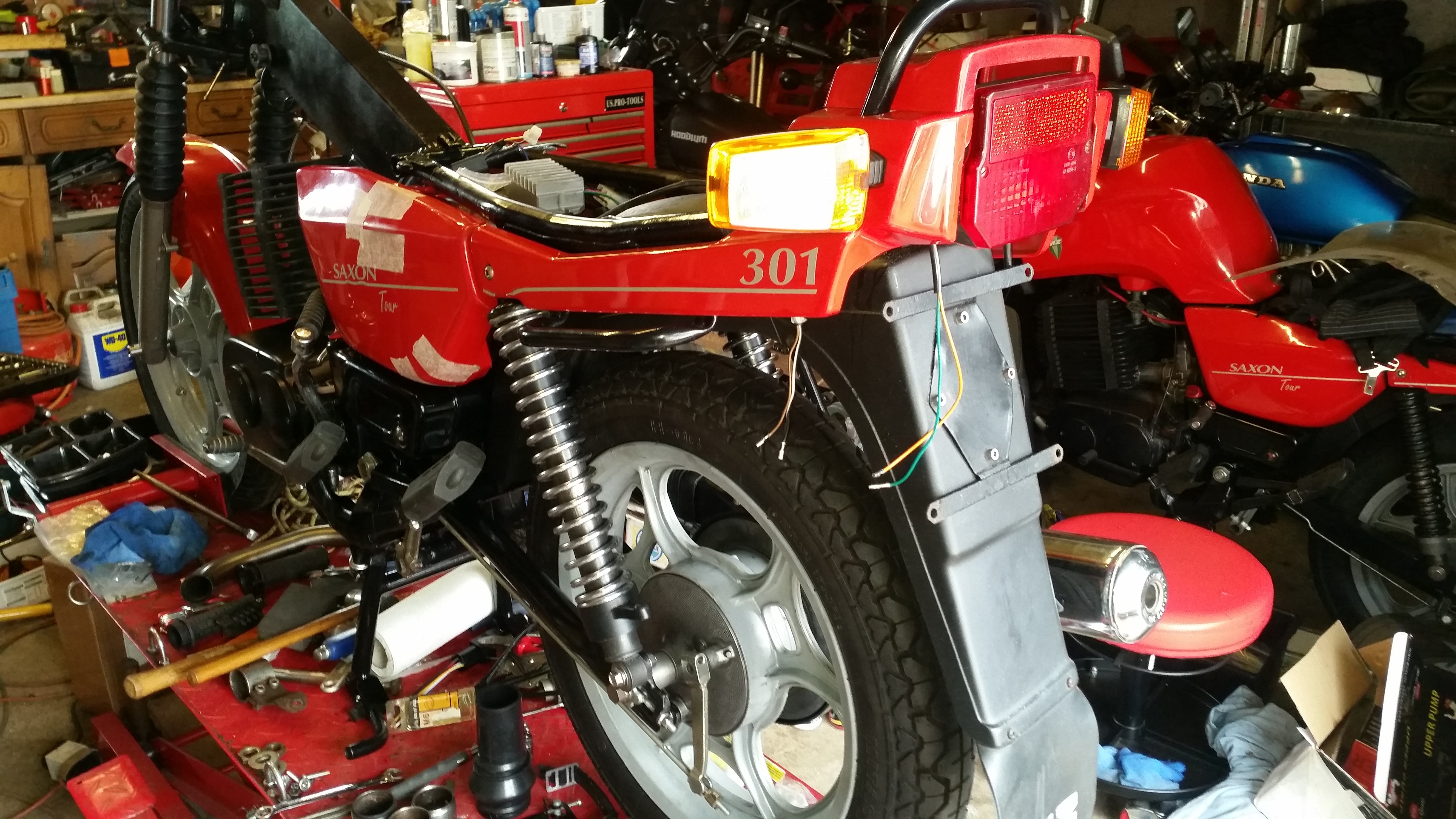

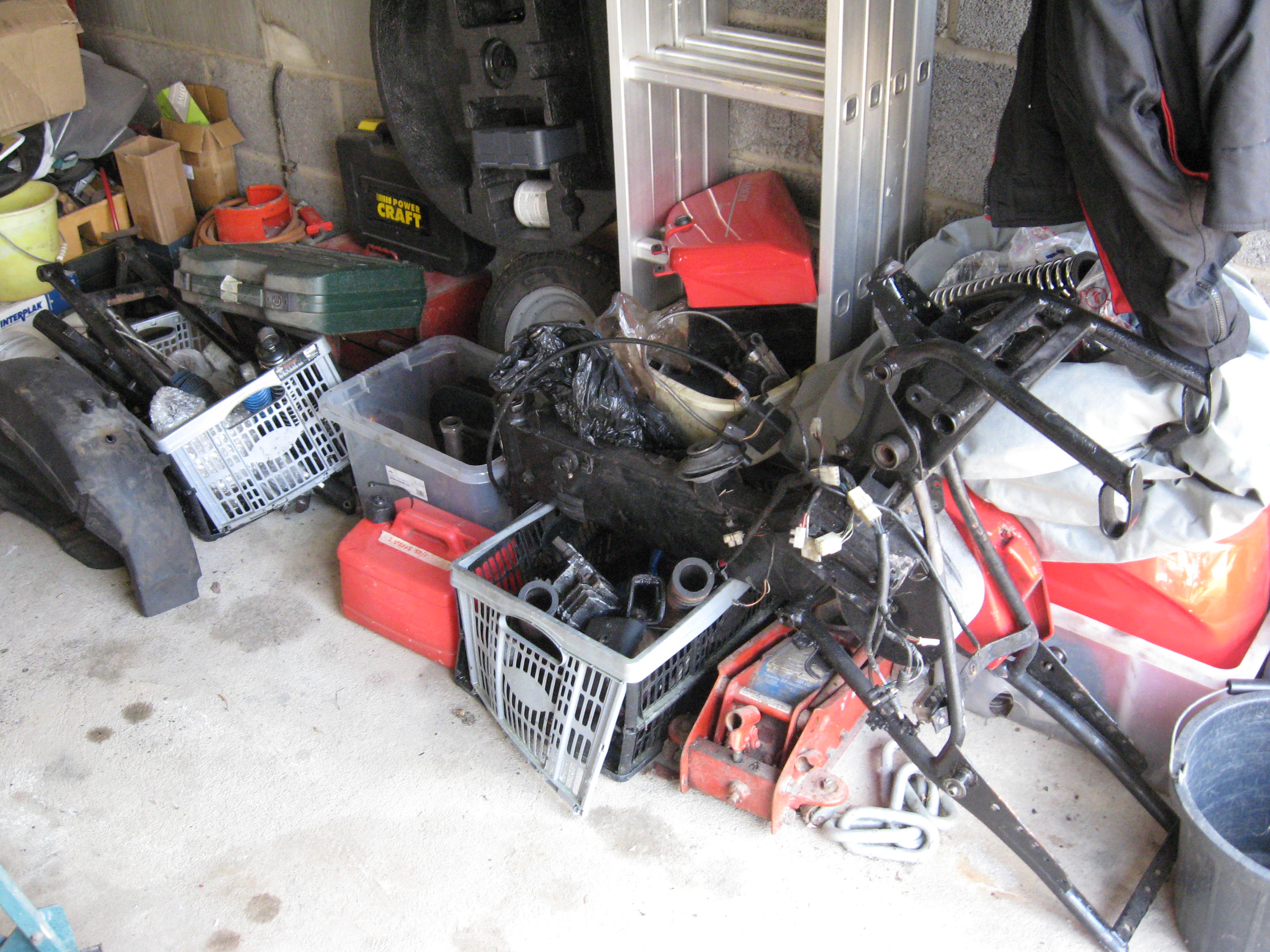

Postby AlanJ » Sun Jul 19, 2020 4:54 am
Not finished yet
This was as I received it.
Hi Guys,
This first pic is as I bought it and the other pics are as is at this time, not finished yet obviously
Sorry if the pics are the wrong way round and I am restricted for room but when complete I will move it outside
for a better view.
Thaks for looking, wish you well Alan.
AlanJ

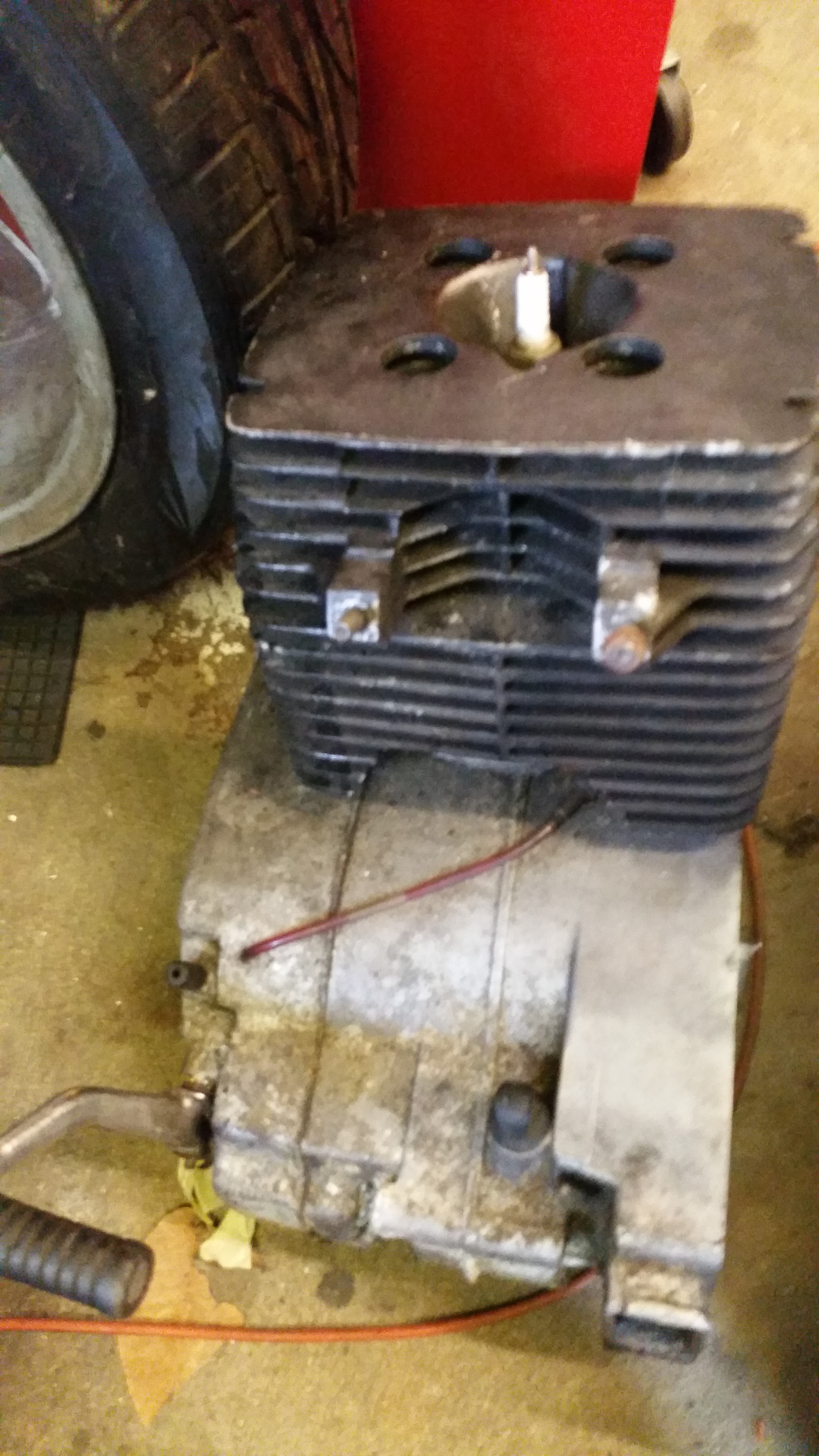

Re: Viral Interlude
Postby AlanJ » Sun Jul 19, 2020 5:42 am
As I received it
Hi Guys,
This pic is of the engine as I received it
AlanJ

Postby Puffs » Mon Jul 20, 2020 4:51 am
Thanks Alan!
Is that a 16" rear wheel? It looks bigger.
I don't know the Saxon and I don't think I've ever seen one in the flesh. I knew they had different mudguards & styling, and centre stand, but other than that I always thought that the 301 was very much the same as the 251, just with a bigger bore. But it also looks like you have different footsteps & pillion footrests.
And then it starts to look very much new...

Postby AlanJ » Mon Jul 20, 2020 8:24 am
Hi Puffs,
Thanks for that, yes, the interesting bit is on the frame you still have the bracketry to take the bar type footrest whereas the Saxon has alloy castings
( using available aluminum ) as MZ did, often, so you have fold back rider footrests, mind you I don't think I would earole the bike at my age, sad really.
