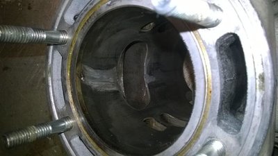

Puffs, Well, at least you now have a clear idea of the cause. The piston on my MZ150 has very sunken pins which makes it tricky to keep the rings located correctly when lowering the barrel. However I assumed that once inside the cylinder they would be adequate to stop the rings turning. So far, so good, but you have given me something else to worry about. As you have said previously, if the worst happens it will not be as expensive a fix as for you!
I believe its the original MZ piston.
dave47
Posts: 182
Re: New TS250 Owner
Postby Puffs » Wed Apr 13, 2022 6:31 am
For completeness the pic of the damage due to the ring failure:
Damage due to ring failure.jpg (19.45 KiB) Viewed 721 times
I removed it earlier, but as I kept on posting about it...

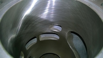

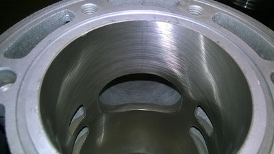

Postby Puffs » Wed May 18, 2022 3:13 am
The barrel has (finally) come back from the plating, and this is what it looks like now:
Regenerated bore.jpg (19.15 KiB) Viewed 721 times
Repaired section.jpg (22.3 KiB) Viewed 721 times
No, that's not a scratch, just some marking from measuring.
And it runs!
