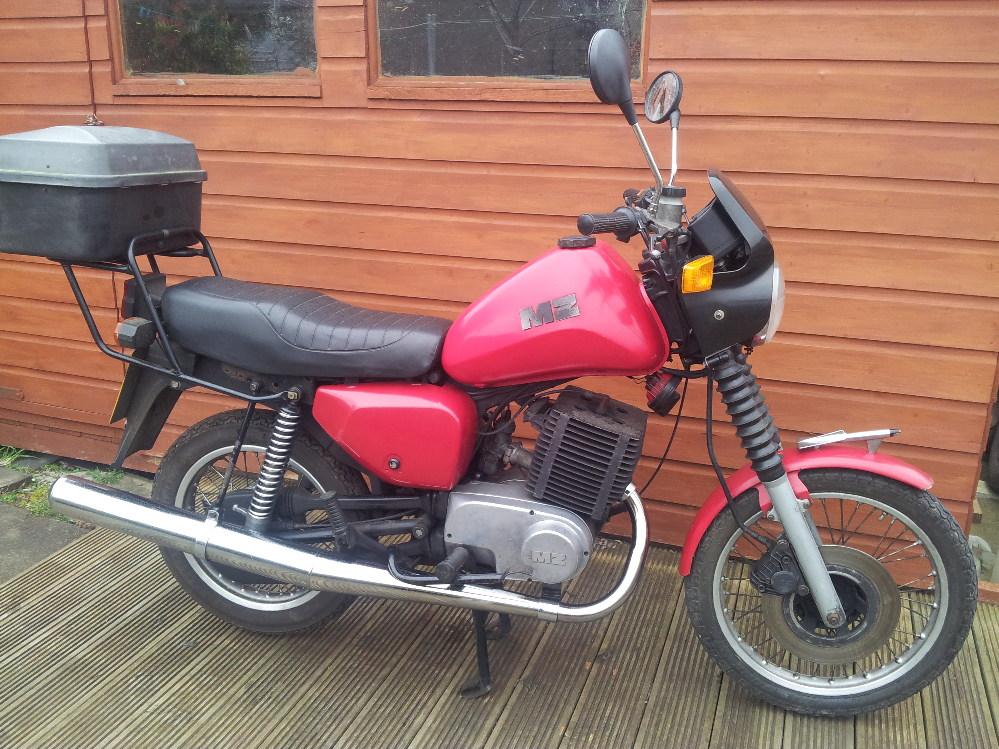

My bike is not a saxon but is in between the earlier ETZ's and the Saxon's.
I have not opened any cases yet but I am keen to find out about the ignition so will open it up soon.
My bike's vin plate says 1991 but was first registered in Oct 1992.
You are correct I think 90-93 seen a lot of changes in the ETZ bikes that is why I am unsure about what my bike should have as standard.
I need to fix a leaking caliper and not sure which model it is, seems there was a change in seal type in 1991 so it could be either..I always seem to be in a model parts change year.

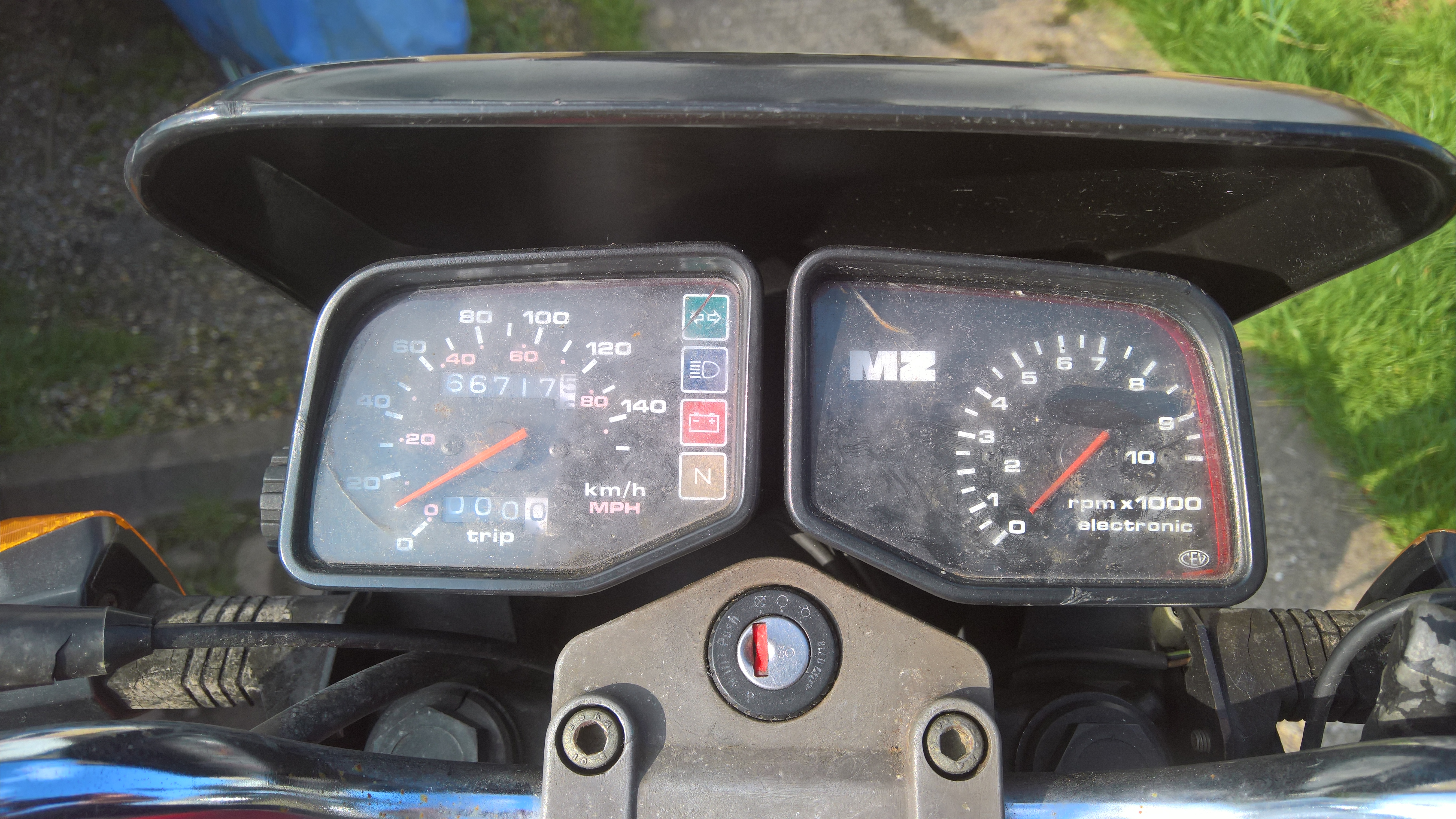

Here is a pic of my bike and the instruments.

Hey Blurredman,
I notice on ebay UK there are a few MZ ETZ's and all have a rack and the same topbox, my bike is the same, this must have been an importers decision.
Strange but true?

Postby Blurredman » Fri Apr 07, 2017 5:05 am
I'm not sure on the top box question as officially there was no rack released for the ETZ250 or 251.. And the racks that you do find on them are modified in some way. Mine actually came from a MZ TS250 and unfortuantely broke in two places straight through!! Very annoying.. I like having a top box to keep my tyre irons, spare tubes, some tools and general stuff in. Grr! That rack is not one i've seen before actually.
From the pictures.. Your bike has definitely been modified!! I like that front mudguard ornament though haha! It's got later clocks, including indicators and ignition barrel.
It also has an aftermarket/new replacement exhaust for a 250. It's quite a bit longer than an original 251 exhaust.. But they perform the same really. I have a replacement one on my 250 they're fine if a bit noisy. I guess it's been crashed or at least dropped because the right hand side foot rest is bent up, which I suppose is also why the exhaust was replaced (not least because the original exhaust chrome on MZ's is quite poor really), because it would have been scratched considerably. The horn is also replacement and the seat has been re-upholstered.

Postby alexxx » Fri Apr 07, 2017 5:47 am
all well spotted, thanks.
Exhaust seems newish and quiet.
I think these clocks/fairing are correct for that year, check out ebay today, you will see a 301same year with the exact same setup

Postby Blurredman » Fri Apr 07, 2017 8:30 am
Can anyone confirm the above? I never saw an official model like yours alexxx.. Esspecially because I am in doubt they would have two styles of indicators.. Early 251's had those indicators on your rear at the front as well. :lol:
Heck, it's easy to do small modifications like that. Open up your generator cover.. I am entruiged as to what electronic ignition it has (if at all)- and how that rev counter is therefore powered.. :)

Postby alexxx » Fri Apr 07, 2017 8:59 am
Hi Blurredman,
All I confirm at the moment is that the rev counter is electronic, no cable drive from the engine to it.

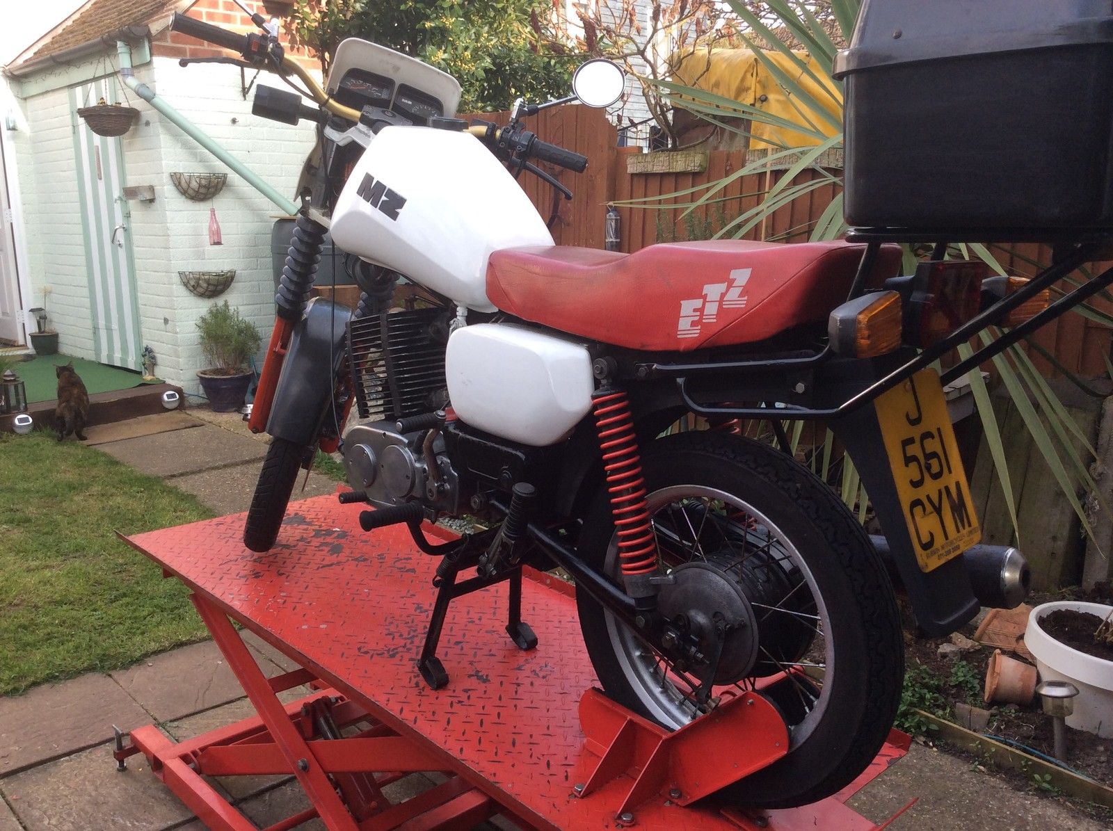

Have a look at this bike pic that is on ebay today, it is am MZ ETZ 301 1992..looks exactly the same as my bike (apart from rear indicators which on my bike must be from an older model, the ebay one will be correct I think) that is why I think it may be standard?

Postby Blurredman » Fri Apr 07, 2017 9:05 am
Interesting point. I forgot about that varient. I didn't realise they were as early as it is apparent. 8)

Postby alexxx » Fri Apr 07, 2017 9:27 am
looks like it is a model between the older ETZ's and the later Saxons, maybe from 1991-1992?
Even has a rack and topbox! the topbox looks exactly like mine (Rickman)
Wish we had some factory model history for these later bikes from 1990 onwards.
Hey..I may have a super rare model ! :D

Postby Skorpion » Fri Apr 07, 2017 10:53 am
Hi alexxx.
It looks to me like your bike is a later version of the original ETZ251 model, the only thing different is that you should have black painted engine side cases, though these could have been replaced/polished.
Your front brake, master cylinder, caliper, brake disc, is the same as earlier 125/250 models from about 1983-4, parts for the master cylinder are I think getting rare. Update. it's the complete master cylinder thats rare/ unobtainable in the UK, repair parts are ok.
If your rev counter is electronic then you have electronic ignition.
