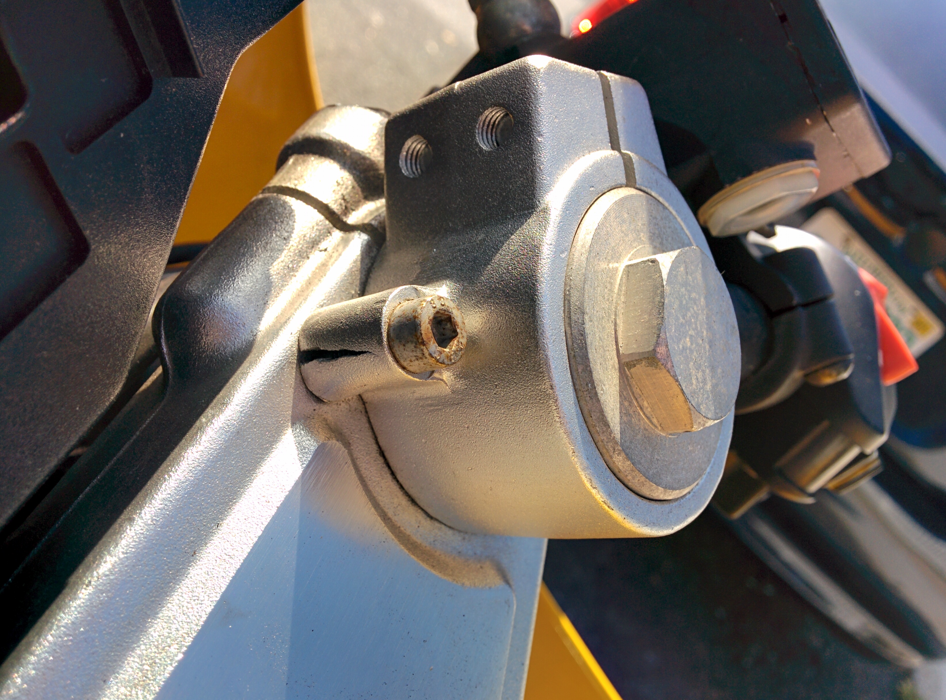

My Sport got knocked over HARD by a car and a part that is connected to the right handlebar is cracked. Bent the brake lever as well. But luckily nothing else is damaged.
Attached is a photo. Does anyone have this part to sell? Thanks.

Just get it welded up and redrilled.

MZ in Oz wrote:Just get it welded up and redrilled.
Or just remove that little bolt and use the two clamping bolts to hold it to the fork . That little bolt is mostly for positioning. During the off season do what MZ in OZ recommended.
