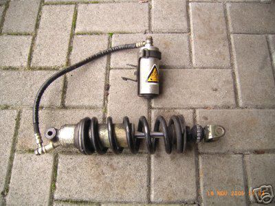

here is a young man in Germany selling a WhitePower adjustable strut that fits the Skorpion:
http://forum.monoconnection.nl/viewtopic.php?t=1013
I have the same one at the moment in my Tour and it works well right out of the box.
